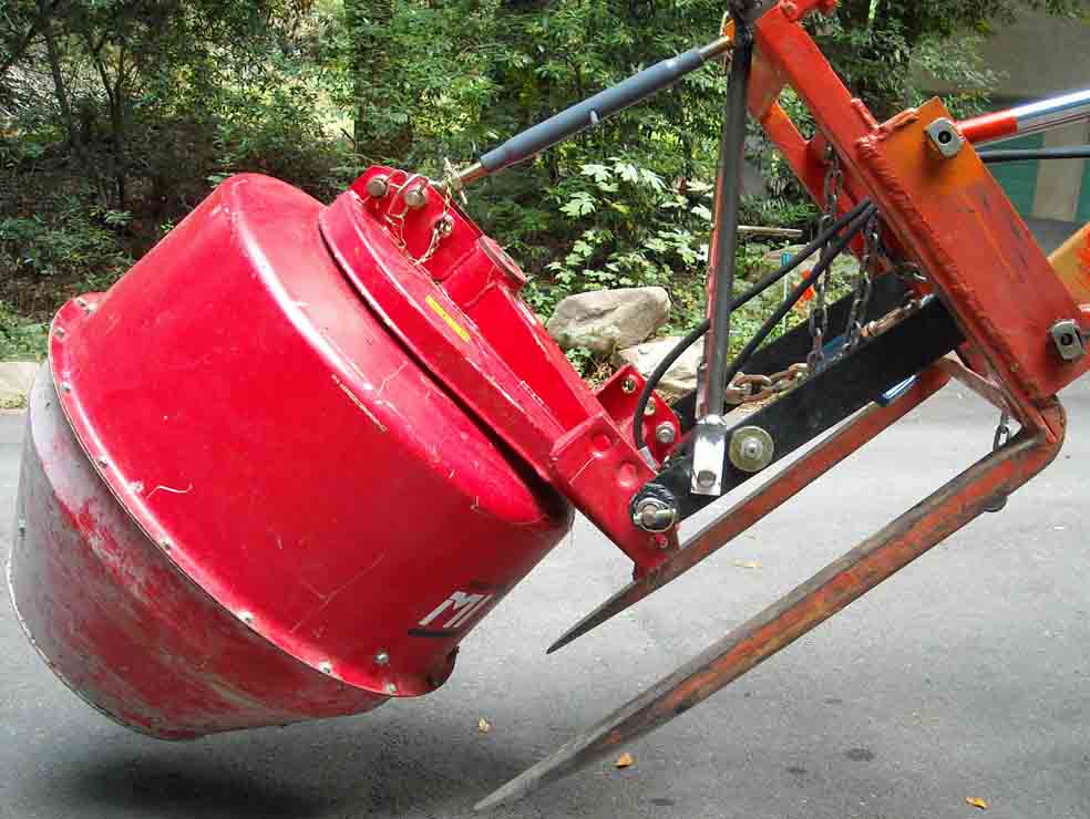

Maybe one that is slightly smaller would be better. I see a 5 cubic ft one (27 cubic feet in cubic yard) that would not be as heavy. Or make sure you don't put more in than what your tractor can handle.
5 cubic ft of concrete can weigh over 600lbs, plus several hundred for the mixer, you can get over 800lbs pretty fast. When it is dumping, the weight moves away from the tractor (before it falls out of the mixer).
Looks like they use hydraulic top link to dump, so you will need remotes or borrow a loader circuit...
Good luck
   / pto cement mixer #13
With a FEL adding front ballast, you don't have to worry about the front coming off the ground. Ken Sweet

I have sold several for the BX 22 series. No problems reported. Ken Sweet
Concrete weighs 3600 lbs. per cubic yard, so your mixer plus concrete would weigh in at around 1600 or 1700 lbs., which approaches the weight of some small tractors. I think someone mentioned putting rocks in the front loader, which would be a real good idea for any small tractor. Anyone can check the specs on their tractor for weight and 3-point capacity. Almost any 3-point would handle the weight, but a small tractor may end up with its wheels in the air. :laughing:

We have the new 1/3 yard capacity for $799 + modest shipping.
That's the one I have had for many years. My concern is that the BX
is not tall enough for proper dumping.

Does your mixer have the series of holes for the lift arm pins to go in for different lift heights? Ken Sweet
