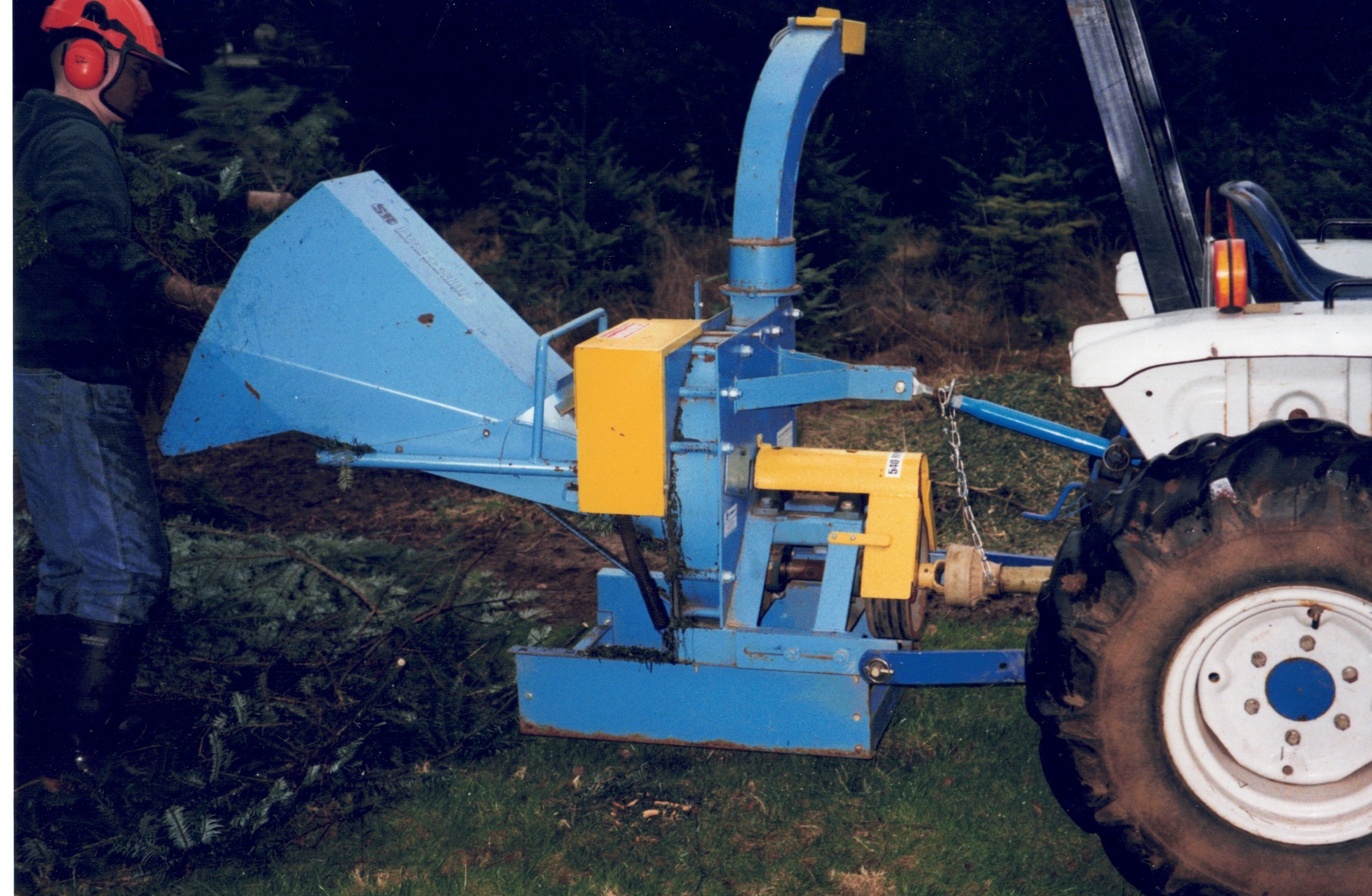

I've had this S&R ProChip since about 1997 when I bought it used.
Based on my experience with this (and 8 hp Bearcat before this), a chipper should have a feeder instead of relying on so-called automatic feed.
The trouble with the "auto" feed is it does not work so well if the knives are not in top sharp condition!
The only downside with the feeder is the added cost, but it will more than pay for itself in the long run.
My two cents.
Here's photos on my sons running the chipper during summer 2000 when they were still teenagers:
