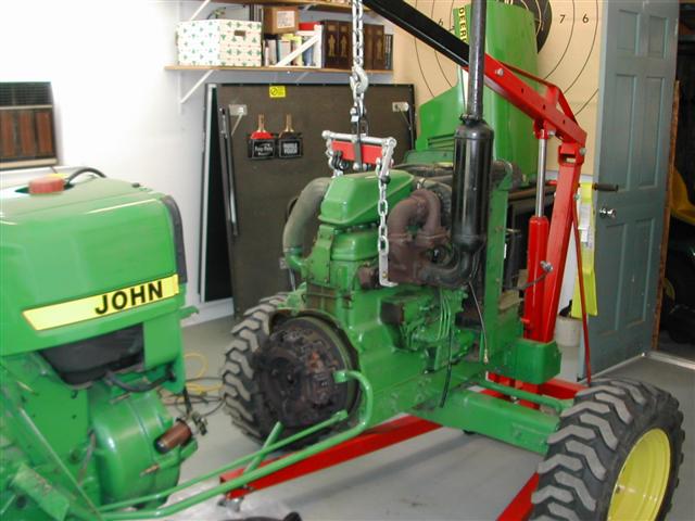

I wish I could have adjusted the clutch on my JD 1050 through the inspection plate. My PTO clutch was not releasing, and I fixed it this morning. Here's a pic of the "pre" split set up.

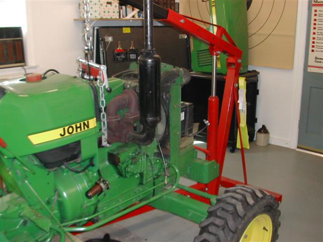

Pulled apart!

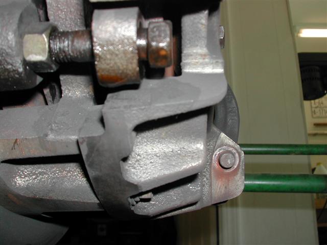

A better shot of the clutch. Mine has three adjustment bolts too.

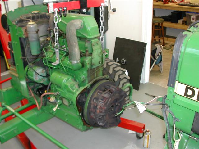

This is one of the three bolts that is supposed to have .060" gap. Mine was more like a 1/4 "! After adjusting and putting the tractor back together it worked great! I was a little nervous. It was my first attempt at a heavy repair on the tractor. I pulled it apart and put it back together in 3 1/2 hours today. It was not nearly as bad as I thought it might be. I hooked up the mower, took it for a "spin" and it worked perfectly /forums/images/graemlins/smile.gif A really good start to the weekend!

Scott, there was an inspection plate, but...... It was just large enough to put one wrench on the head of the adjusting bolt. I couldn't even see the lock nut on the other end of it, much less get two wrenches in there. My better judgement prevailed, and I did not get out my hole saw while looking for a large rubber plug /forums/images/graemlins/smile.gif I'm sure sooner or later, someone will say "hey, why did you pull it apart? All you had to do was ...(yada, yada, yada). But, the job wasn't bad at all. And, I got a good look at both clutch plates and disc. They looked they were in great shape.
