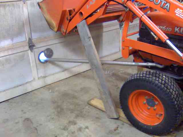

Here's my take. I don't worry a bit about putting hours on the tractor, that's what it's for. If I can wear this tractor out in my lifetime I'll be pretty proud of myself.
I am set up so I can run the tractor in the shop, exhaust out the door so heat from the engine heats the shop, power goes to the house, pumps, whatever via the cable that normally feeds the shop from the house.
If I need the tractor to move snow or tree limbs, the house is okay for a few hours without power, even in the dead of winter, which is plenty cold here.
