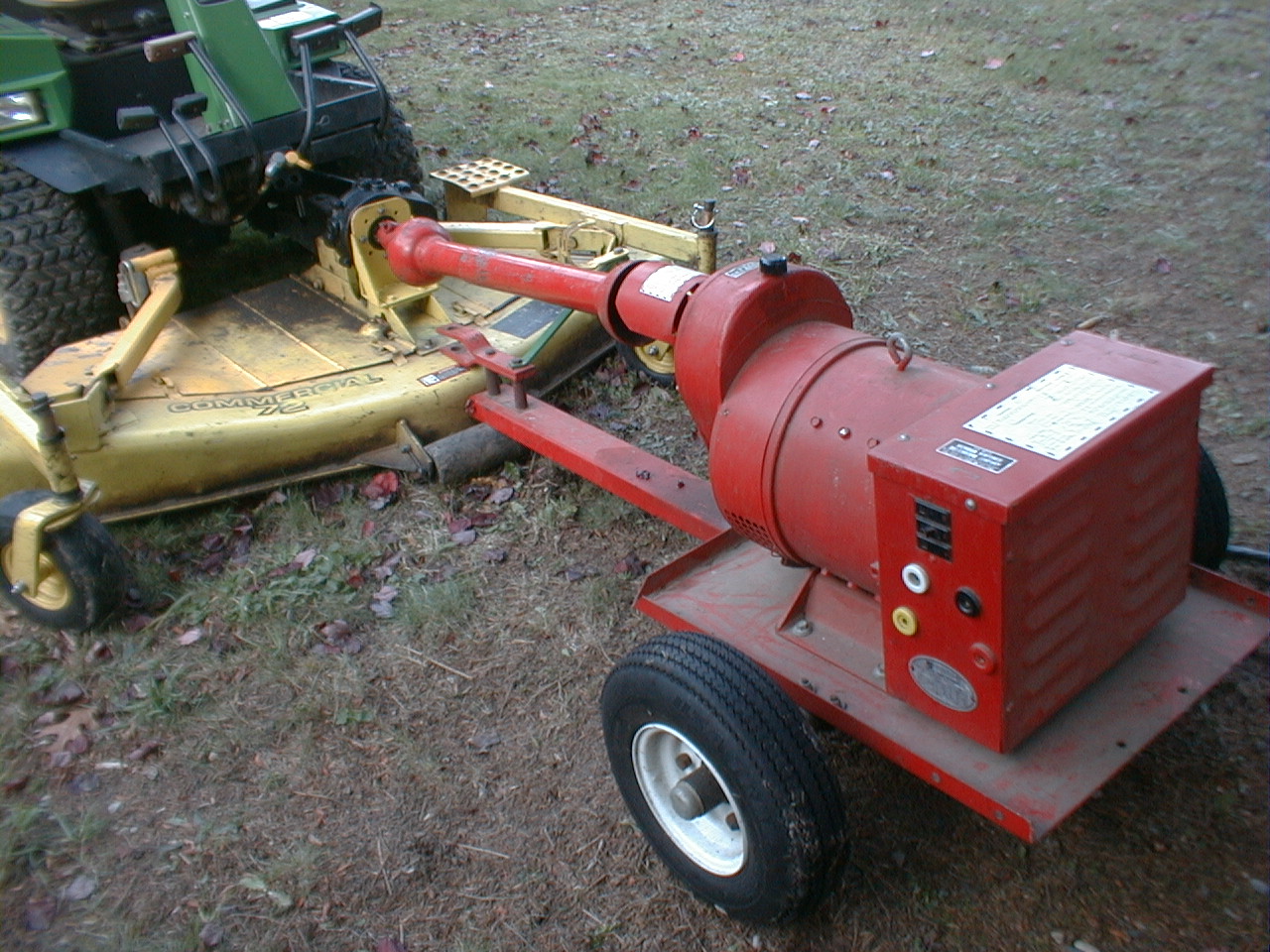

Thanks for all of the comments. Looks like I should have been more specific in my original thread. Tractor is Yanmar 1700D and generator is a ST-10. I don't figure on getting max output from the generator based on the Yanmar 1700D's rated horsepower.
After looking at the possibility of using belts to go from 540 rpm to 1800 rpm I ordered the gearcase from the manufacturer. Should be here tomorrow. Will try to post some pictures when everything is hooked up. This setup will be used for auxilary backup to our home and will be parked in a detached garage. Hopefully this will serve as a "safe,clean environment" and I won't have radiator problems as long as it's clean before. The Yanmar doesn't have a water pump so Should I add a cooling fan? The auxiliary power connects to a transfer switch.
