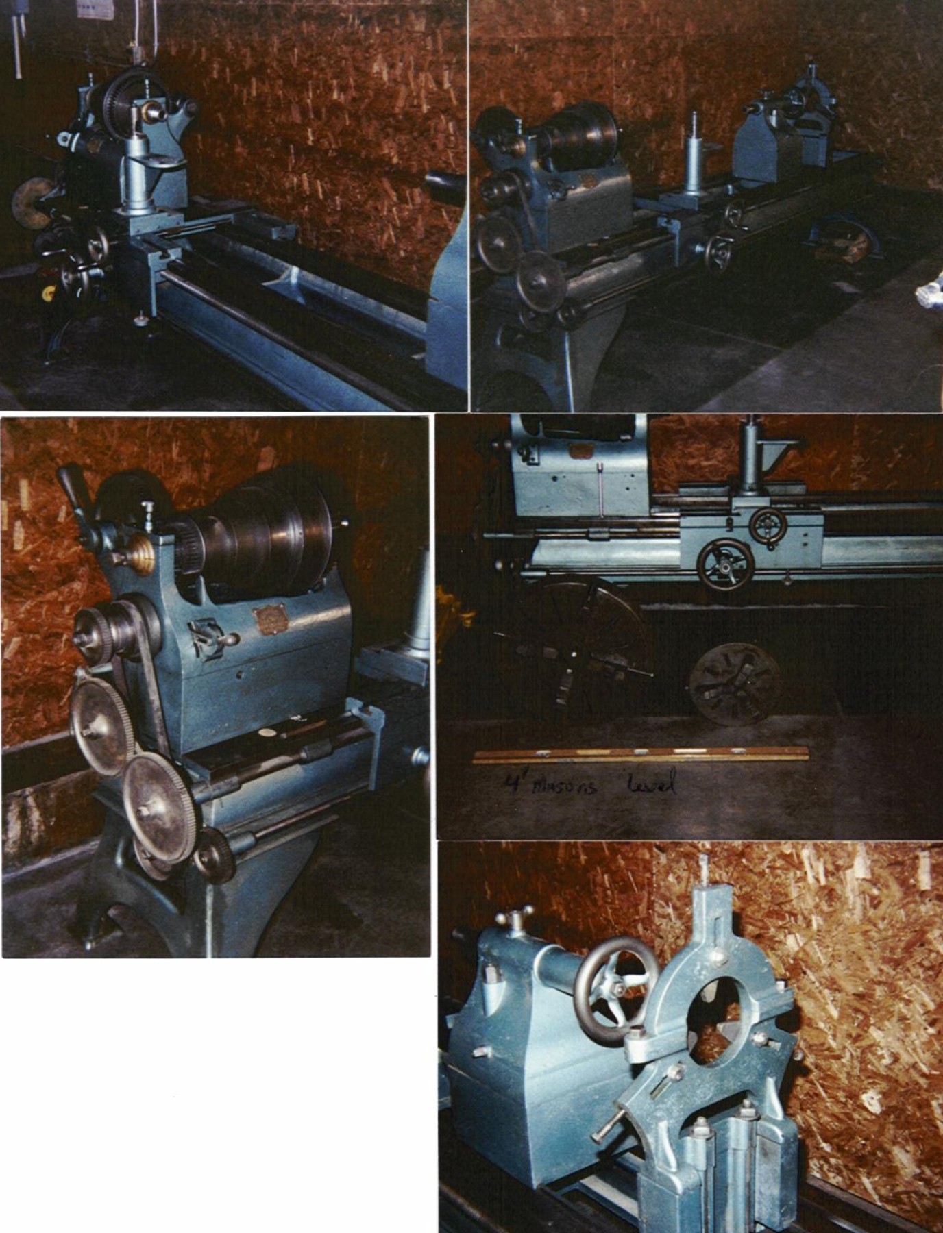

   / pto driven LARGE wood lathe #20
also do not over look old metal lathes, I think I only payed a few hundred for the old 24" by 7 foot bed lath I have,
I know it is a dark picture, but one can kinda get an idea, and will work for wood if one wants, to, one may need to make a tool rest if one wanted to do a lot I just clamp a bar in the tool holder and even used the tools for metal work to turn some with it,
one time even set it up one time with the router to make flutes in the columns
