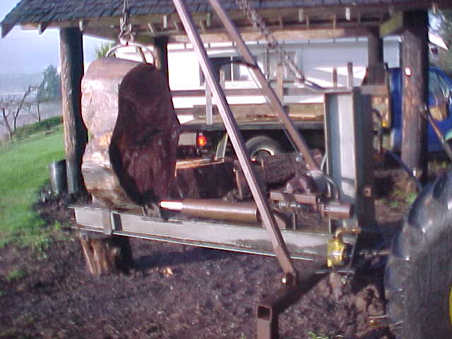

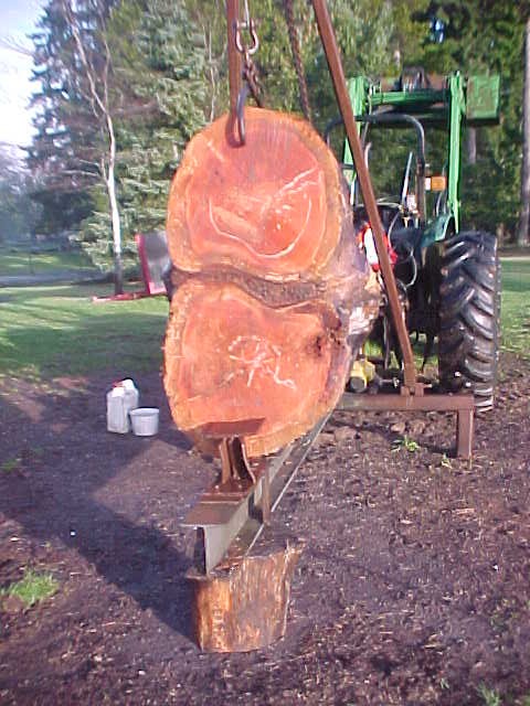

This is my idea of a pto driven log splitter. No picking of blocks. As you can see the knife just splits two pieces off the bottom as you eat the rounds up. It will handle up to a 6' dia block. I have it hooked to a 50hp JD, but I like to run the pto with a 20hp Kubota and use the high gear in the pto.
