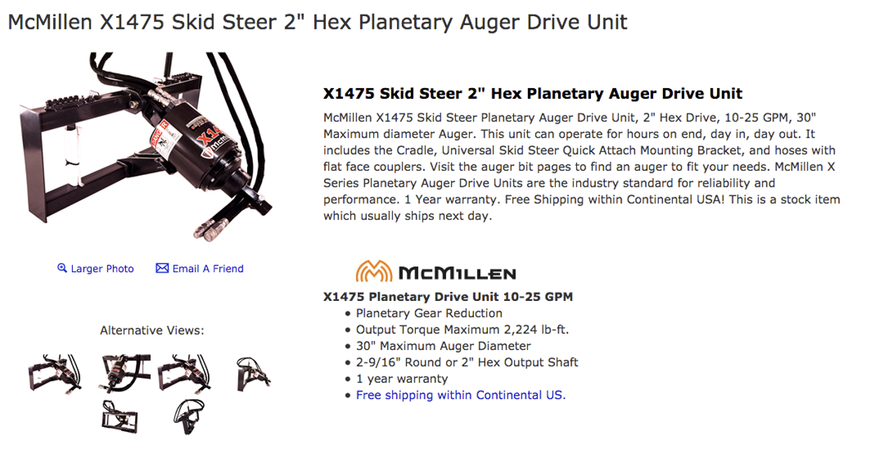

3PH post hole digger has limitations when compared to FEL mounted hydraulic auger. 3PH rotate only one direction so unable to reverse and back auger out of hole like hydraulic can when binding up on clay, rocks, or roots.
FEL mounted auger can exert massive amounts of down pressure whereas the 3PH relies only on the screw tip to pull auger in.
There are lots of threads here where the FEL vs 3PH auger has been beat to death and you will find many of them include the problem with getting the 3PH stuck in hole and then having to detach the auger and then either twist it out with long pipe wrench or dig it out with shovel.
Safety while using FEL auger vs 3PH auger is another significant benefit. The sight path while lining up to drill and drilling with FEL is much better than 3PH.
I have been very happy with the following auger and run everything up to a 30" dia auger and 36" Tree planting auger using the M59 tractor.
Once you have the 3rd function on the FEL you will find it very useful for other SSQA attachments

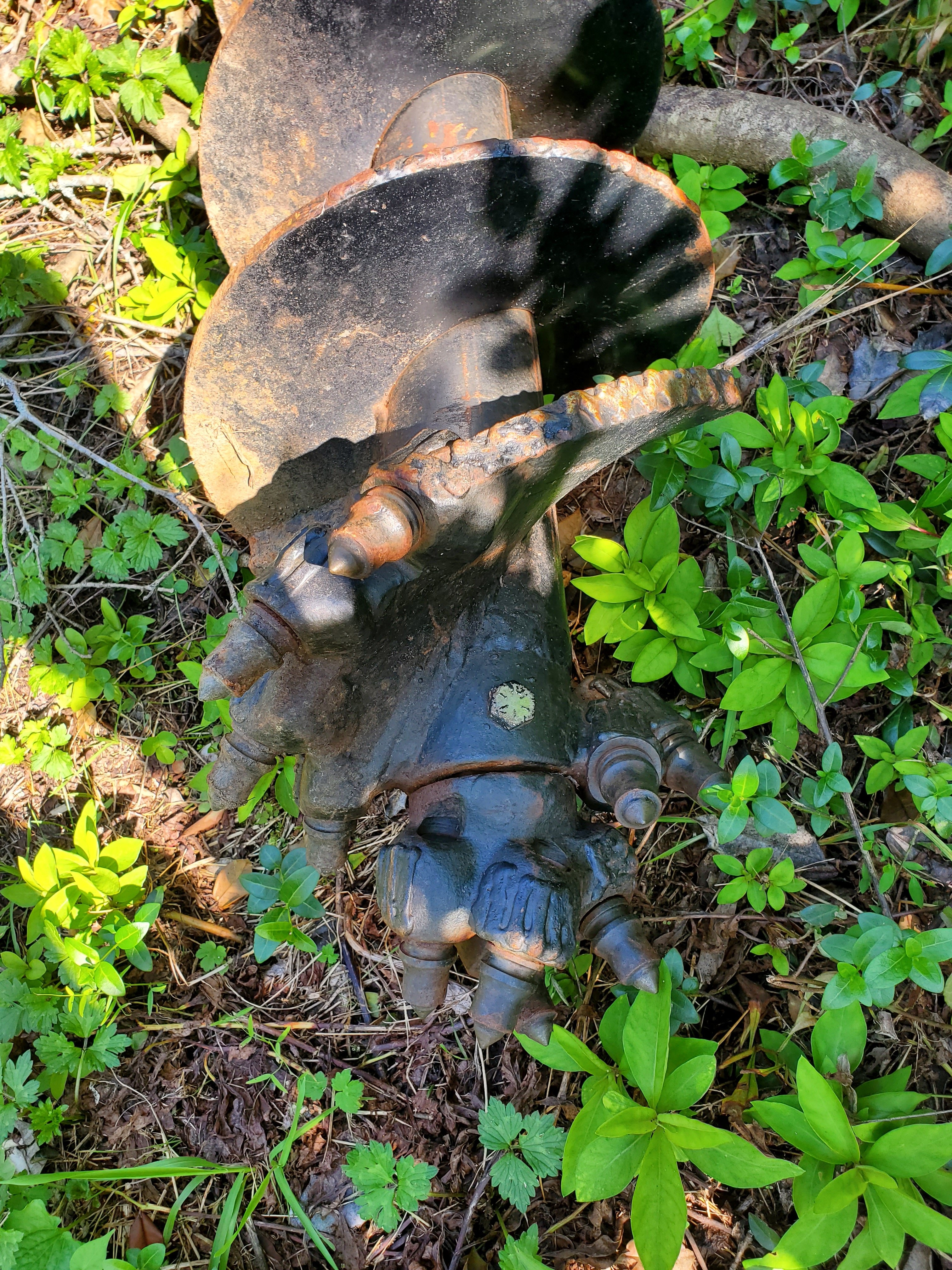

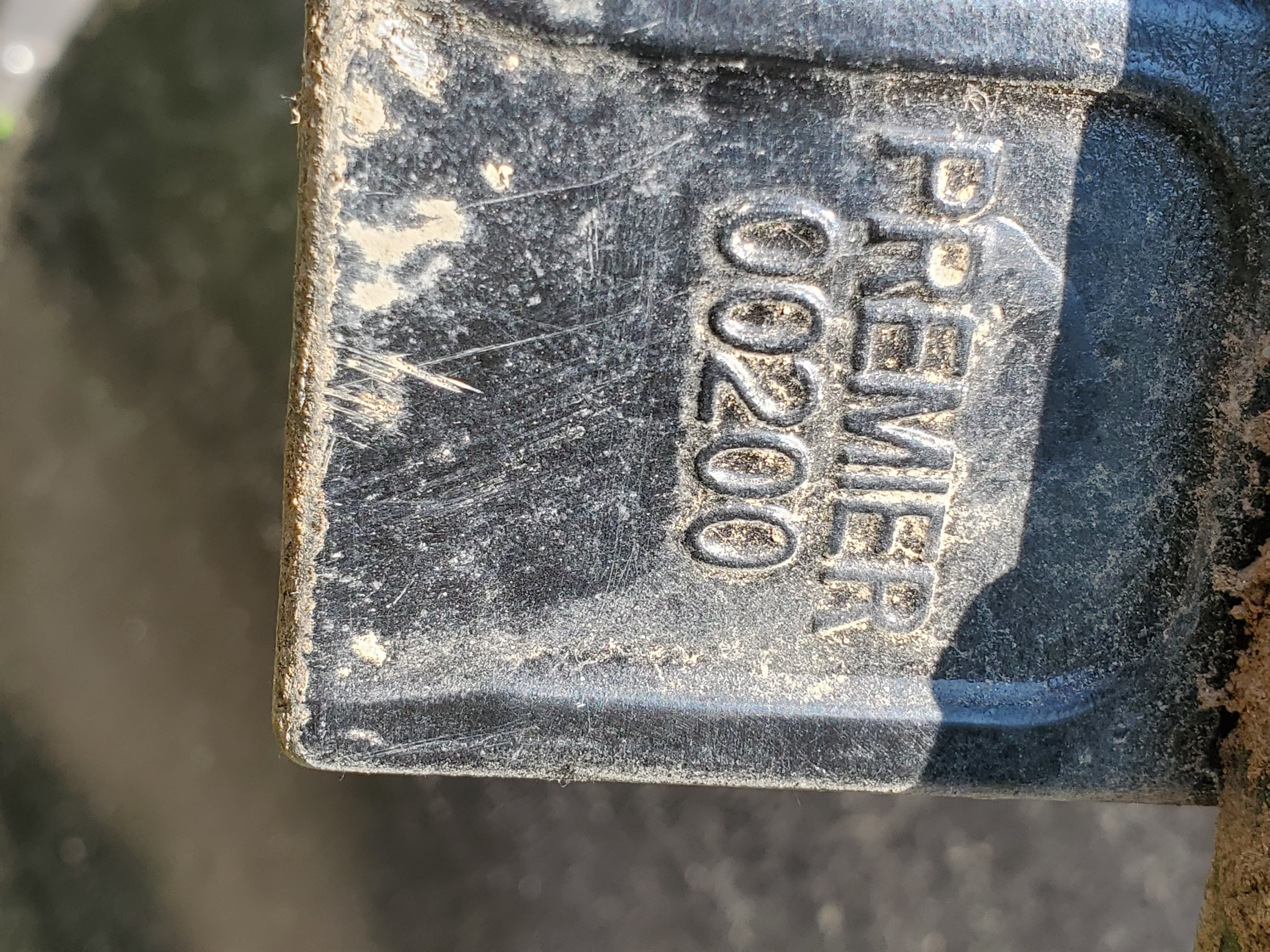

I have a TSC countyline, but purchased at auction. I cant remember who actually makes it for TSC, but I suspect the gearbox on mine was made in Italy. The price at TSC when on sale would have been a better deal than what I paid at auction plus the time hunting the correct seal.
I dont know where the current versions are made.
If you have a bunch of rocks in your soil, be prepared for some exhausting work with a rock bar. I dont know if a hydraulic unit would be easier in rocks because I have never used one. Being able to reverse would be an advantage over a 3pt phd.
