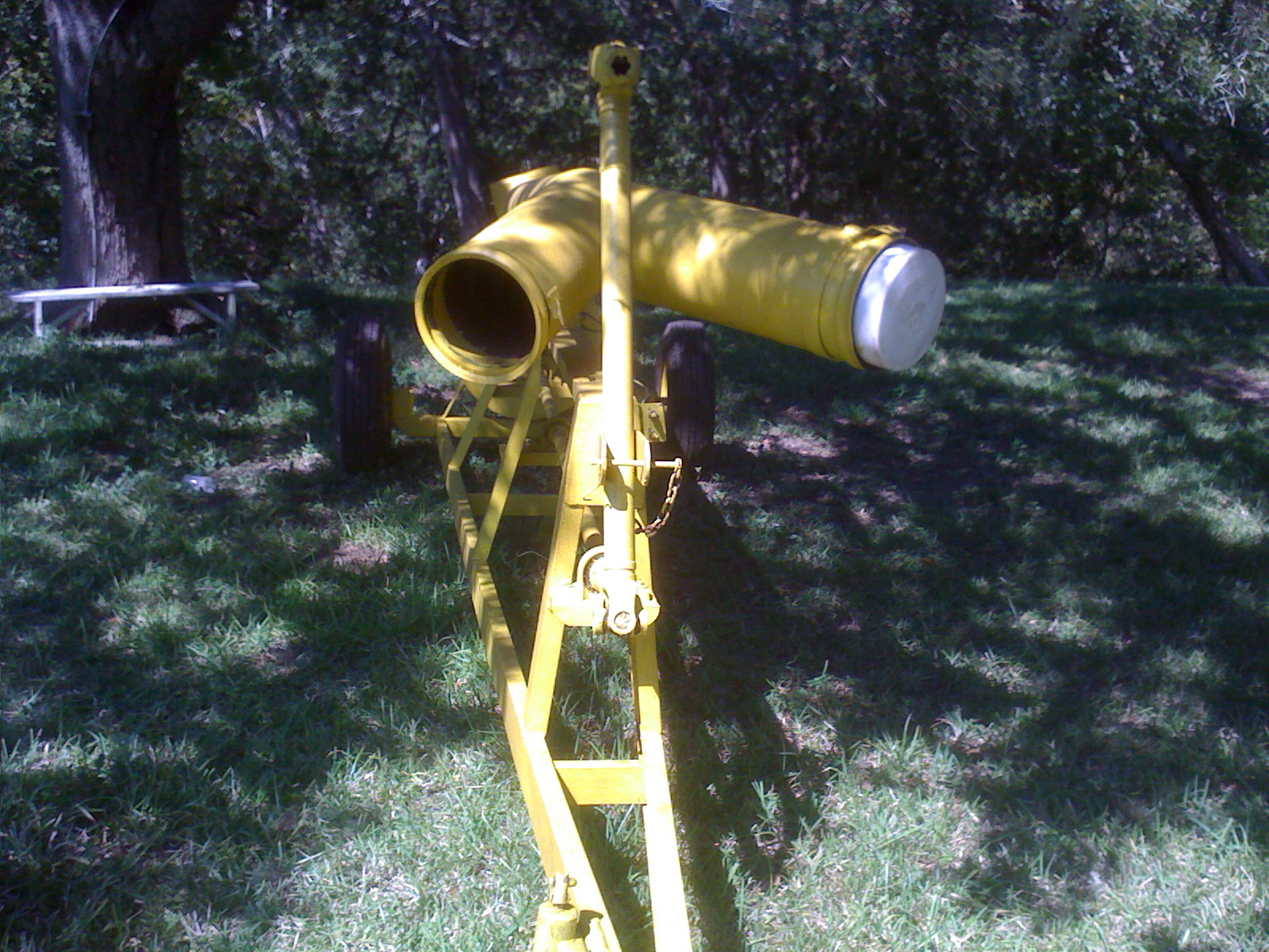

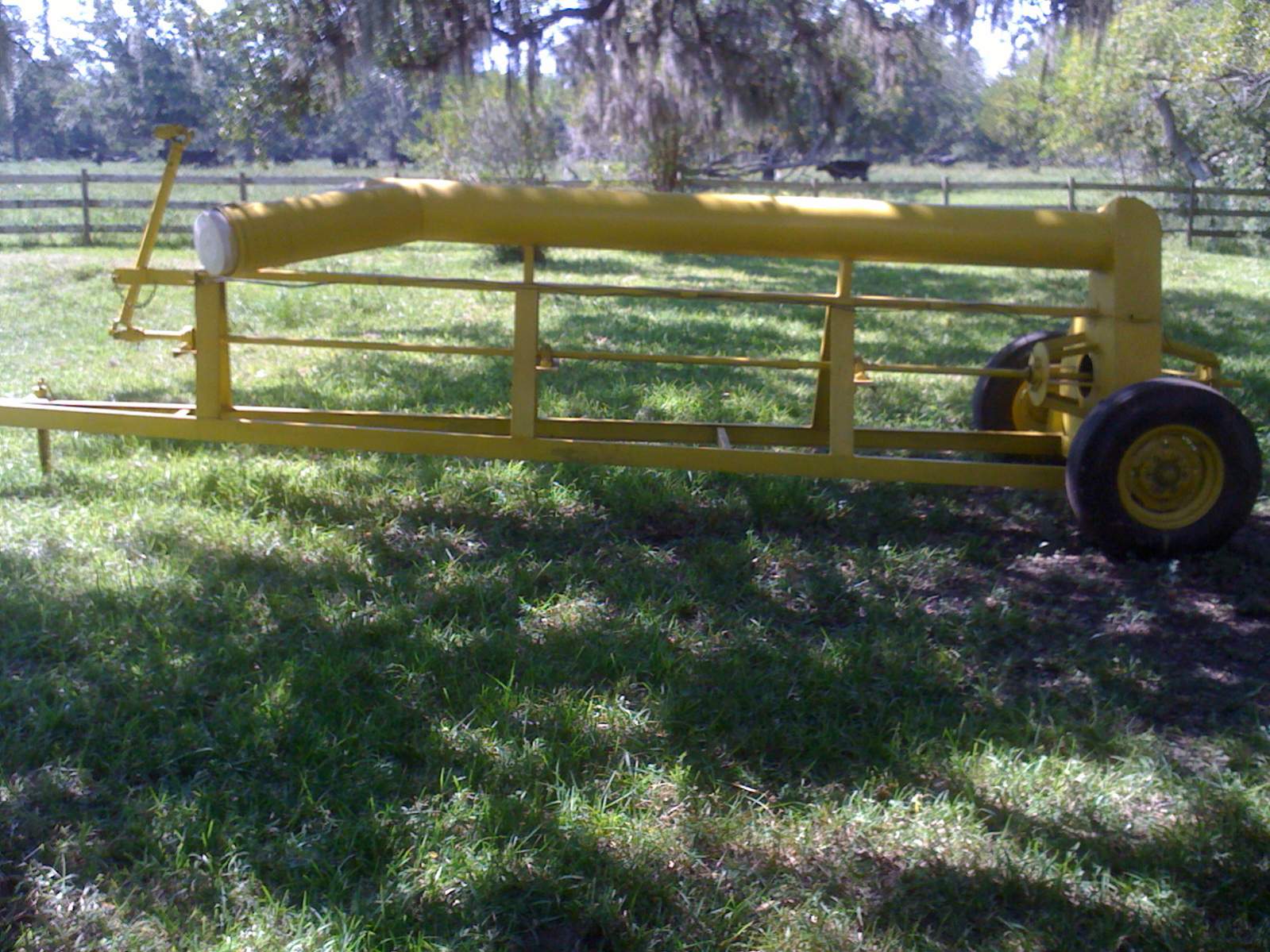

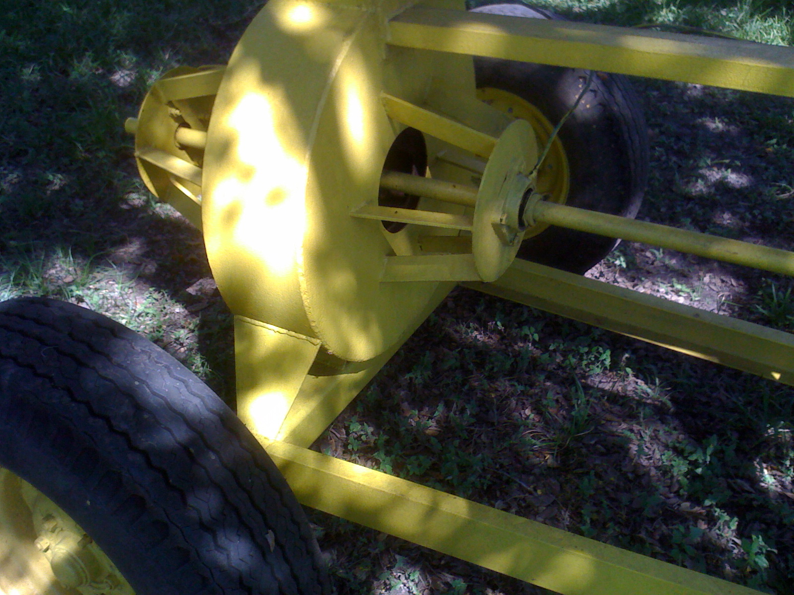

I have a trailer mounted pto pump, this thing will pump ALOT of gallons

/ PTO driven water pump #6
trailer mounted pump like ItsAdams1, come in multi lengths any were from 6 feet to 80 feet. ya just back it in. turn the PTO on. and let it start pumping.
they also have other style of pumps. (diaphragm, roller, piston) water pumps. that just slide over the PTO shaft. and use a chain from pump to some place else on 3pt hitch to keep the pump from twisting. and 2 hoses (1 inlet, 1 outlet) some are geared for fertilizer mixes, and dry powder mixes of fertilizers as well.
they also have trash pumps. or rather pumps able to handle solids say any were from 1/4" to 3" in size pending on pump. without clogging and/or damaging the pump.
all above are PTO pumps. there are some smaller size 12v water pumps for on demand spot sprayers.
there are many types of pumps it greatly depends on what you are wanting to do. of what might work better for certain jobs.
pumping water from pond is only part of the story. what will the water be used for?
are you pumping water into tank or a fertilizer tank?
are you watering live stock?
are you trying to aerate the pond?
are you trying to drain the pond?
will it be backup for say firefighters to refill there trucks?
are you wanting to say water a garden with pond water?
or perhaps wash vehicles and tractors and implements with pond water?
did a large post of pumps for dredging a pond out. that may also help ya, figure out what you want out of a PTO pump for a pond.
enlarging pond and deeping it.
