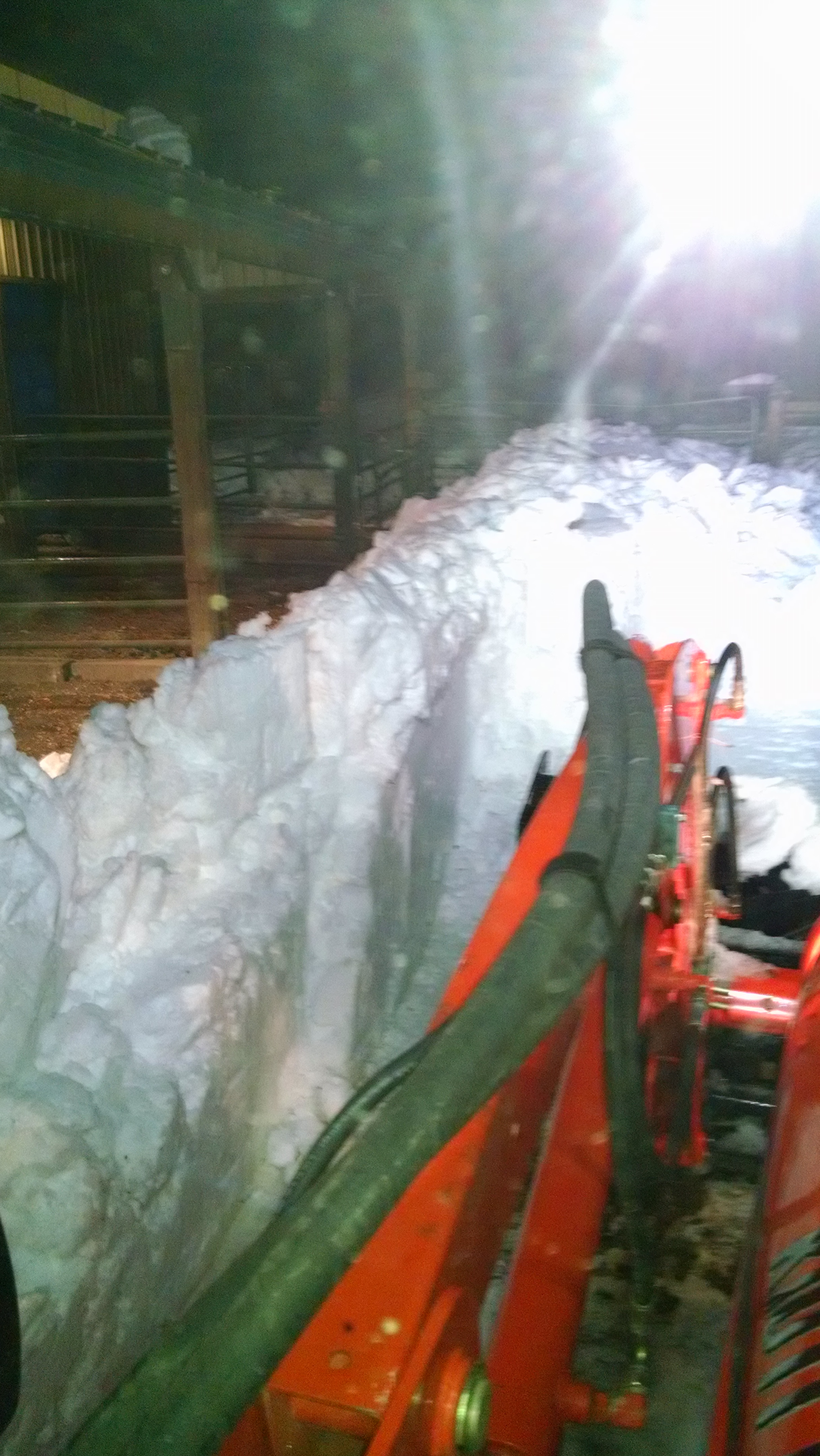

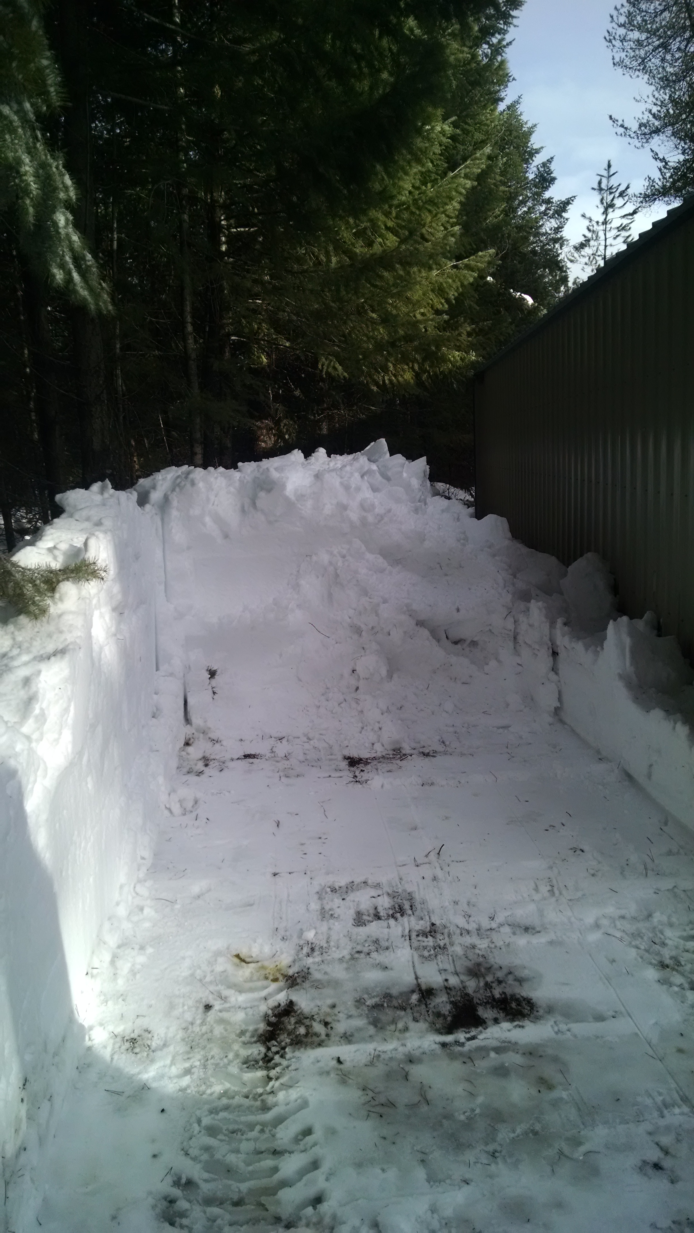

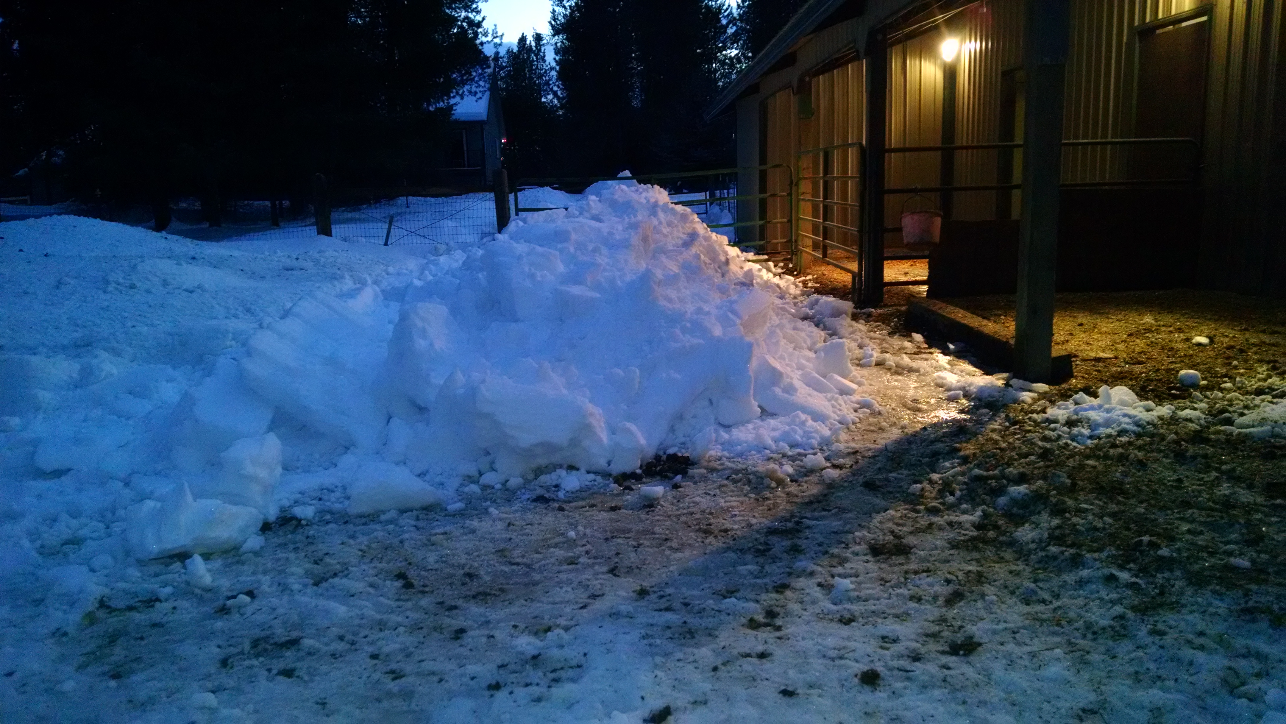

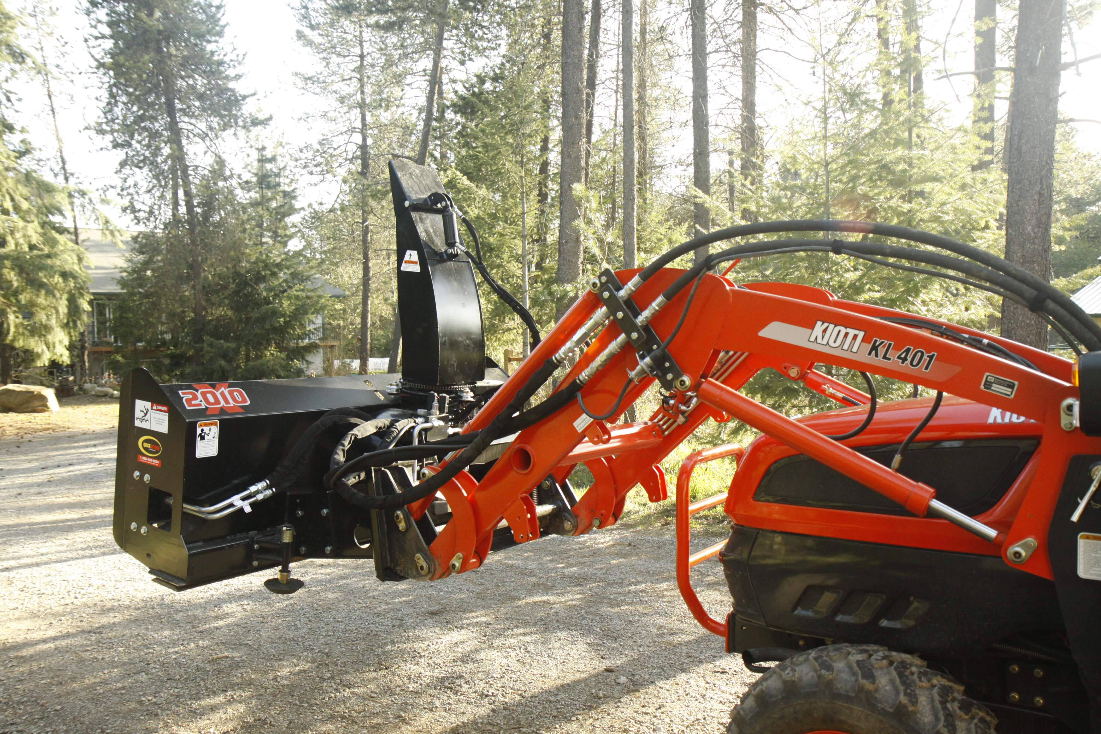

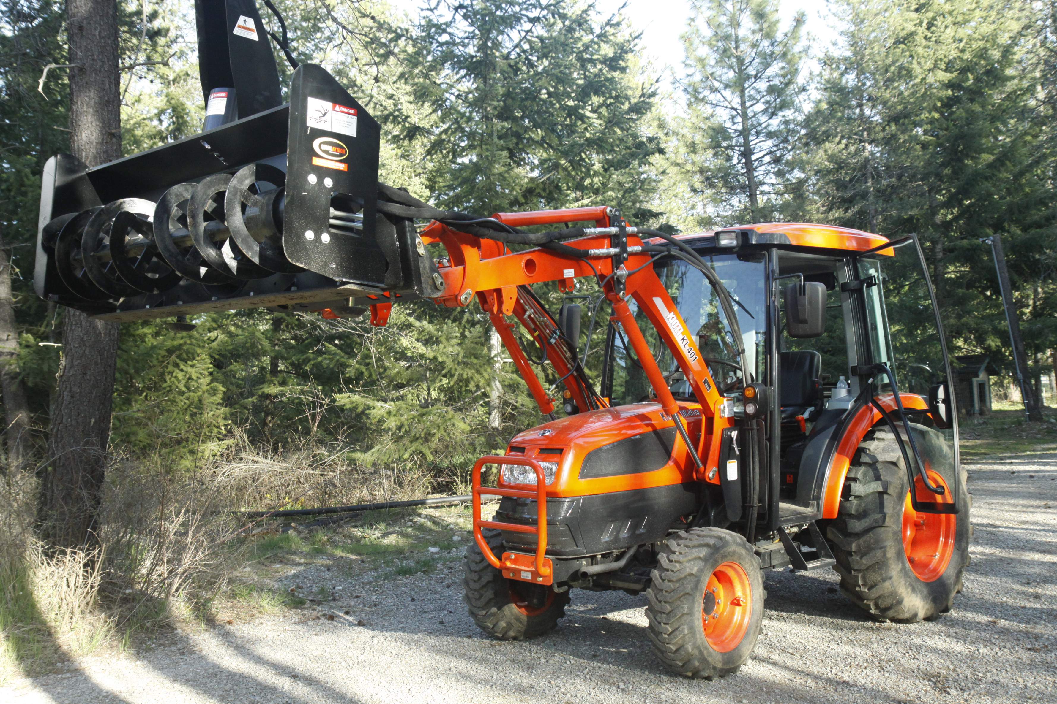

Thats just it. Numbers are numbers. I move lots of wet snow with my unit, but mines hydrostat transmission. I dont bog it down as i simply let off the peddle if needed. The reasion i dont have a tow behind unit is the 6 foot berms of snow i clear on my horse barns and sheds. I can lift my blower 7 feet in the air if needed to clear berms.
