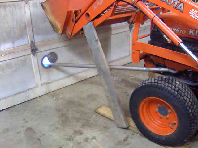

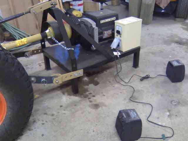

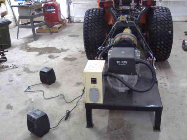

I was improving my generator setup and took some photos with my phone.
The plan is to feed the house from the shop and use the engine heat from the tractor to heat the shop while supplying the house and shop with electricity. Also shows the 3 pt platform my generator came on.
See if this works.
The two heaters were just to provide a bit of load. I also wanted to see how the tractor managed lighter loads at the higher PTO setting. It didn't like it, too slow an engine RPM at 60 Hz and the operator off seat flip up doesn't work at that PTO setting, only at 540 RPM. I didn't know that before.

Glad to see that you are venting to the outside. How far does the exhaust extend out the door? 6" er 2'
   / PTO Generator 3 point mount?? #18
That is a 10 foot length of exhaust tube so extends well past the door. Interesting exhaust sound when outside with the doors closed so all you hear is the exhaust. Earmuffs are required when inside with the tractor running at PTO RPM.
I'm going to make up a short cheater cord so I can easily plug in a 4800 watt construction heater as well as the arc welder. I think it will be able to run the welder for lighter welds.
