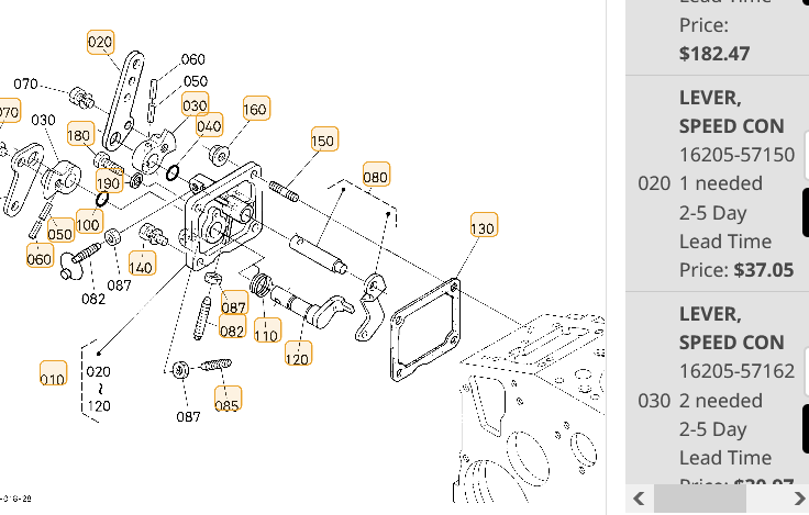

The governor mechanism on a B2601
   / PTO Generator arrived today #156
   / PTO Generator arrived today #157
CalG, Thanks for taking the time to post these diagrams. I also called Vahrenburg (sp?) MF dealer in Missouri and they confirmed that with a GC1720, there is a governor that will maintain the engine RPM within reasonable limit as the generator load changes.

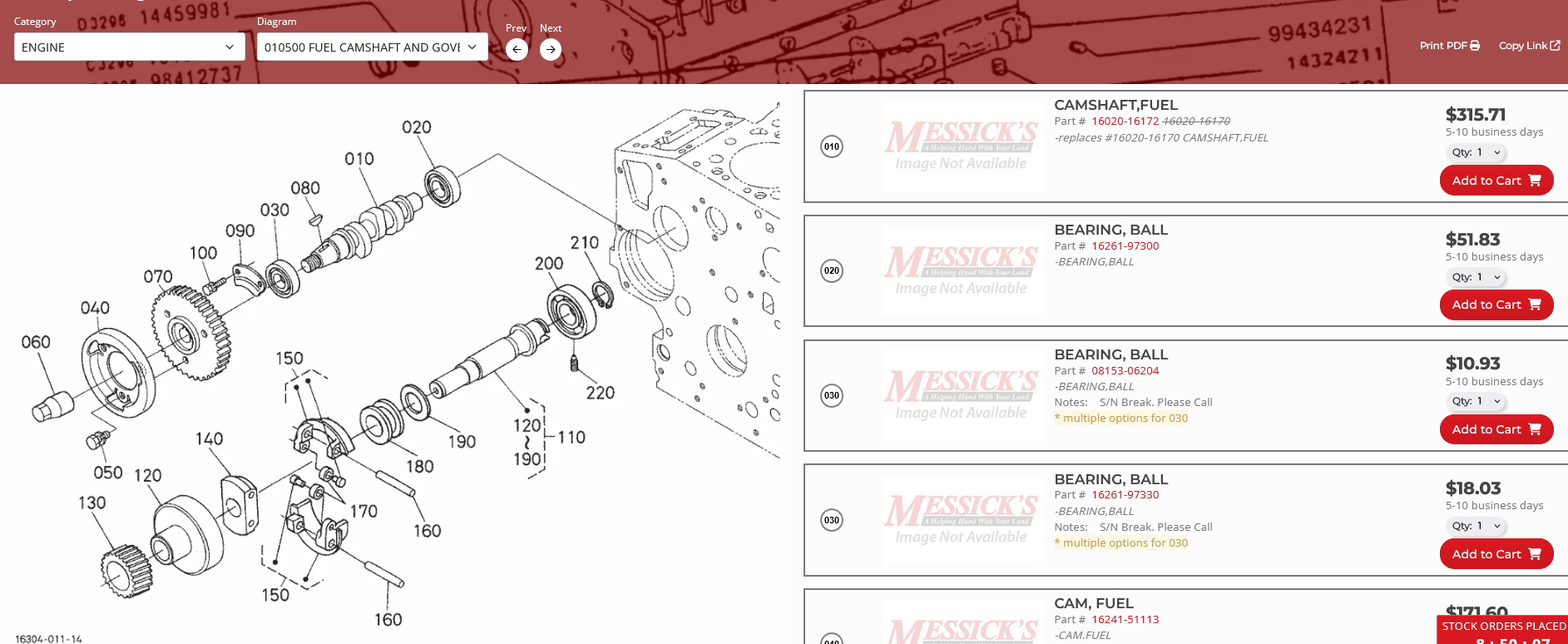

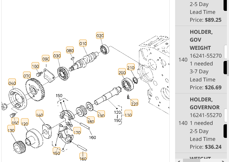

Back to the mechanically injected engines, some, like my Branson, have the governor built in the injection pump, others like most <25HP Kubota, Yanmar, Iseki, etc engines have the governor on the timing gear that drives the camshaft for the injection pump.
I can't find a parts catalog for the GC1720, otherwise I would've happily put a page of it here, showing the governor.
I'll share a picture from a random Kubota model instead. I believe it's a B2620. #150 are the weights of the governor. There is another page showing all the linkages and what not.
