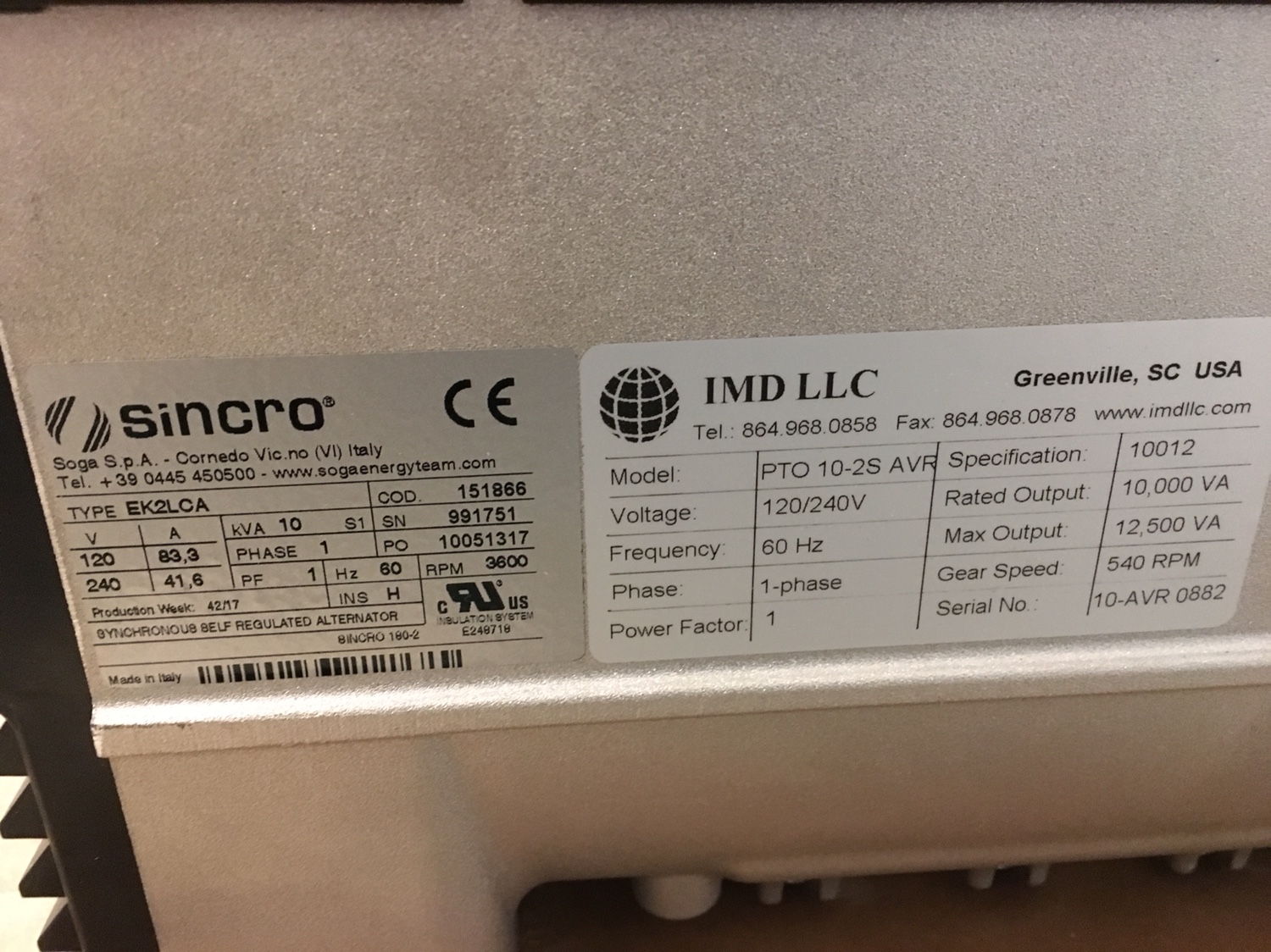

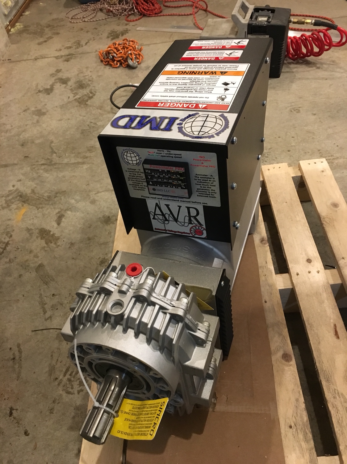

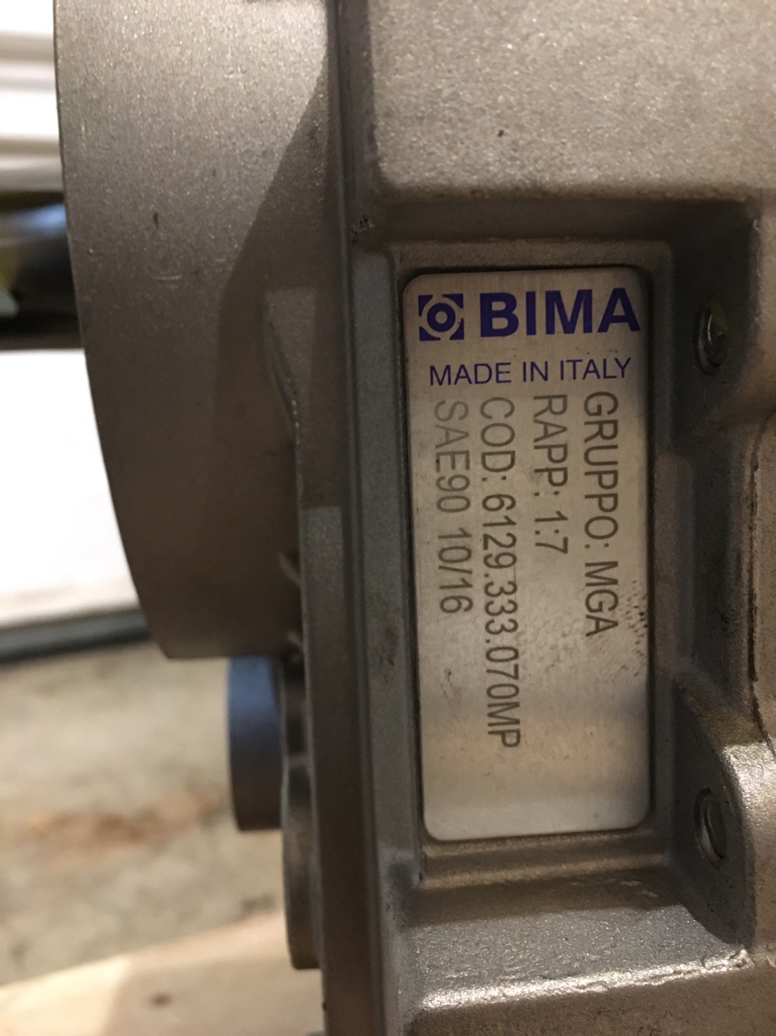

I won稚 get it setup until later this month. Planning on mounting it in a hitch plate and it will mount on my 3 point hitch receiver. I will build legs on the hitch plate.
Read a lot of info and decided on the IMD brand (which is all sourced from Italian made hardware). 10kw rated, with substantial ability for spikes (my geo heat pump).
Will update once I get it up and tested! View attachment 534937View attachment 534938View attachment 534939
