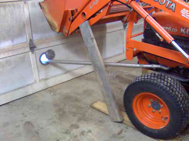

Couple pieces of exhaust pipe connected to the exhaust pipe of your tractor with a silicone hose should do the trick. Make sure to setup a remote kill switch outside the garage and a couple of CO2 meters in the garage...
Aaron Z
Yeah, I was thinking something like that. Only holding my breath - garage is small...

Someone asked about running the tractor inside with the door closed. This is a photo of my setup, since modified slightly for my current tractor. The exhaust is regular exhaust pipe from a muffler shop. I had them swage the end down to be a slip fit over the tractor exhaust. I have yet to need the generator in the winter so haven't actually run it like this beyond testing it out. The tractor generates a significant amount of heat when it is generating power. Last summer I had been away for a month, got home the night before the power went off for almost three days. I would run the generator in the morning for an hour or so to run the fridge and freezer, run the pump to have a shower and flush the toilet, make coffee then disconnect the generator so I could use the tractor to cut the grass and do other chores. I'd power the house again in the evening for an hour or so. That seemed to be enough to keep everything happy. I only have one tractor, seems like that is still enough. All told during the power outage I don't think I can atribute more than five hours run time to driving the generator so I'm not very worried about wearing out my tractor making electricity.
Thanks, nice idea, simple and sweet.
