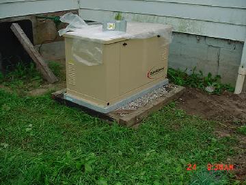

F350 Lawman:
I looked hard at lifting it and since I had no help, I put 2-3/4" iron pipes through the lift holes in the base (they go all the way through) and used 2 chains with hooks on each end to make slings. I put them over the FEL and lifted the gen set into the air. Then I unbloted the skid from the pre-formed base. Then I positioned the gen set on the base that I made up from pressure treated 4x4's, filled with pea gravel and set the gen set. The guy who owns the propane dealer that I deal with told me to set the gen set on a base made of 4x4's filled with pea gravel and he has one too, so that's what I did.
The HST on the 5030 in low range made it easy to position the gen set. At an idle in L, the tractor really moves slowly making close positioning easy.

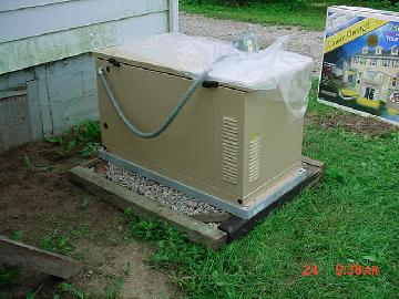

Here is another picture of the unit on the base. If you look, the feed for the propane into the house is right behind the unit. There is al "L" in the house right here and the utility room is right behind the unit too. Couldn't have worked out better.
Now I have to get a battery, ground rod and do the physical install so the electrician's bill won't be too devistating!!!
