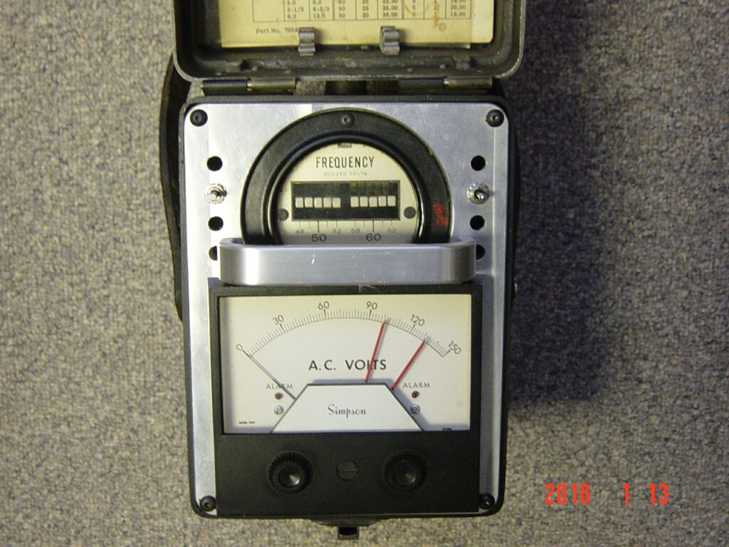

Best, just make one of these, like I did. No more guess work.
Every Alternators frequency is determined by the speed of the rotor. Newer Inverter style gensets usually produce AC, then make DC, and make 60 HZ AC electronically. Thus, the motor can run at various speeds depending on load.
Actually, all these are "Generators" by broad definition only and are actually Alternators. They produce AC.
The voltage value produced is governed by the field voltage, which is controlled by your voltage regulator.
Some inverter style sets (like an Onan Silent 15KW I had), actually use permanent magnets (I got it, because a magnet let go) that produce 3 phase power. No Field Winding. Then turn it into DC and again make AC with an inverter.
