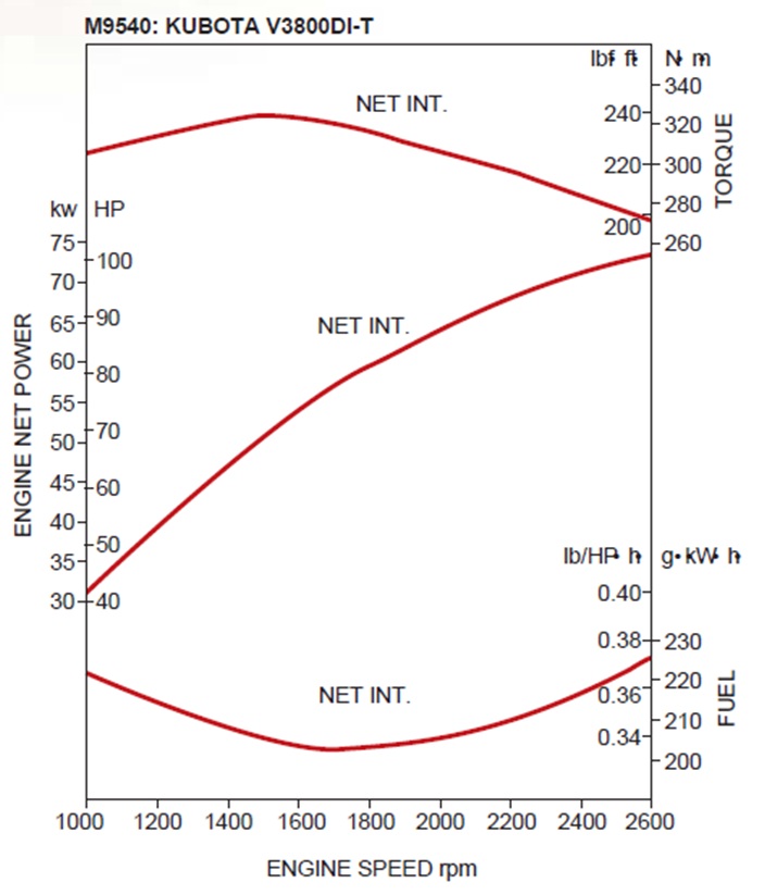

i guess you aren't thinking about the fact that in most cases.. fuel useage is based upon load.. not just rpm.
if your machine is making 10kw of electricity.. it will make little difference if it is doing it at higher or lower rpm.
you have a fuel efficiency and conversion to electricity cal to do.
fuel usage = load for the most part on a modern engine...
what you said true but when you factor in the engines efficiency shown in the attached brake specific fuel consumption which shows the engines in terms of fuel usage you understand why engine RPM not just load also impact the fuel economy and why economy pto's save fuel
example 1
Part 1 1650 RPM
Looking at these curves lets say you need all 70 hp (about the max power that this engine makes at 1650 rpm) this motor uses about .335 lbs of fuel/(hp hour) that translates to 23.45 lbs of fuel per hour.
Part 2 2600 RPM
now lets say your running the engine at WOT 2600 rpm using the same 70 hp load the engine uses about .375 lbs of fuel/(hp hour) totaling 26.25 lbs of fuel
diesel weights roughly 7 lbs a gallon
For Part 2 you would burn 3.75 gallons per hour for Part 1 you would Burn 3.35 gallons per hour or .5 gallons per hour difference In terms of dollars $2 per hour when diesel is $4 a gallon I realize this is a worst case assessment but its only to illustrate why over time an economy PTO saves Farmers money. If your only talking a few hours your right fuel usage is similar. but over hundreds or thousands of hours big money can be saved.
Running the tractor at slow speed does not mean you actually save fuel example
Tho one that people have the hardest time grasping is the fact that faster rpm can mean less fuel usage in the case where you run your tractor at 1700 rpm versus 1000 rpm you will actually use less fuel at 1700 rpm the engines efficiency comes into play here. People automatically assume that if the tractor will do the job as slower RPM they are saving fuel
Example 2 abbreviated
lets say your doing loader work and only run the tractor at 1200 rpm because you think your saving fuel rather than running the tractor at higher RPMs and your hydraulics are reasonably responsive in this range let say your average 30 hp load over the hour your burning about 1.6 gallons assuming about .36 BSFC and again at 1750 rpm your using about .335 bfsc you burn about 1.43 gallons so you spend about $0.70 per hour more running the tractor slower

The most efficient point for any given load is in the RPM band that has the lowest Brake specific fuel consumption period, assuming you generate sufficient power at that RPM for the required load. But with a generator your kind of at the mercy of what ever rpm you have to get 60 Hz power. If you have enough horsepower and an Eco PTO mode your good. In the case of the M9540 540 PTO is 2200 rpm if your generator and tractor is only pulling 20hp ~10kw the difference between 2200 rpm and 1650 rpm is only about 0.05 gallons an hour 1 gallon/hr worst case.
To Soundguy's point its not much different at this horsepower level

not disagreeing with you.. but since pto rpm is a fixed ratio based upon engine speed. I don't think those 2 examples are going to be usefull in compairing to a pto operation for the pto gen we are talking about.
not a single tractor i own has the pto setting at "WOT" thus using 'WOT' as a comparison point is a tad fallacious or at least or at least an obfuscation...
we would need to see the usage at load at (engine)pto speed.. and then usage at that same load at the (engine) Epto speed.
you will obviously have to choose a hp load that is going to be able to be handled at the Epto setting.
since that 1/2 comparison is so close still.. a couple bucks. and we are talking about emergency generator usage. i think that may have to fall into 'minutia'
example 1
Part 1 1650 RPM
Part 2 2600 RPM

yeah,. you have to make sure your target hp neede dis available at the epto before you make the comparison or all bets are off. epto won't do you much good if it doesn't make the hp needed for the load..e tc.

As for fuel efficiency. A fully loaded gas gen set burns less fuel than a large diesel on an undersized load.
For example the Nebraska tests for a Case IH 110A.
At 92HP, .494lbs fuel per HP per hr.
At 42HP, .667lbs fuel per HP per hr.
At 21HP, .935lb fuel per HP per hr.
Diesels and gas turbines have lousy part load fuel efficiency.
