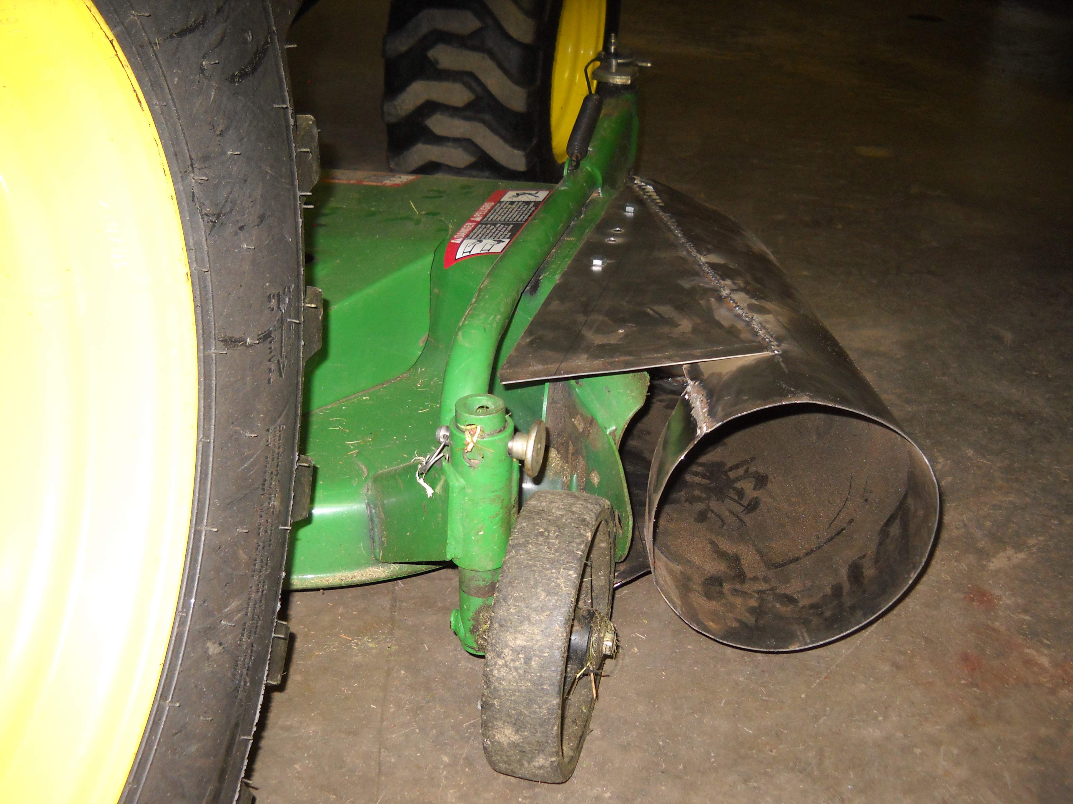

Made the transition to blower hose from the mid mounted mower last evening. Used 20 guage material which should be more than adequate for durability. Next a matching 8" collar from the square 5"x5" square fan housing exit.

Looks good so far, really interested in how this works with the pine needles.
Keep up the good work and keep posting your progress.:thumbsup:

Look at the picture on the previous page. Drive pulley to small pully ( increaser ) jack shaft with small pulley has a larger pulley to the left on the same shaft. This is driven to a smaller fan pulley ( also increaser ) for final RPM. I ran the pulley sizes through the RPM Caluclator. I also marked the drive pulley and the fan pulley. ( One full turn of the drive pulley moves the fan pulley 6.25 revolutions ) The ratio is 6.25 to one that makes the 540 increased to 3375. By two seperate calculations I believe it is very close to the final shaft speed. It moves a tremendous amount of air at mowing RPM and I am sure with an eight inch chute the vacuum created will be adequate to drive those leaves / pine needles to their final holding position.
I have no reason to believe it won't work. The jack shaft arrangement gives me the closest distance between the mower and the fan. If I can get the product to the fan the four inch fan blade surface will create the motion to continue the journey. Besides for less than a hundred and a small amount of brain stimulation I have created a moving monster that .......... if ducted to the future cab project would cool the operator!

Finished the inside duct work on the mower take off and built the two flex pipe adaptors for the fan housing today. The five inch inlet / outlet on the fan seemed small by todays standards. They were expanded to the eight inch variety that hopefully will avoid getting plugged and provide better air flow. I have some expanded metal for covering the drive pulleys but until it is tested and works properly that will have to wait. Besides the tractor interlock system will not let the PTO operate once you have left the seat. ( I like these child proof features )

I had a Yard Vac with a smaller blower unit and a 5" flex hose that was about 6 feet long from mower to blower fan. Another section of hose to the cart ( about 4' ). This combination packed in pine needles so tight one had to force a fork in the trailer to unload.
For this reason and others unknown I ventured out on a whim to make something more compact, less engines, and easier to unload. The rake idea sounds good. I would have to put together a rake with thin tines and a loader bucket that would self load. The current flat edge bucket would only push the pile around. With the amount of wind this combination moved when tested I have no doubt it will provide plenty of air flow to place the debris in the container.
