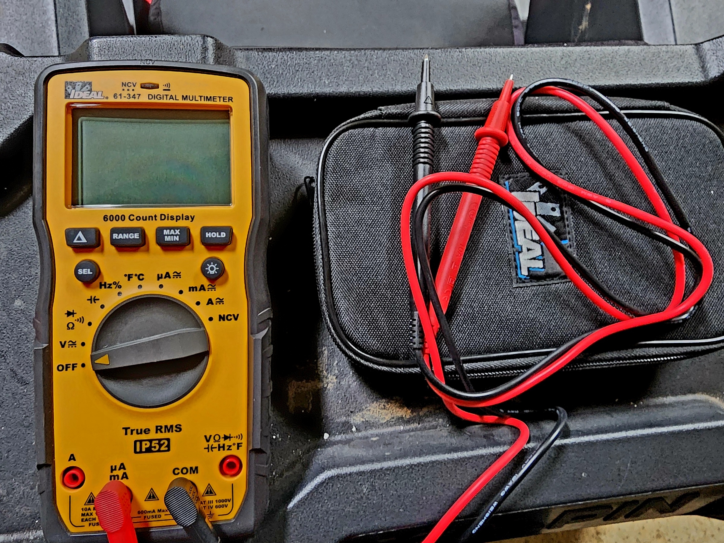

Thanks, I really appreciate you trying to walk me through this, but I'll be honest, you're kinda speaking Greek to me, but I'll do my best to try and follow along, I swear!! 😆 .... (I've got very little experience with wiring unless household and even less experience using a meter).
That said, this is the meter I have & honestly don't know where to start.... (sorry, I'm that inept when it comes to this stuff).

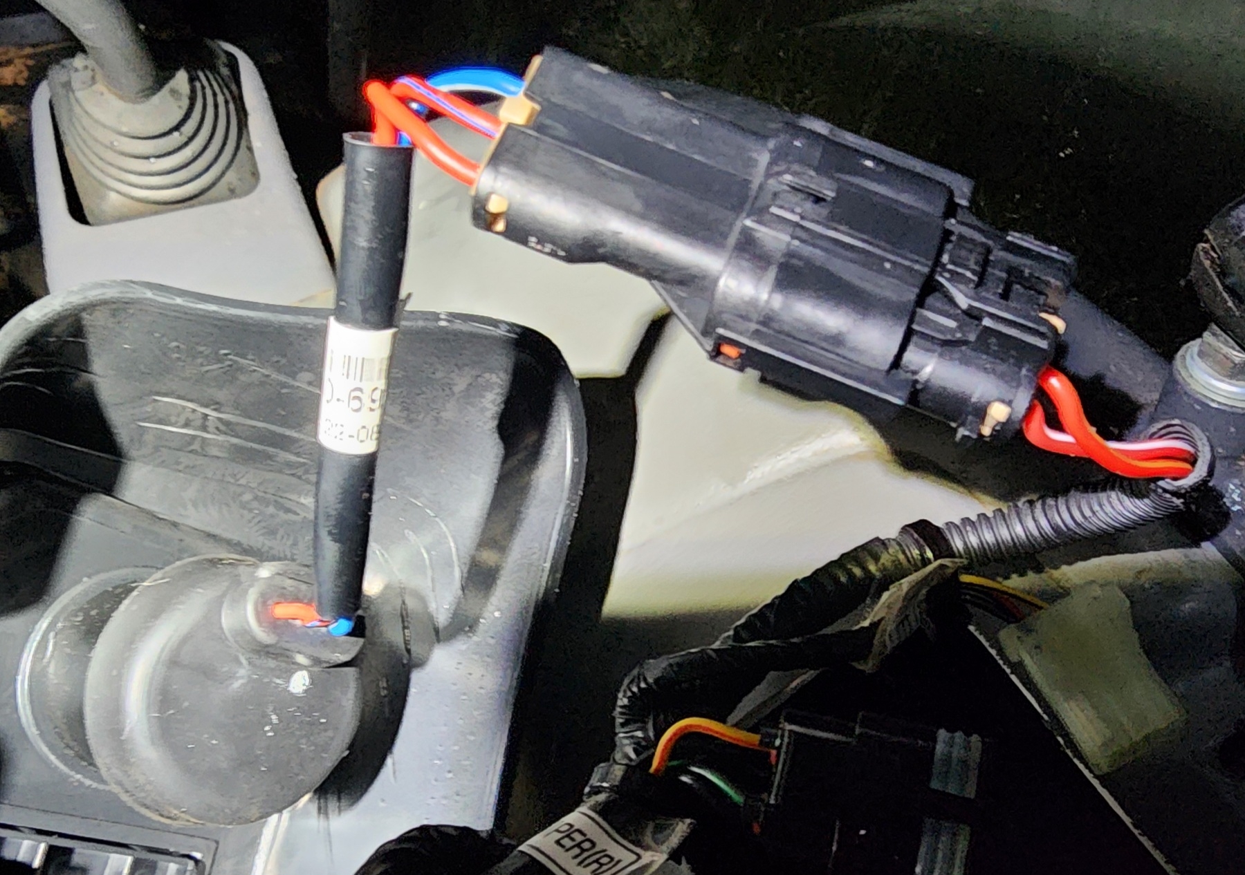

When I pulled the PTO switch mount from the cab fender rail, there were 2 wires originating from the tractor wiring loom going to the PTO connection, then 3 wires going from that connector to the PTO switch base, as seen below:
2 wires means you have an spst switch so your switch is good

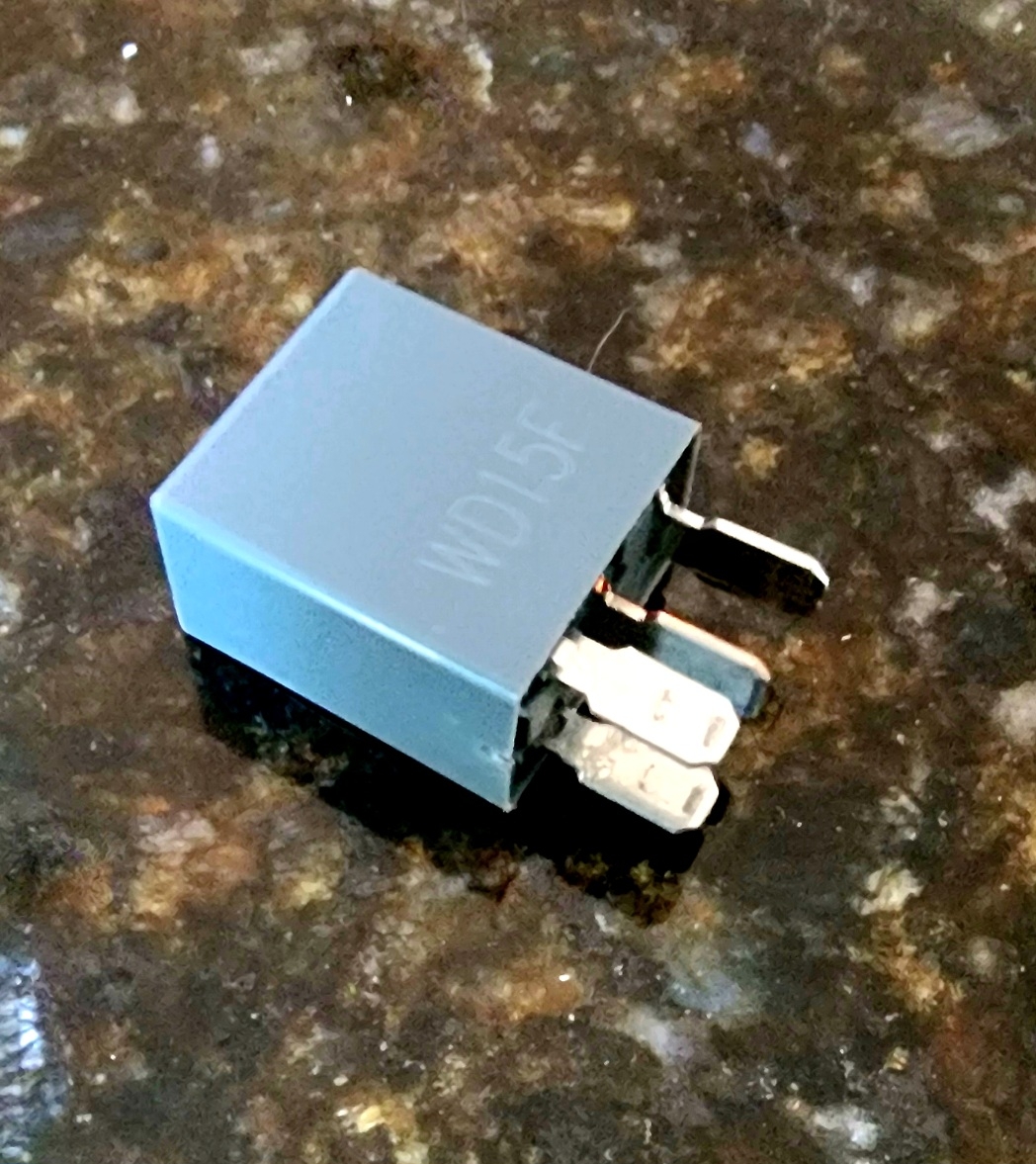

Mystery solved, bad PTO relay.

The dealer didn't have any spares, they gave me that one off of another tractor since they had some on order.
Are they generic relays that you can pick up at an auto parts store?

Tried to find them online, but no direct match, but believe I tracked some down at O'Reilly's that have a different part number but with all the same markings.
