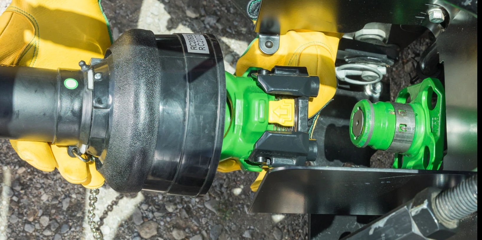

Does this thing work well? At $400 and another $225 per shaft for additional pieces, I want to know that this thing works as advertised and isn't just another piece of junk.

I looked at those. Looks pretty neat, but after watching guys put them on and off, I have to wonder if the time/effort saved is worth the cost. That's a lot extra to fork out for each PTO based implement. Guess it depends on your level of frustration.
/ PTO Link - Anyone using it? #3
Yeah, my shafts go on easier than that thing. All I do is push a button and it slips on. I just cringed when I saw the guy fumbling around with it to align then inserting a pin. What the heck? Where's the saved time? Looks like a finger smasher to me. :cool:
/ PTO Link - Anyone using it? #4
With the PTO Link both halves still need to be in alignment. If not one shaft needs to be rotated. Still a major PIA.
Their competition offers a setup at the same price point that doesn't need alignment and just slips together. The coupling unit is designed to rotate enough to allow connecting without rotating equipment or tractor PTO shafts.

And the PTO Link doesn't eliminate any of those situations. ;)
With the tractor off, my PTO shaft moves easily. Even if it didn't the implement shaft should move enough to align the splines. It's not going to be more than about 1/4" of movement in either direction. That's how I engage mine. I don't like touching the output shaft except to wipe it off with a rag.
/ PTO Link - Anyone using it? #13
PTO Link has 4 pins that need lined up. A 540RPM PTO has 6 splines. So you have to rotate it 50% more (max rotation required of 45 degrees instead of 30 degrees) to line up if you have PTO link vs a regular PTO. Also it adds more weight to the end of the PTO after the universal so there is more to hold up. Since it is after the universal it will flop around forcing you to hold it by the yoke (were it is always greasy). The unit is not covered by any safety shields so it does not meet any ASABE spec's, one accident and the company is done. It extends the PTO out causing potential issues the driveline being too long. If your cursed with one of the horrible collar style pto yokes switch it out with a pin style, they are much easier to deal with. The cost of a pin style yoke is under $50 for most drivelines. The PTO Link is a expensive mousetrap that actually makes it harder to hook up implements.

PTO Connect is the one that doesn't need shaft alignment. The coupler has enough play to allow the notches to align. Don't know about the Deere system and alignment. PTO Link doesn't look like a good solution.
I replaced a couple springs that were too hard to depress, polished pins and debured and polished 2 that were difficult to slide on. All of mine now easily slide on and off. Light spray lube on each before and after.
For someone with only one tractor and just a few implements the the Deere setup looks slick.

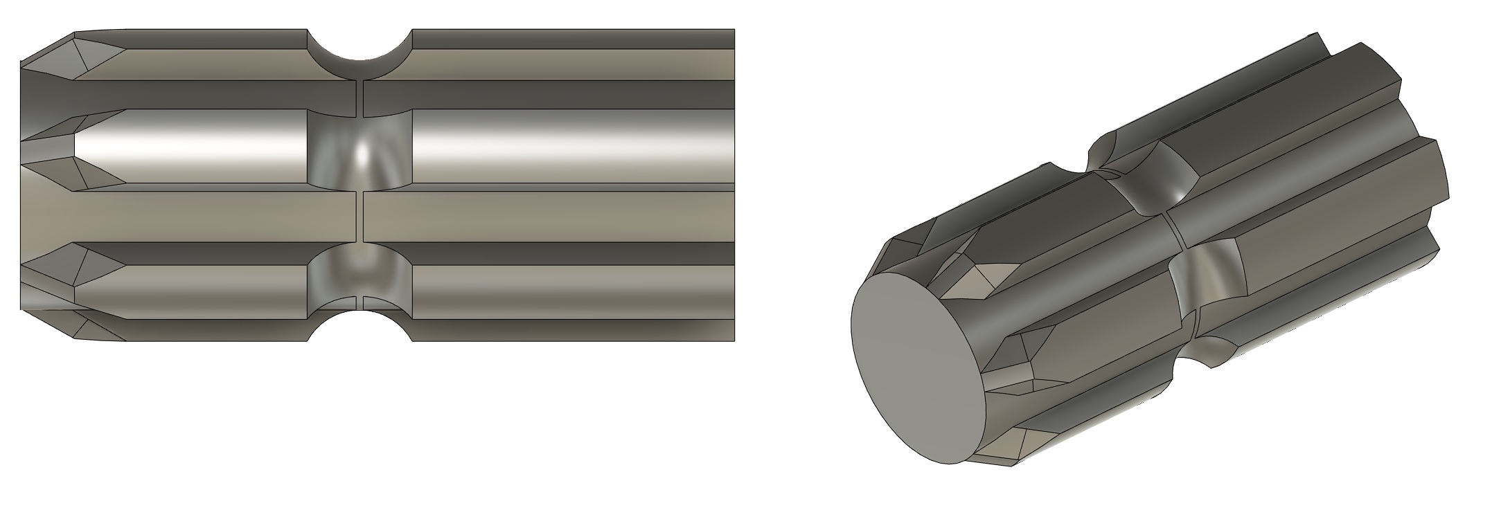

With today's modern machining and processing capabilities, I still can't quite figure out why tractor manufacturers won't just simply bevel each spline on the PTO shaft to help hook the PTO shaft. Pretty much what JD uses on their Auto connect decks.
Made a quick 3D drawing. Hopefully what I'm trying to say comes through. While I don't really have any problems connecting the PTO shaft, I can understand that for some can be tricky. Specially with so much in the way.
I shared this on another thread about hard times with PTOs. It also applies here.
One could also grind this shape with a grinder but can be tricky.

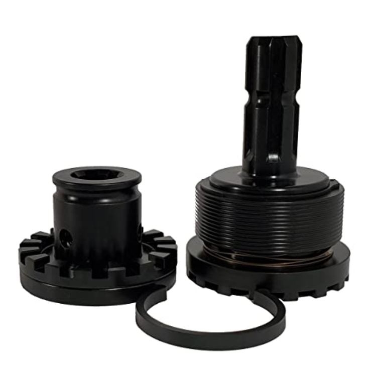

I've been using the PTO quick hitch for 2 years. 2 mowers on/off alot. It's easier than a bare driveline attachment. Plus it gave me a 4" extension which compensated for the Pat's Quick connect. No regrets on this addition. The teeth are about 5/16 wide so shaft rotation is minimal to align and engagement is spring loaded. Pretty simple to use. And it stays clean to handle.
