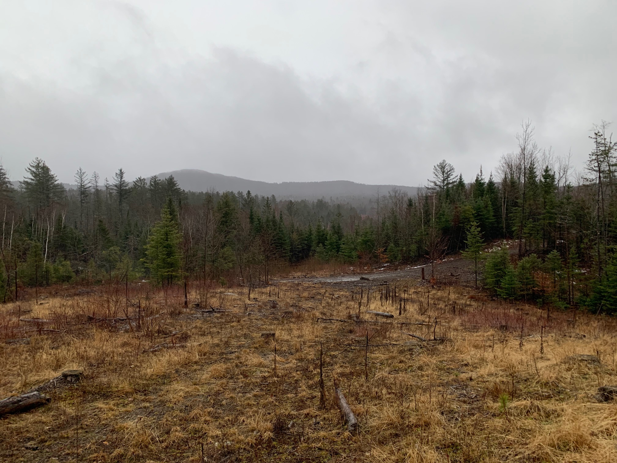

For reference here's the PTO Mulcher I've been considering. My local John Deere dealer sells the "Seppi Miniforst 150" for just under $22k and should fit a 7060 nicely. MINIFORST small forestry mulcher 60-100 HP | SEPPI M.
Anyway, since the pine trees were all planted in a plantation (more or less in straight rows) I figure I should be able to drive through and brush hog in between the rows of stumps (once i clean up some of the deadwood and other debris). I'll plan on doing this in the area i'm not getting mulched for this summer and see how that works. At the very least it should make hiring out mulching easier (and cheaper) next summer (2022) if I decide to go that route again. But perhaps it will work well enough and I can just continue keeping it open once a year until the stops rot out.
