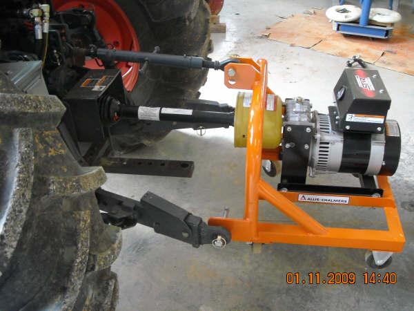

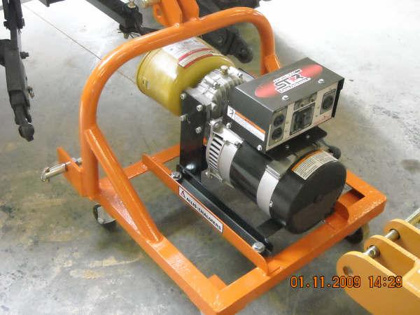

I have the same Northern Tool PTO generator. I found a way to get about 15-20% more power out of it. I painted the frame that it mounts on orange and put Allis Chalmers decals on it! :)
