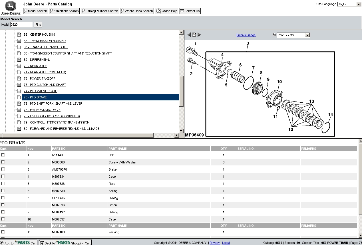

Hi everyone, I've got a 2007 JD 2520. I've got a technical problem with the PTO I've never heard of/seen before. Did a search via this forum and not much came up. Wondering if any fine folks on this forum have seen this issue....
Basically, when using the rear PTO/snowblower, I'm noticing the PTO is not shutting off fully when I push in the PTO switch on the dash. If left to spin with little to no resistance it actually spins quite fast.. speed goes up as I increase RPMs. Only way I can make it stop is by backing into a snow pile, then it seems to come to a stop finally. it's intermittent. sometimes it works properly again, but the it seems to act up. When it acts up, ssame thing happens, after blowing snow, I shut off the rear PTO and the shaft keeps spinning.

   / PTO not disengaging on 2520 #3
The PTO brake is not working. It should stop quickly and you should not be able to turn the shaft by hand with the engine off.
Oooooo..sounds complicated to fix! Thanks for the exploded diagram. How much of the machine do I need to tear apart to get to this brake? I've got a shop manual on order. I hope it gives a little detail on this procedure.

The PTO clutch and brake are operated by the same hydraulic pressure. The brake is actually applied by mechanical spring pressure and released when hydraulic pressure is applied to the clutch.
So, it could be that the PTO electric solenoid is leaking pressure into the clutch system, causing release of the brake and partially engaging the clutch. This could be an easy fix, since the solenoid is mounted to the outside of the transmission and can be serviced without getting inside. The PTO clutch pressure can easily be tested with a gauge by your dealer.
If that's not it, then some amount of disassembly has to be done to get to the mechanical components of the PTO clutch.
