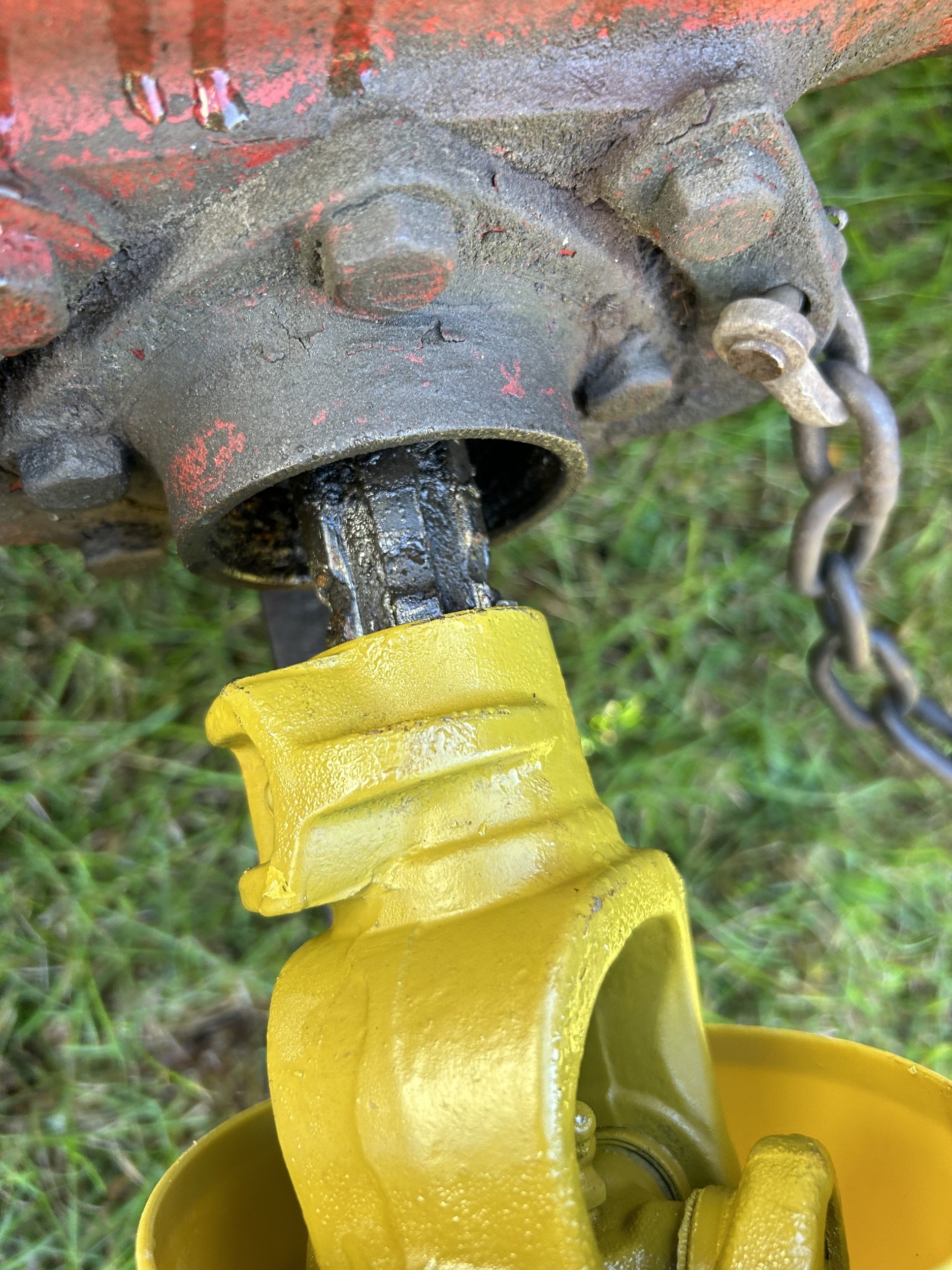

PTO on 8N won’t attach to mower shaft. My 8N PTO has a kind of slight flange around it that keeps the u-joint from sliding on enough to engage the

PTO on 8N won’t attach to mower shaft. My 8N PTO has a kind of slight flange around it that keeps the u-joint from sliding on enough to engage the button shaft that secures it. Anyone have any ideas? IMG_0891.jpegIMG_0892.jpeg

Try cleaning all the accumulated crud off first. That shaft as well as the shaft retainer is putrid looking. Cleaning off the crud in the shaft retainer might actually provide enough clearance to where the implement pto shaft will engage the lock on the stub shaft.
You could buy a pto stub shaft extender that secures to the stub with a bolt.

Is the issue that the enlarged portion shielding the push pin of the connector is hitting the flange just before it would latch in,
you could grind of some of the raised portion of the coupling to clear the pro shaft flange.

Shaft extenders can cause problems with vibration and shaking of the pto shaft. If needed you can get shaft size adapters that are not extenders.

I would do one of two things.... Remove flange from tractor and grind (or machine if you have lathe or milling capabilities) off enough for "U" joint collar to fit, or grind off enough of "U" Joint collar to clear flange.... Personally I would cut back flange on tractor side if the is enough material to be removed with out exposing a seal or bearing as a one time fix so if you ever use a different PTO couple you would not also have to modify it if there was a interference problem....

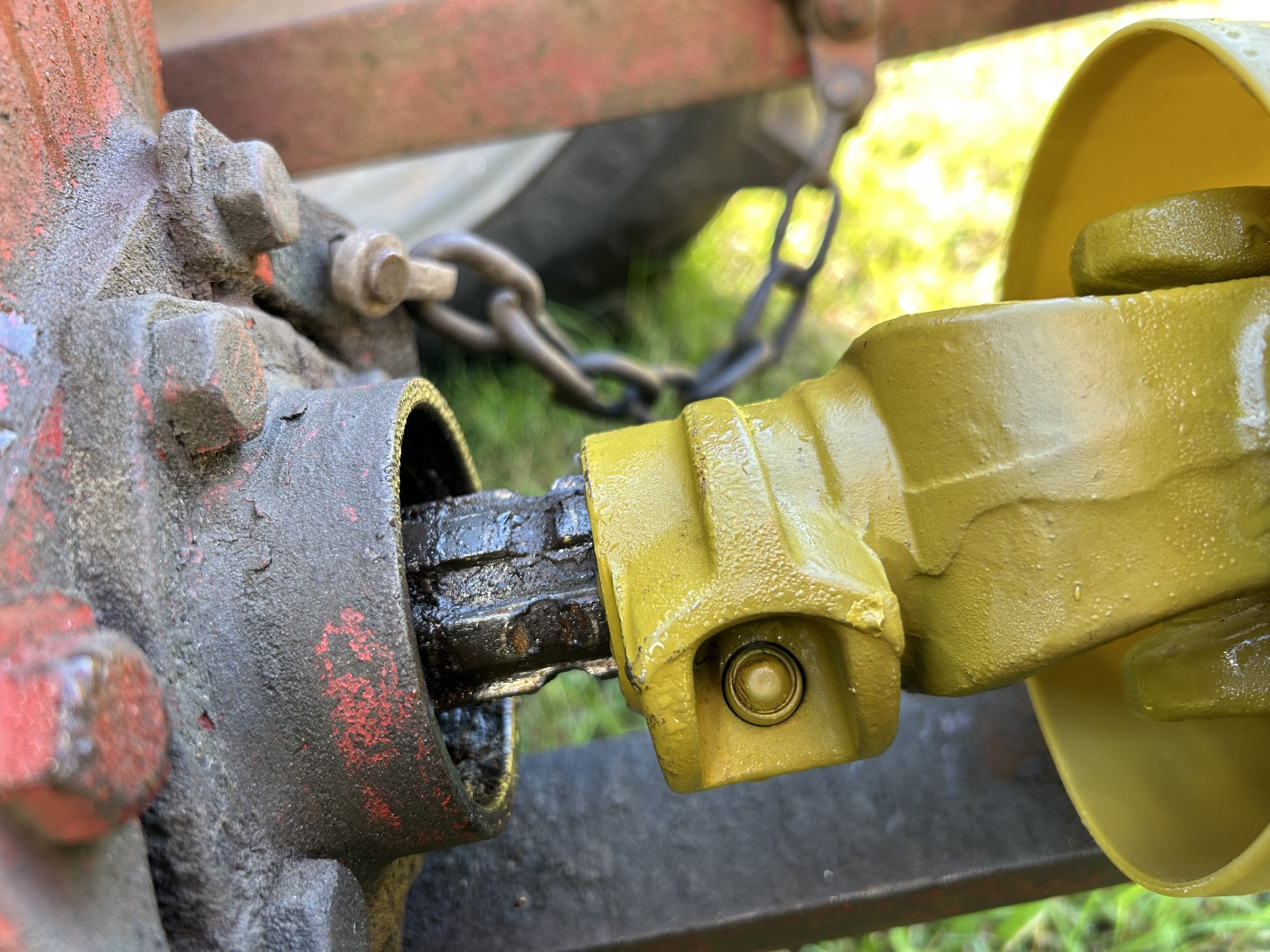

Hi folks...took a bit of time and fussing but wanted to update you. PTO connection problem was resolved by leveling the implement to the PTO.
In each of the OP's pictures there is obvious misalignment.
