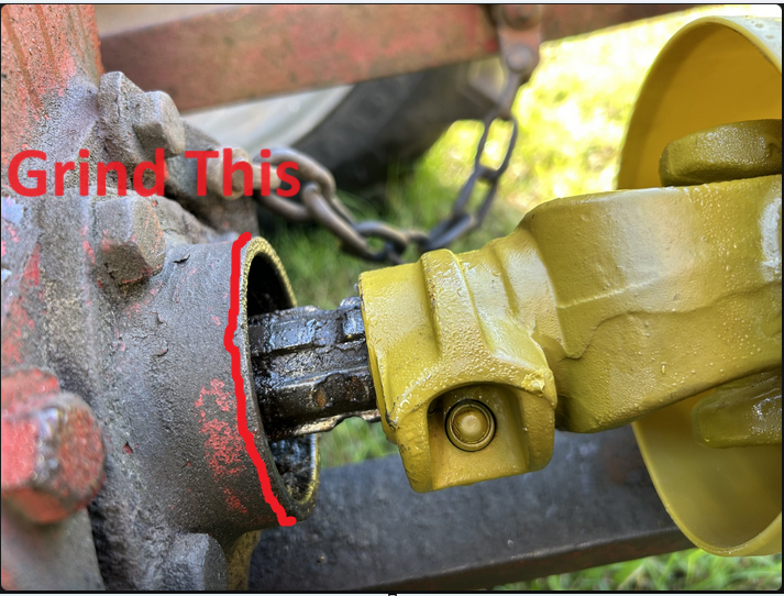

PTO on 8N won’t attach to mower shaft. My 8N PTO has a kind of slight flange around it that keeps the u-joint from sliding on enough to engage the

Clean it up with an angle grinder and a cup brush. Apply a light coating of oil or grease and give it a try. The yi=uck on the PTO shaft is the problem

If that doesn't work, run a file down the PTO splines to take off any burrs.

It looks like the OP slid the pto yoke onto the spline ok but the yoke casting is hitting the raised part of the bearing housing on the 8n. I would just grind down the pto yoke the small amount it would take to let it connect.

I apoligize, I mis-understood what the OP's problem was , I didn't realize the problem was it not sliding on far enough before it hit's the flange on the tractor, maybe the pto shaft extender is the best best if you don't want to grind some off of either or both sides which I would hate to do.

Shaft extenders can cause problems with vibration and shaking of the pto shaft. If needed you can get shaft size adapters that are not extenders.
Interesting comment Lou.. The shaft extender I have is split with a hex cap screw so you can actually clamp it tight to the stub and eliminate any vibration / slop.
