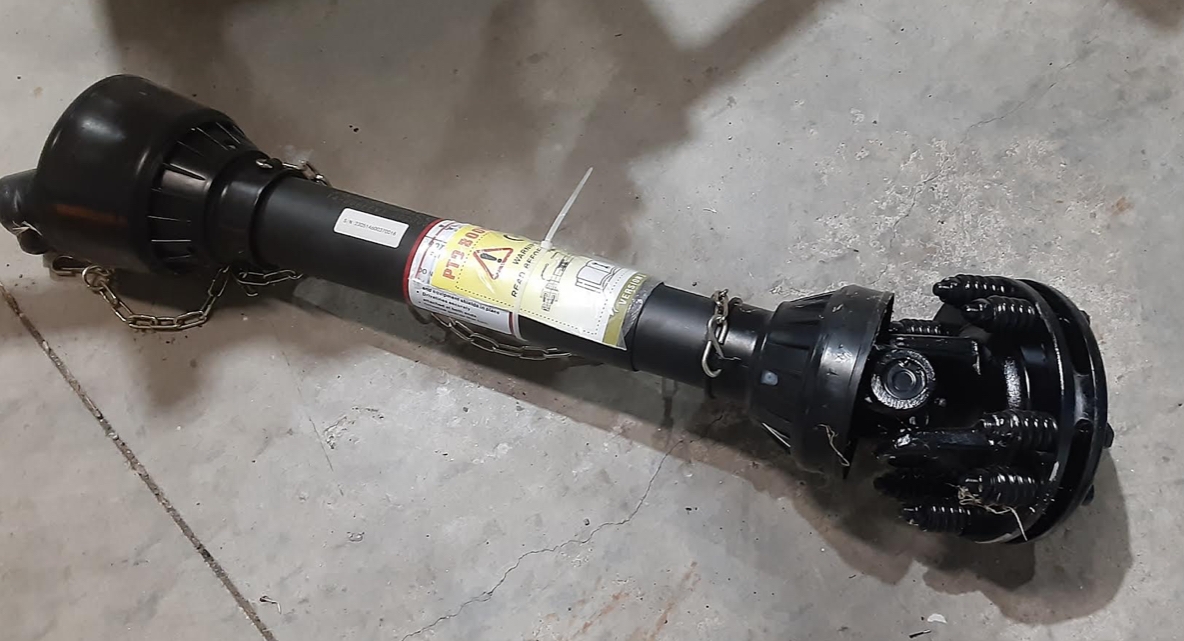

I'm also curious as to what your idea is for the final drive? If it's to be PTO direct powered, I would suggest buying an over running coupler to install between your PTO stub and the driven shaft at the least and possibly a friction slip clutch as well because you will encounter shock loads as well as the rotor on your design will freewheel when the PTO is disengaged and the heavy cutter wheel freewheels without being driven. That freewheeling rotor will destroy the PTO brake on your tractor in pretty short order plus it imparts a high shock load on the PTO clutch.

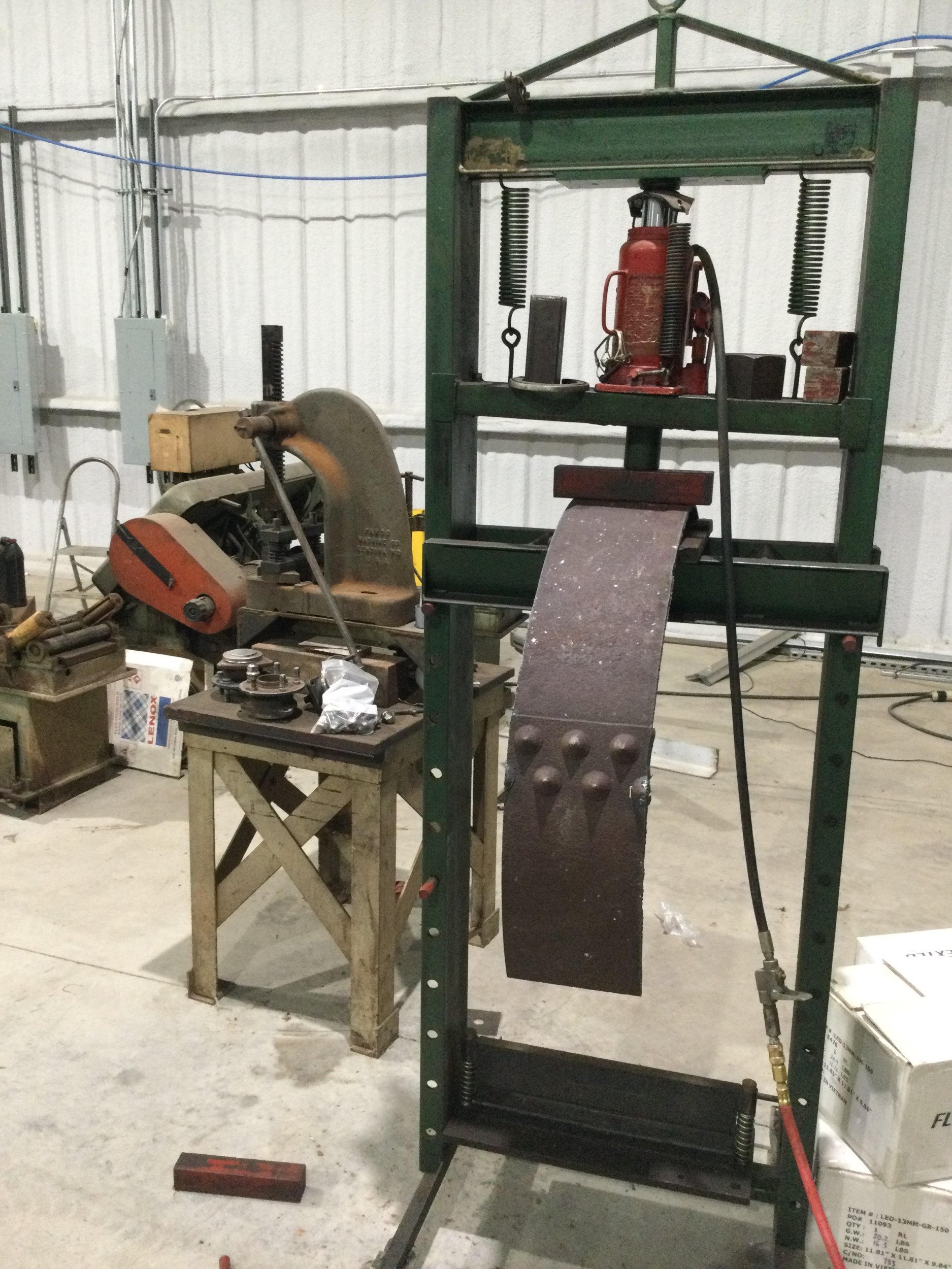

I have a slip roll that I made I have used up to 2” box tubing but it’s only 4” wide, this is it.

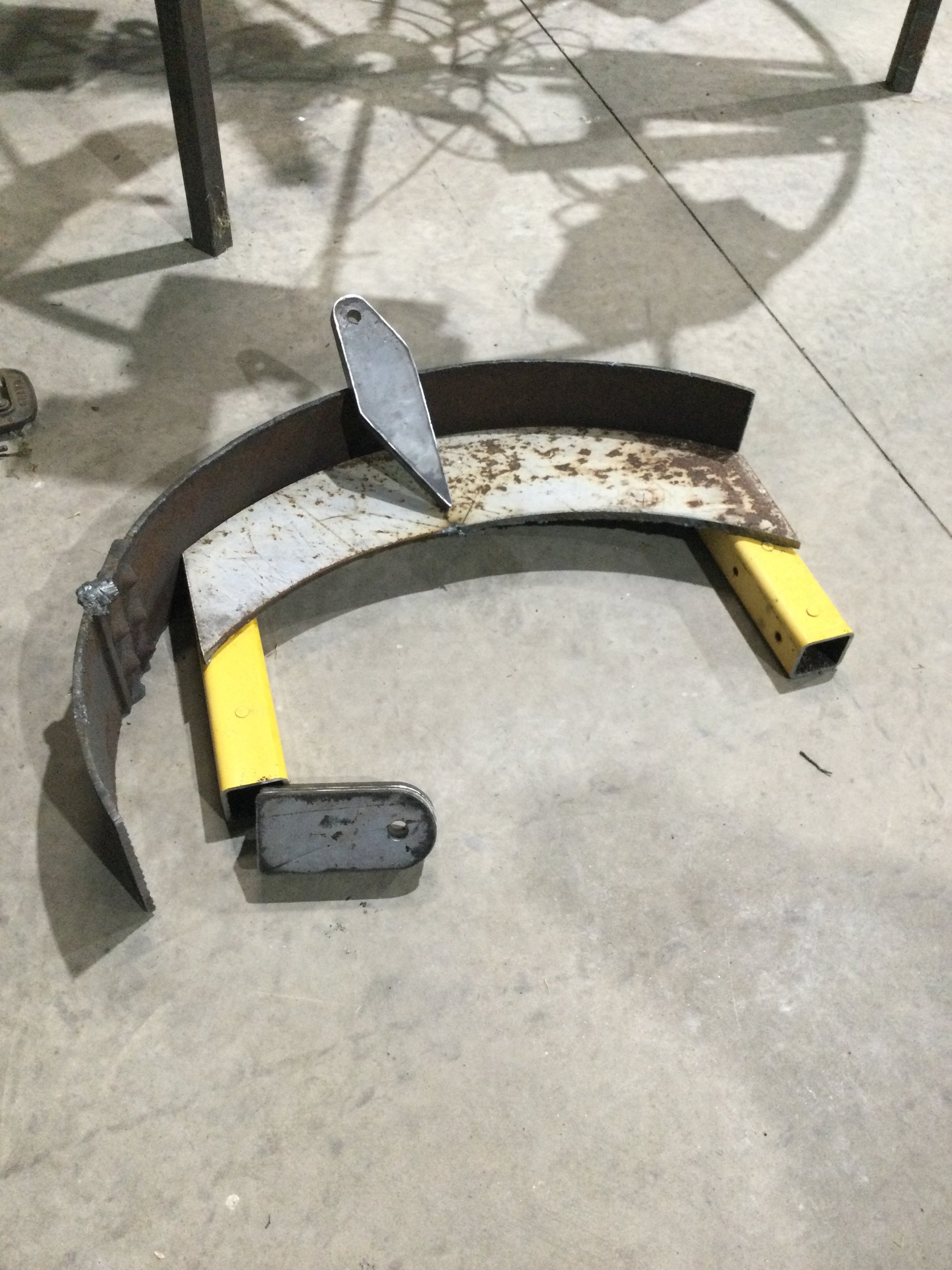

The 1st photo in the OP shows the piece of rolled steel used in this project and the part it was cut from. As well as the 5th photo in post #8.
The clutching drive shaft was one of the few “brand new“ parts of the project. Also, in the 1st photo of the OP.

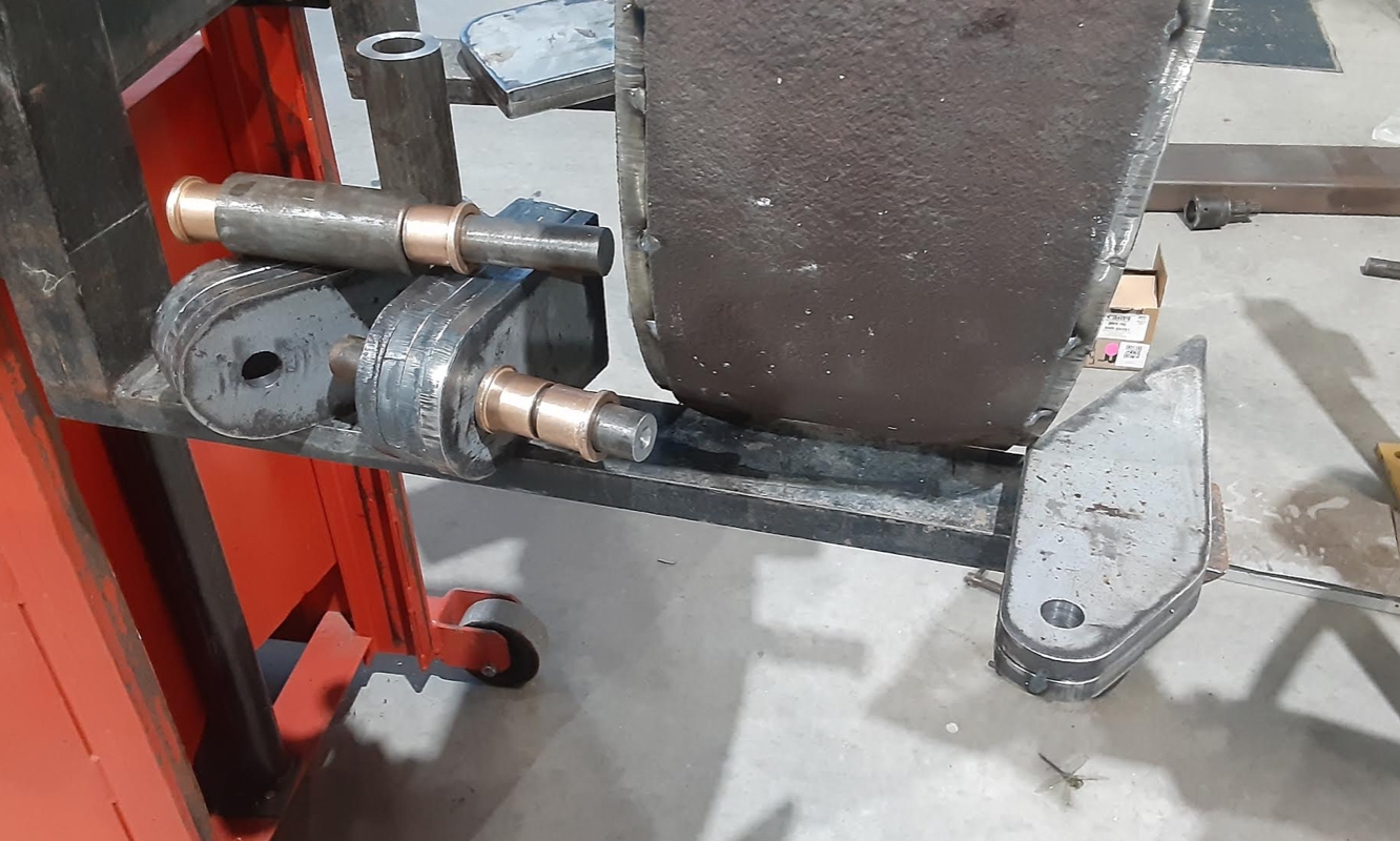

I did manage to drill a few more holes though, so progress was made. Cut the tubing for the pivot‘s and the bronze bushings came in.

Nothing beats 660CA impregnated bronze bushings. I buy my 660 bronze bar stock direct from the manufacturer which just happens to be somewhat local for me, just like Green Manufacturing. Just turned and fitting a complete set of bushings for a Deere back hoe that the bushing were totally shot in and me making them from purchased bar stock was about 1/3rd the cost of what the dealer wanted.

Glad you got a PTO shaft with a slip clutch but don't forget to loosen the securing bolts up and slip it before hand as they tend to seize (friction plates to the metal driven disc when sitting), I slip mine every year on the implements that don't have a built in over running clutch. I usually take a paint marker and mark the position of the bolts before loosening them and tighten them to that mark, plus the mark will indicate if the clutch is slipping correctly.

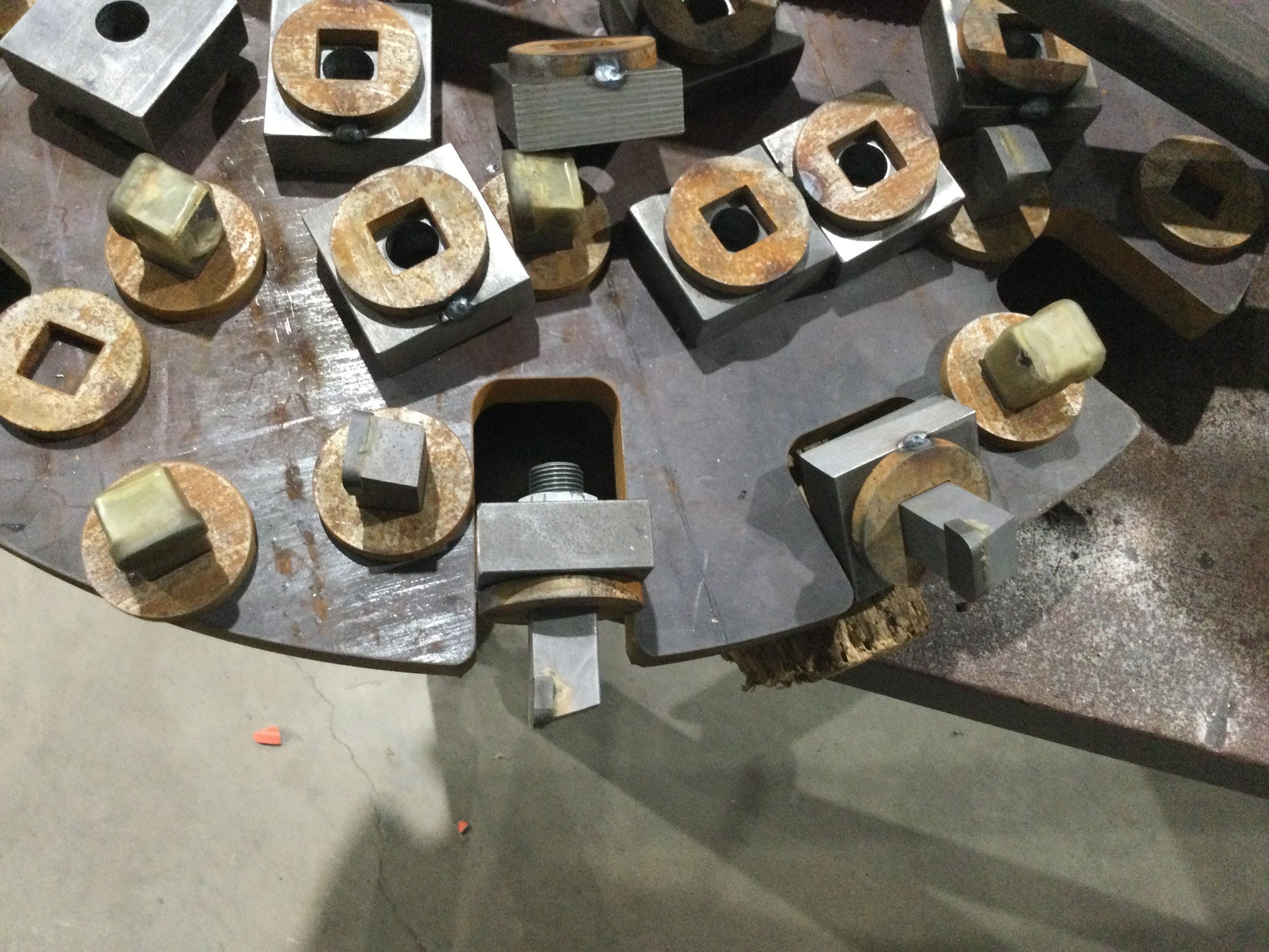

I managed to make a little headway, have my non perpendicular blade mounts all ready to go.
Cut a couple of 3 x 1/4 box tube sections that will have telescoping feet for storage.

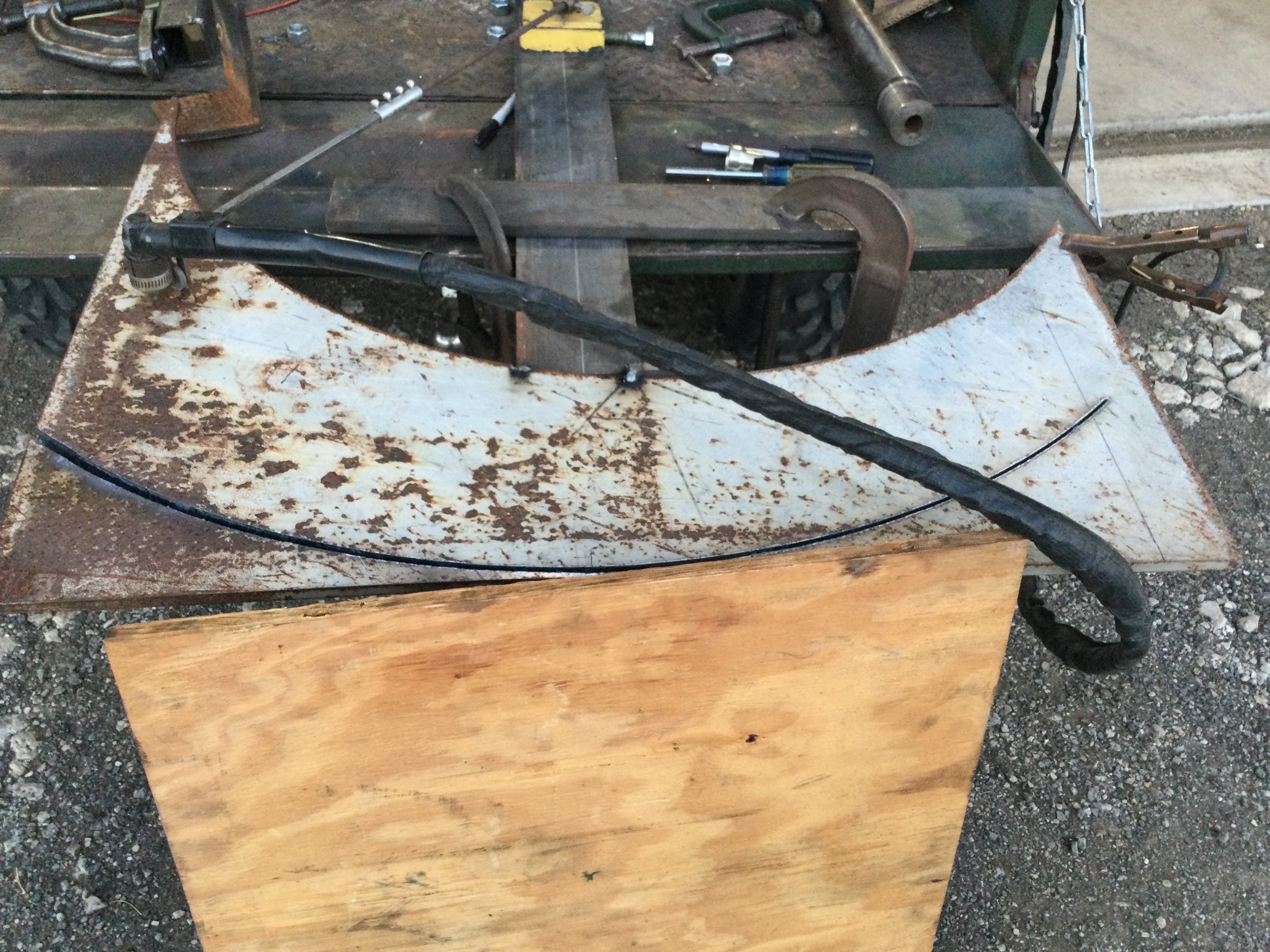

The remaining section of boiler plate was too far off of the main frame arch for me to have hopes of getting this steel in place, so I work it a bit in the press to get it right, before hand.
I only cut one side plate but it was an almost perfect use of the drop piece of steel.
One more piece and the 3 point end is ready to prep and weld.

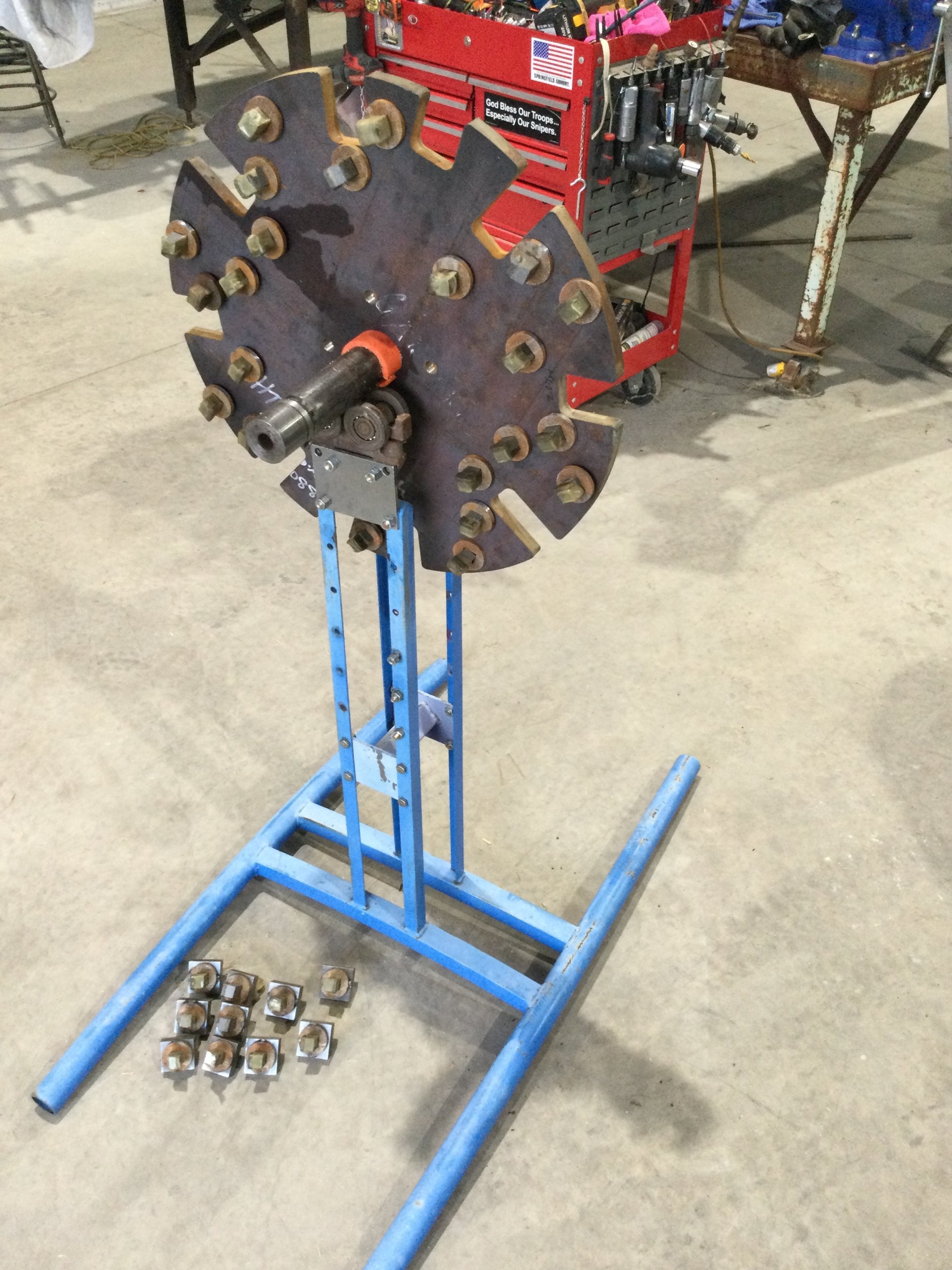

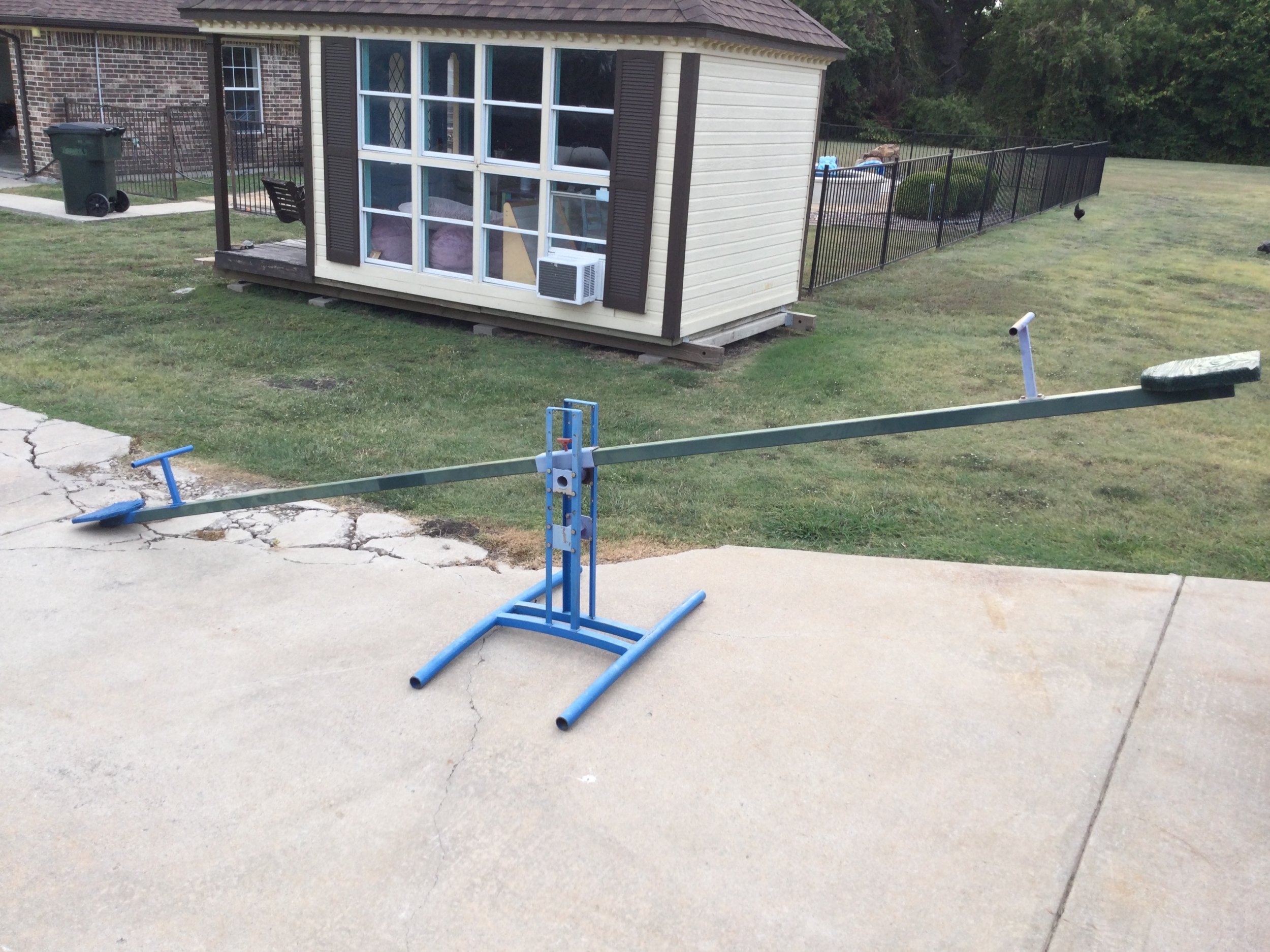

Have the generator running like a top now and decided I needed to borrow a part from the kids seesaw, bolted on a couple hanging door skates and it seems pretty decent way to balance the grinding wheel when I’m done with it.
