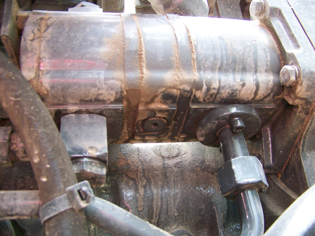

Ended up with an external leak at the FEL control valve today. Couldn't pinpoint the exact source, but everything was tight to my wrench and the leak is not that bad. One good rag wrapped around it and I continued working. I'll worry about fixing it after the "rockscape" job is completed. :)
Well, the FEL control valve (Prince LVS) is leaking like a cow relieving itself now... and I am out of commission until it is fixed. The "rockscape" client is not happy... and so I may end up renting the JD110 after all. I asked him to grant me a one day maintenance delay... and if the FEL control valve leak can't be fixed... I finish the job with the JD110. Problem is that the Beast is at the jobsite and God only knows where I'll get parts in one day. I suspect it could be some o-ring somewhere... but if it is a cracked body, I am zinged but good!!! :rolleyes:
First serious equipment failure on a client's site. It does not feel good. :(
Dougster
/ PTO Pump #186
Saturday Morning Update: The infamous "rockscape" job is entering the final stretch. There was a big step forward yesterday when I brought in a rock splitting subcontractor to break up the two large surface rocks. Price was quite reasonable compared to the heavy equipment moving options... and now the two surface monster rocks will be gone for good. We keep finding new buried rock "challenges", but the worst is probably over. Only one potentially serious problem rock remains. It was hidden from view under one of the monster surface rocks and we didn't notice it until several of the monster rock pieces were cleared.
The 4110+509 continues to amaze everyone, including moi. Some of the operations ain't exactly fast or pretty... but the results to date are hard to argue with. The sizes and sheer amount of rock that have been cleared to date are almost shocking. Largest rocks successfully dug out and moved to the rock pile: about 4,000 lbs each.
In regard to the FEL control valve leak, I replaced four o-rings on the quick disconnects and got the leak back down to an occasional couple drops. No more cow relieving itself. Two o-rings were good, one was marginal... and one had completely disintegrated. Finding the right o-rings was not quick or easy... and the ones I installed are probably not a perfect fit. I will deal with the remaining small leak(s) after the job is complete and the Red Beast is back in it's garage bay.
In regard to the PTO pump... I am probably not getting one. The backhoe's problem is neither flow nor speed. At 2,500 engine RPMs there is plenty of flow and plenty of speed. The problem, if any, is inadequate operating pressure. The operating pressure issue must be resolved first or I'll just be wasting my time & money.
