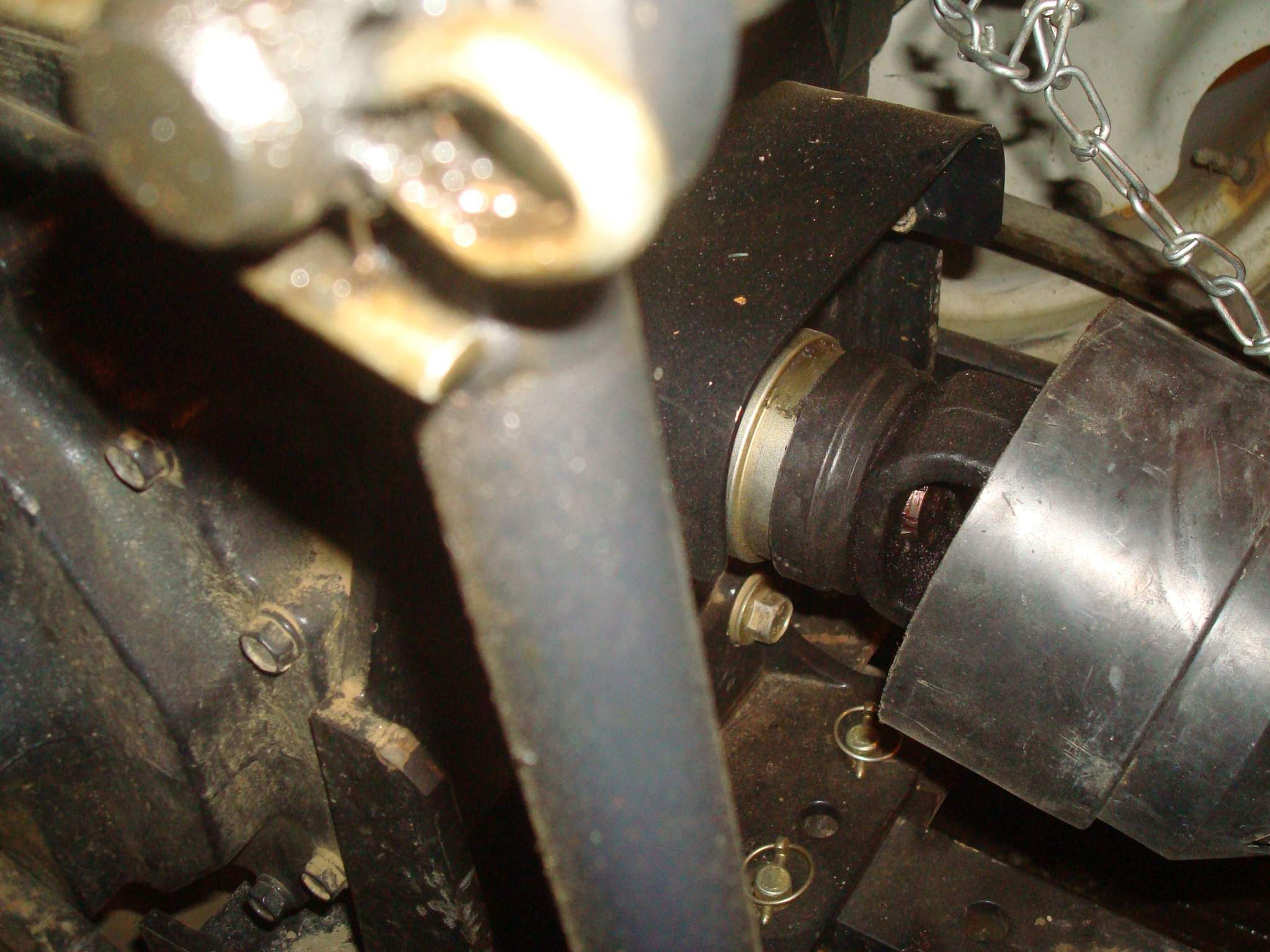

This is my pto shaft minus the stamped sheet metal flip up shield that I removed from the tractor. If the shield were installed, it would cover the gap between the tractor and the pto driveshaft shield. I have trouble understanding how I can trip/fall into and be captured by what is exposed. Anything is possible I guess, but the chances are very remote that my body can actually get to that position.
If I were inclined to do something stupid, there would be nothing from preventing me from flipping up the removed pto shield while the tractor is running and pto engaged.
I can't reach the pto from the seat. The tractor will not start with the pto clutch engaged. This is not an old tractor with a live pto that is mounted from the rear by stepping on the drawbar.

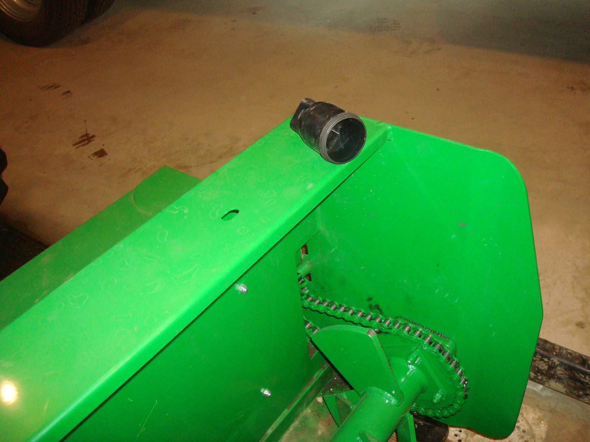

This is the plastic screw on pto output shaft cover that I always attach when the pto is not in use for safety and keeping the shaft clean. Note the standard, as-manufactured wide open chain and auger on the snowblower.

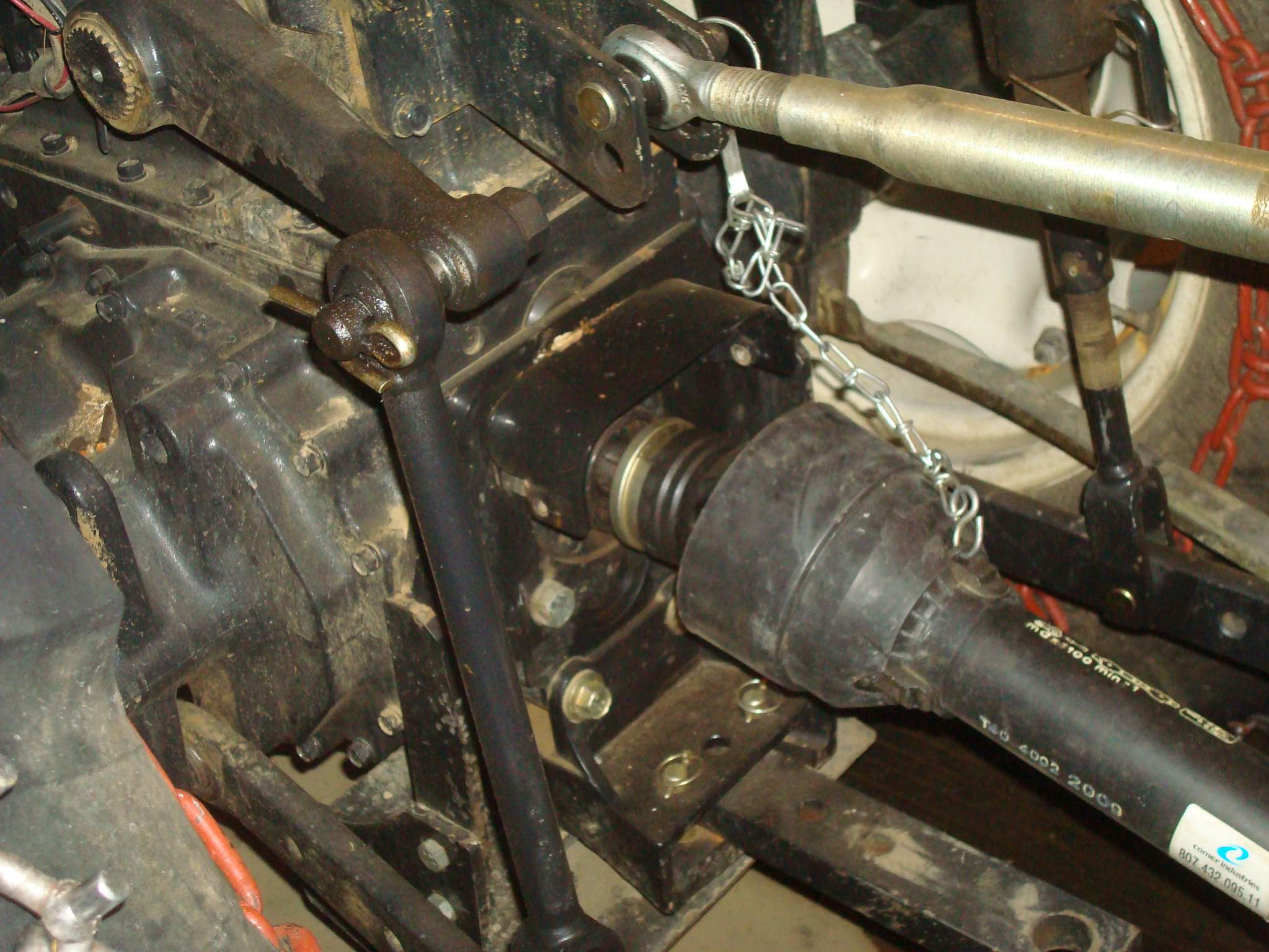

Thank you for your concern and inputs.
The flip-up shield is maybe 12 gauge sheet metal held on by two ~1/4" bolts. It's u-shaped, when in its normal position it shields the top and both sides of the yoke. It does not lock into place by any means. I'm in trouble if that shield is going to protect me or the tractor from a separated driveshaft. :)
It isn't sturdy enough to stand on even. From the design, my guess is it is mostly intended to keep hands away from the rotating shaft.
I do have the safety chains at each end, a full pto driveshaft plastic shield end-to-end, and the shields at the implement end are in place. I do come to an idle and let the implement coast down before engaging/disengaging the pto, and it has a pto brake.
The problem that it causes is not greasing as much as the space it allows is so narrow, it makes connecting the shaft to the pto difficult. When it's flipped up, the side portions of the shield are tight right next to where my hands need to be when pulling back the lock ring, rotating for spline alignment and pushing onto the pto shaft. My fingers and hands aren't what they used to be strength-wise.
I can put it back on if it makes you all feel better, but I know who's gonna get cussed when I skin my knuckles. If you feel your ears burning someday, you'll know I was attaching a pto shaft. :laughing:
