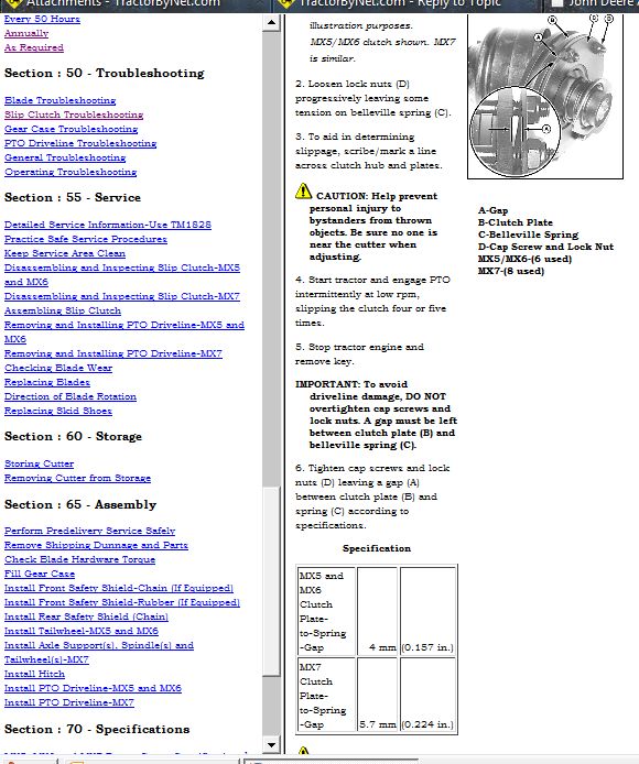

Perhaps you chose to assume that there's no maintenance involved with their so-called "self-adjusting slip clutch". Here's an extract from the MX6 owner's manual. There is a specified slip clutch maintenance requirement.
Self-adjusting, debatable. Maintenance free, definitely not.
Unless you next claim you performed this specified maintenance prior to the 1st yoke breaking, I stand by my stated analysis of the evidence you've supplied to date.

Perhaps you chose to assume that there's no maintenance involved with their so-called "self-adjusting slip clutch". Here's an extract from the MX6 owner's manual. This is a specified slip clutch maintenance requirement.
//greg//
Man I feel like I am on trial here :). Like I said above JD calls it a self adjusting clutch and I have replaced the clutch pads in it three times setting it to specs in the first two years of ownership. It really never had time to rust or freeze up. Like said above I believe this drive line and clutch work great on the smaller tractors say up to 45 hp but when you get 50 hp and above it is pushing beyond its limits and stuff brakes. Just my experience somebody that is just a weekend warrior probably wouldn't be a problem.

Not really. I'm only responding because each successive post tends to support a premise that you're lookin' to blame this issue on anybody/anything - other than yourself. But every time you post a little more info is revealed. So given the fact that you avoided addressing the slip-clutch maintenance point, let's move on.
Yes, in an ideal world the clutch should have protected the yokes. But. Did you ever consider that 65 PTO horsepower might just be a bit much for a six foot mower? I realize that JD only specifies minimum HP requirements for their mowers, but you've more than doubled what they suggest for the MX6

As far as maintenance that was addressed above also the clutch has to be totally disassembled to replace the clutch disc and set back to spec.
The mower has done an awesome job just in my opinion the drive line is a little on the weak side for a 75 hp gear box.
