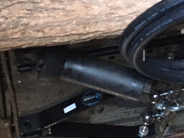

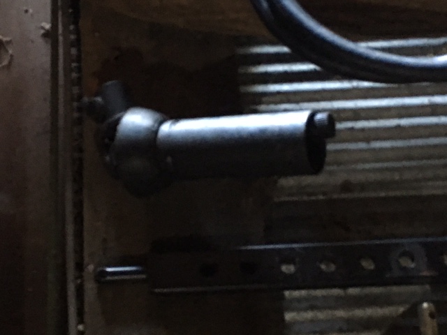

It's very dark in the barn but the implement side is much easier to see. The part that attaches to the PTO spline is hanging on the wall behind the tractors and there isn't much light.
/ PTO Shaft Coupler Question #5
I don't understand what part you need. You have both halves. One is on the implement and the other half is on the wall. The 2 pieces slide together.

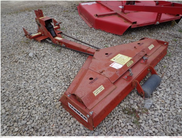

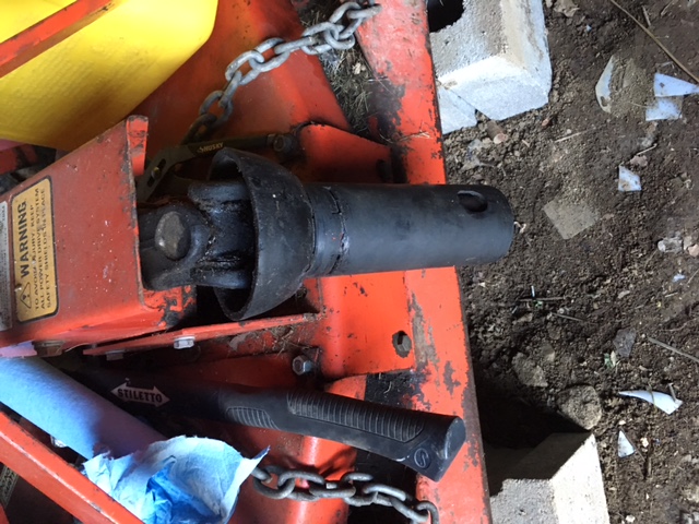

I have both halves for that implement, but not the one in question. Here is the picture of the belly mower with half the attachment on it but missing the other half..... I am trying to locate the other half and learn how to properly measure it.
/ PTO Shaft Coupler Question #7
Your Yanmar dealer should be able to look it up in his parts book. Its the Yanmar mid mount mower for your Yanmar tractor and would require the PTO shaft for that attachment. The new one should come with a push button or collar type release that will easily disconnect from the mid PTO so it stays with the implement. I'm not sure if your tractors mid mount PTO shaft is the same 6 spline as the rear PTO.
If you want to figure out the shaft length on your own you would have to hook remove the half on the attachment then hook the attachment up to the tractor and measure from the attachment to the PTO spline. I believe one of the links I posted makes custom length PTO shafts and they could help you out.

I will look in the manual for the YQM-48 belly mower to see if it lists the part number. Continental made the mower for Yanmar if the dealer is correct. It has the square instead of the splined shaft on the inside. The rear PTO has the six spline male shaft, and this belly mower does connect off the rear PTO. You can slightly see the shaft in question in this photo. One thing that struck me as strange is that in the front it simply hooks up to the frame with chains. Thank you for your assistance.
