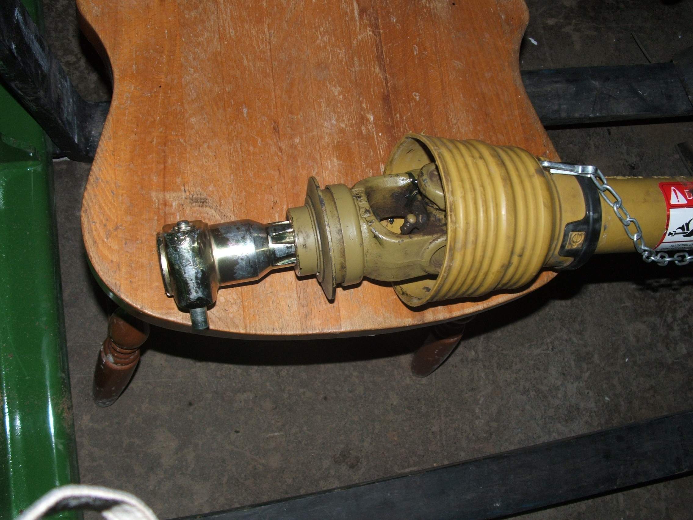

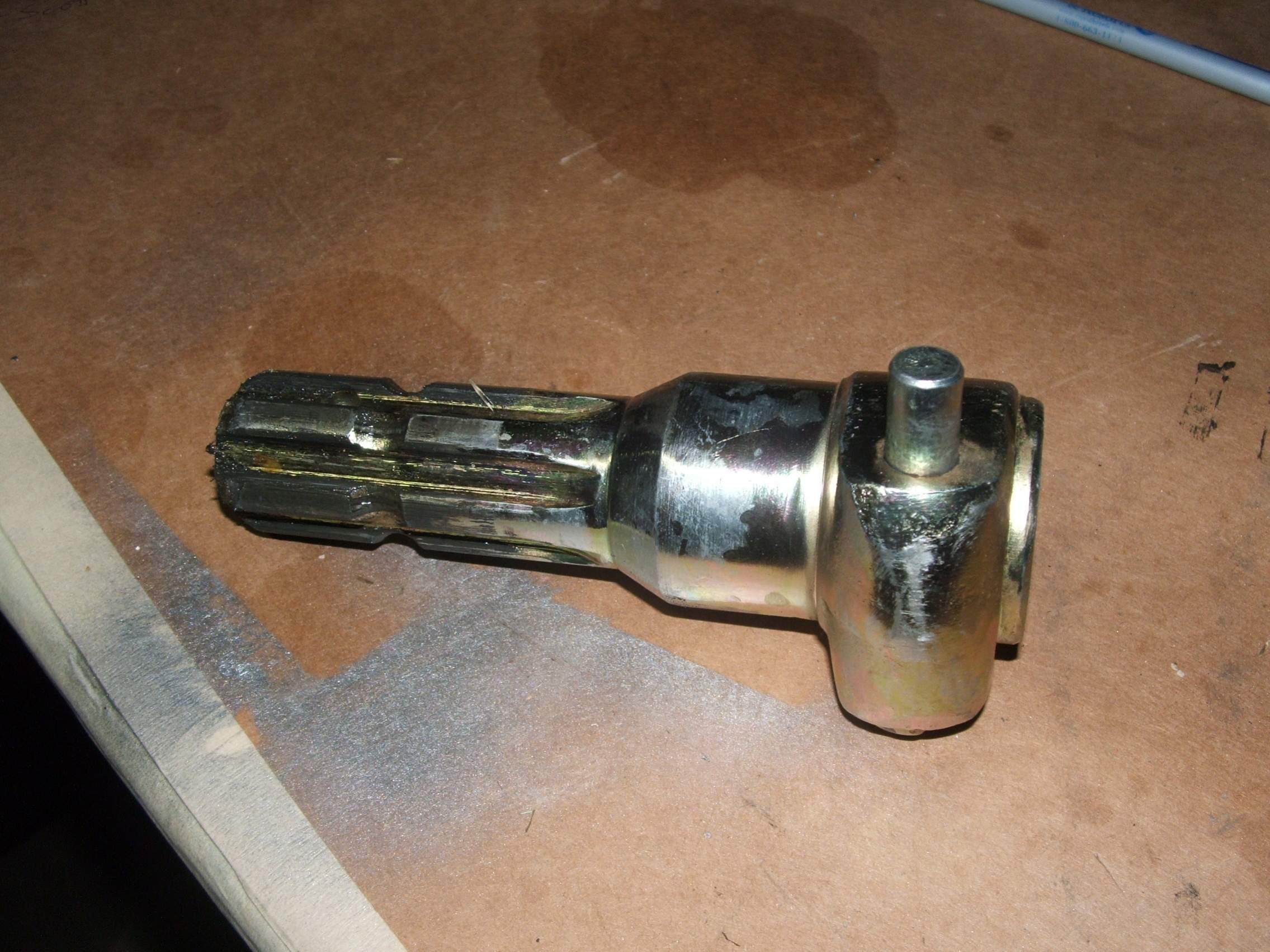

Took a few pics. for your info. What Roy say.

Thank you guys, that really helps.
The TRACTOR SUPPLY extension has the holes but no ring w/spring pin???? Maybe that is an additional part? If so, I'll return the 6' $249 shaft and buy the extension. Thanks again :)

Roy,
You're a life saver....THANKS.
I had already CALLED T.S. and asked them to HOLD one with the holes.
After your post I ORDERED the "pin" one from A.S.
Heartfelt thanks,
Rob
PS. It sure is easy to screw up learning this business
/ Pto shaft extension. #12
You don't like holes? What is the issue with holes...I assume a pin through it would work fine.
Tractor Supply sells the extenders with the holes. These were designed for an old Ford (IIRC) that did have a hole in the PTO stubshaft.
We don't want to be drilling holes in our tractors' PTO shafts, do we? First, it could weaken the shaft. Second, I imagine those shafts are casehardened and drilling would be difficult.
