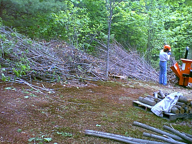

The Vably works well too. I love the hydraulic feed. If I'm working by my self, I can throw smaller limbs in the hopper and in they go! Here's a pic..

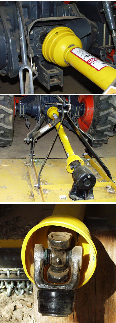

Jim -
I have the Howse rotary cutter, too. I have been following this thread very closely 'cuz I hadn't had a chance to use the cutter yet. Unfortunately, my tractor and cutter live over a hundred miles from me, so I had to wait until this weekend to see what y'all were talking about.
Now that I've actually seen it again, hooked it up and used it, I can only add the following questions:
What chains?
What eyes?
What ears?
What tabs?
My shaft cover is as smooth as a baby's bottom all the way around the end flanges. No sign of a chain nor any way to attach them if I had them. Like you say, the shield is free to rotate independently of the shaft, but I saw little choice but to let 'em both spin as much as they want.
I've attached picts of my setup. Am I missing something? Not all PTO shields are created equal?
   / PTO shaft Shielding #20
Yep, Harv, I think most of them have a little chain, and a place it's hooked into the shield on each end and you attach the other end of each chain to the implement or 3-point so the shield doesn't turn, but I, too, noticed that the Howse comes without the chains, or a place to hook them. As long as you check it periodically to see that it will turn easily, independently of the driveshaft, I don't see that it makes a big difference.
