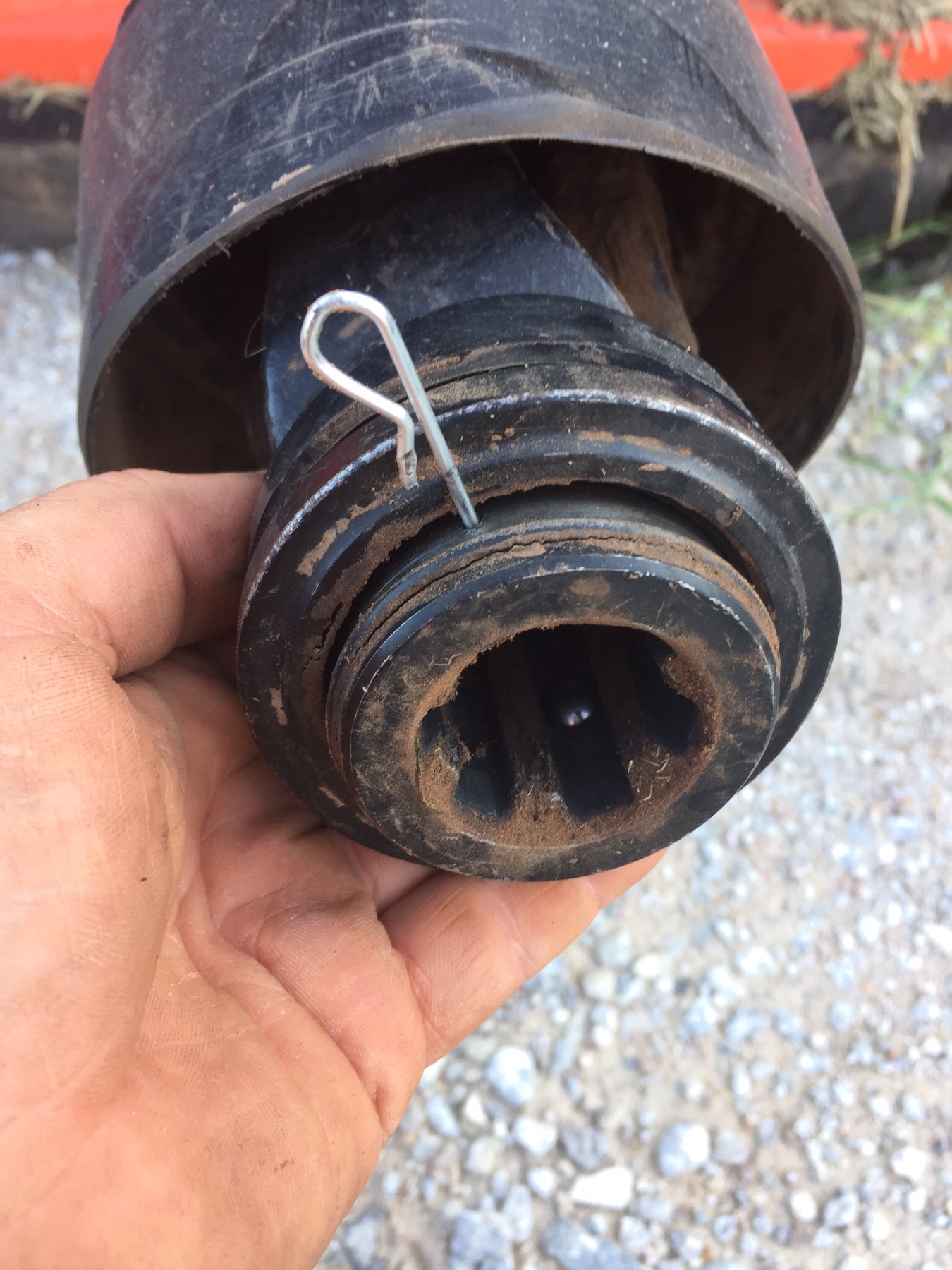

Sorry, I don't. 'Wish I had. I purchased it new directly from a generic farm machinery dealer who has since gone out of business and the label has worn off the safety sleeve covering the drive shaft.

Because when you end up using a LARGE pair of vise grips to push the button in you can hurt yourself.
You shouldn't use the vice grips if the shaft is spinning. I think there is a OSHA tag that warns against that.
