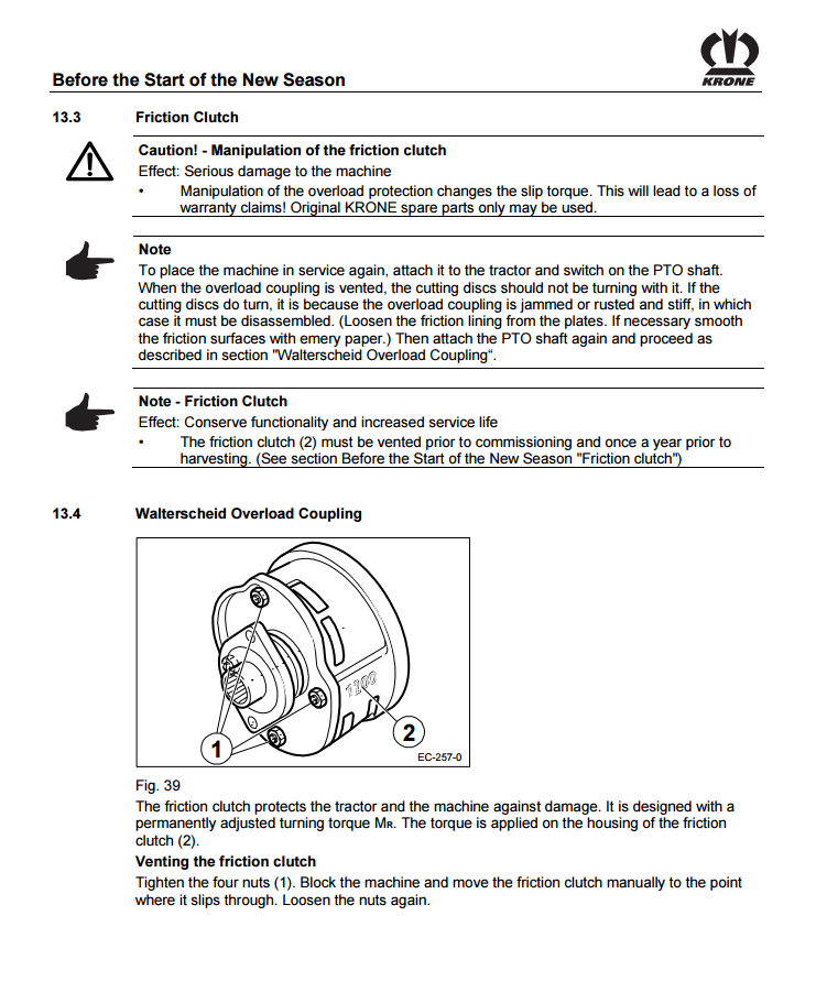

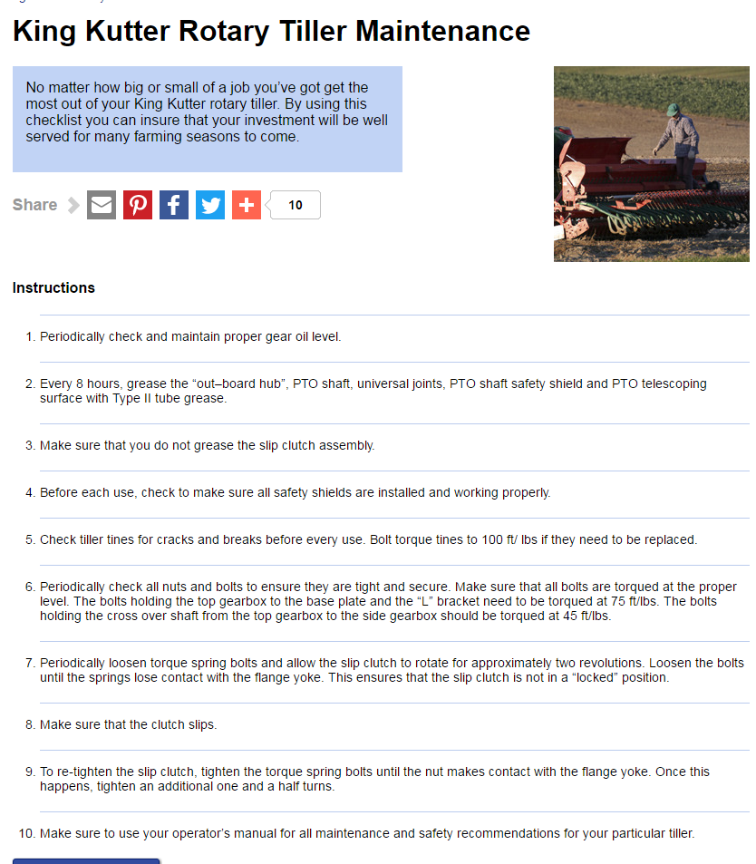

I think your KK ll tiller dealer gave you some inaccurate information. As for as I know ALL slip clutches should be checked to be sure they're not stuck at beginning of season. I looked online and could only find info on a KK ll tiller with exposed springs on slip clutch similar to my KK ll tiller. Please note steps 7 thru 9 in the posted KK ll rotary tiller maintenance. My Krone disc mower slip clutch has no exposed springs but has instructions in operators manual how to check to be sure plates aren't stuck. Read Krone operators manual slip clutch(Walerscheid) instructions below.
STx is actually correct, there are some slip clutches on the market primarily on smaller cut att that you have no ability to adjust/repair the clutch, some of them don't even offer repair items if it fails you buy the whole thing. I have been around a few and unless the unit gets abused they seem to work just fine, tillers seem to be one of the areas where we see them the most.
