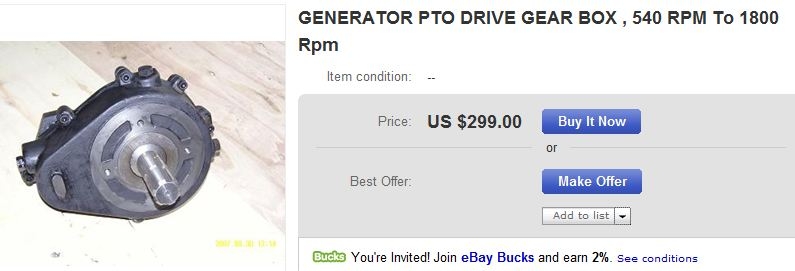

I have never found an inexpensive pto step up unit. If your tractor has 540 and 1000 you can try to run implements on the 1000 rpm shaft and throttling down to half speed for the correct implement speed but usually your engine will lug and not respond well. Some tractors will have a 540E mode which works nicely quite often. I have not seen a reasonably priced gearbox the replicates a 540E or 720 rpm at rated speed. I have seem several gearboxes to get 1800 or 3600 rpm from a 540 input.
Here is a 540 to 1800 unit;

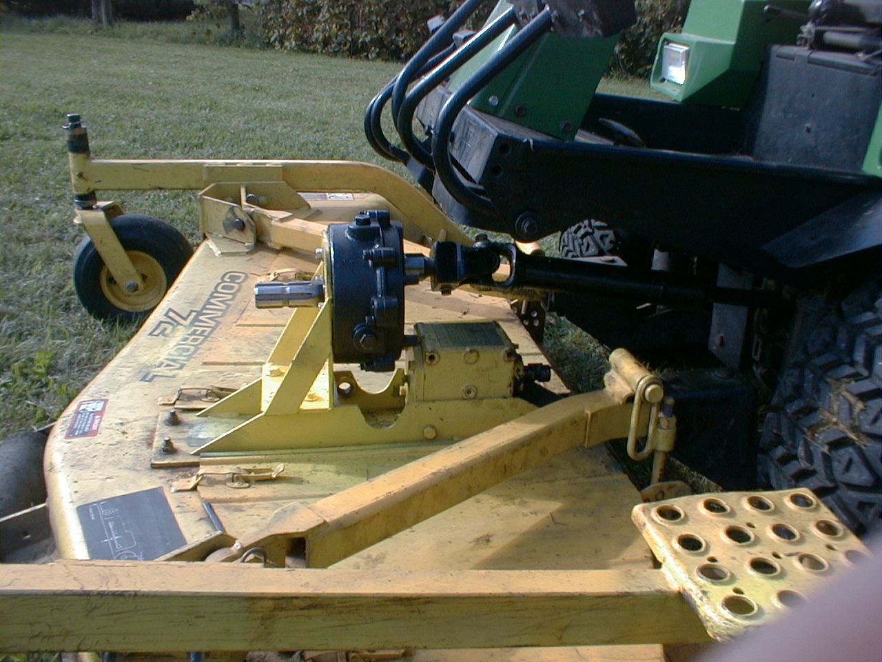

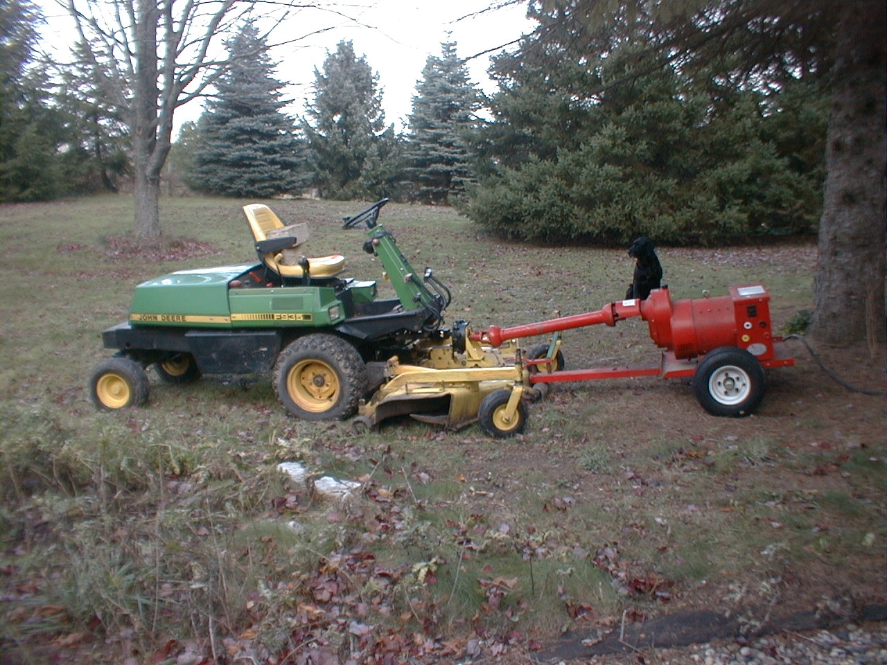

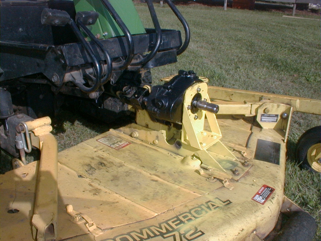

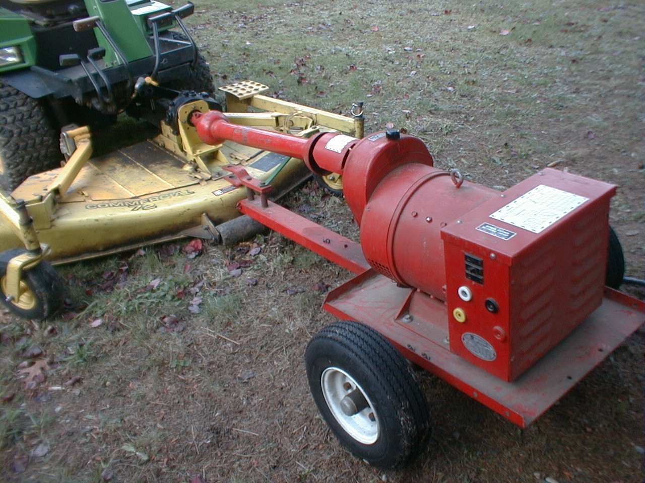

I use an Elomatic speed reducer (intended to INCREASE pto speed for pumps, compressors, generators, etc.) to operate my PTO genny off of my F935 2000 rpm mower drive pto. Yes, the genny runs backwards and there is redundant speed down and speed up in the system. It's good for 12kW which is plenty in my neck of the woods. I monitor Hz using a Kill-A-Watt. Governor does a good job maintaining rpm.
   / PTO Speed Increaser #12
Is that the deck you use for cutting grass? I don't see the gear box for the blade drive.
   / PTO Speed Increaser #13
It is. The reducer sits above the deck gearbox. The shaft is long enough to extend out to it. Because the input is coaxial to the 'tractor's pto, there is no phasing issue/problem as it remains in a C.V. configuration..
