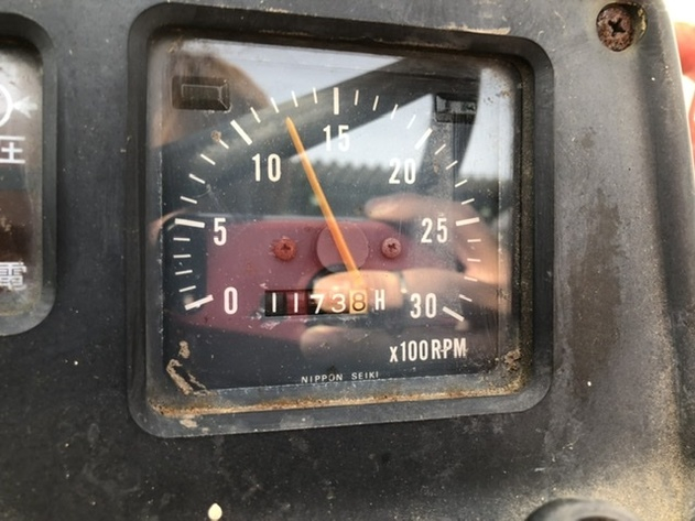

When I bought my Yanmar 2310 about 2015. It came with the Howse Bush Hog and the gent told me to use it in #2 PTO position, in second gear and at 2300 engine rpm's. I have followed that setting for the most part since day one. I don't know the PTO speeds of which there are four and if I run it in, say 3rd PTO and 3rd transmission gear at 2300 engine rpm's, will it destroy my bush hog gear's? I do 5 acres with several trees and would like to get it done a bit faster. Do I stay with the original settings? Thanks.

Pretty sure it is already overspeeding it in 2nd PTO Gear. IIRC, 1st is 540, 2nd is 750, 3rd is 1000, & 4th is 1500. Most US made stuff is 540 only. My Kubota B6100 is the same except missing the 3rd/1000 pto rpm speed. Only implement I got that is safe for all three speeds is the factory tiller for it.

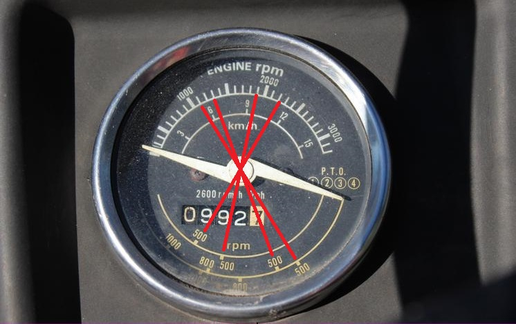

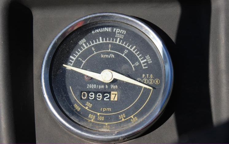

Lets look at the tach on the YM2310 for some clues.
Its the tach with no help for PTO use.
On other YM machines like the YM3110, the tach is robust with various levels of running 500 to 540 PTO rpms at various engine speeds and the multi-speed select PTO selected from 1, 2, 3, & 4.
Notice the PTO indicator with (1) (2) (3) (4). Then follow around till you find the 500rpm mark for each radius.
PTO (1) 500rpm charts to be 2200 engine rpm
PTO (2) 500rpm charts to be 1900 engine rpm
PTO (3) 500rpm charts to be 1300 engine rpm
PTO (4) 500rpm charts to be 1100 engine rpm
So, with the speed of the engine RPMs, the PTO speed can vary.
You are now asking, how can you chart this on a YM2310? Not easily via the tach.
Instead you need a Tachometer photo sensor hand held device. Using a dab of paint on one of the PTO spline teeth, paint it white. Next, with someone in the seat, operate the tractor in each PTO setting while adjust the engine speed to find either 500rpm or 540 rpm. Log this as your golden chart for hitting these PTO speeds.
WHY is this very important? With my YM2610, it has the same tach as the YM3110 and others. I run in PTO (2) about 480rpms with engine speed about 1600. This with the 3PT mower gives a great cut and best of all, it SAVES FUEL !!! The best of both worlds, less wear on the mower and to save fuel. This means more seat time and the hour meter runs slower!
This has been a long discussion on the Yanmar Tractor Owners Group. The community members have benefited with the discussions and fuel savings this year as prices are insanely high.
Now for you to go faster, once the PTO has been dialed in, you can pick the PTO selection and engine RPMs to match. Then with the PowerShift in the right band, you can move along nicely at a good clip. Hope this answers your questions.

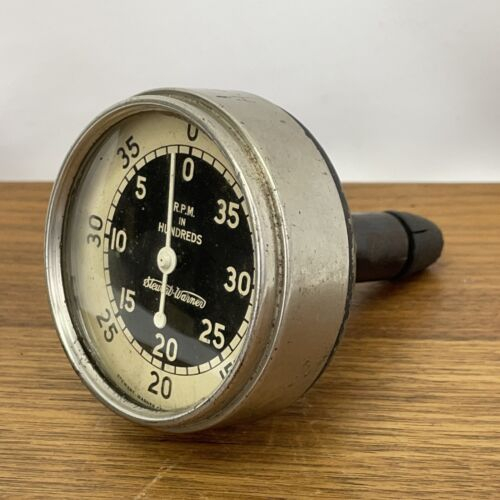

Never thought to test but just remembered I have one of these that will do the job.
yes it will and I have one as well, great little tool. I used it on the 1000 rpm PTO shaft on my Kubota to determine where the 1000 rpm shaft was spinning at 540 as I put a 21-6 spline adapter on the 1000 shaft to run my hay rake. More economical than running the 540 at rated rpm and I paint marked the tach face where it was at.
