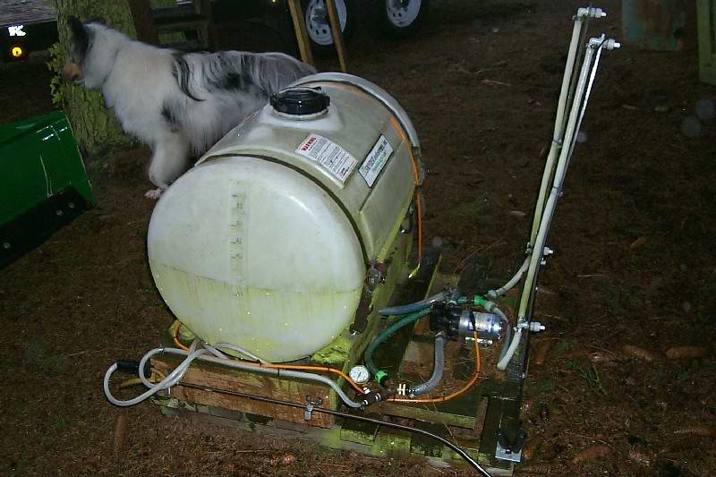

I sprayed 4 ac on sunday it works great. I wish I new how to post a photo on this board
I Would show you guys the sprayer.

Pat sent me this picture. I thought I would share it with everyone.
