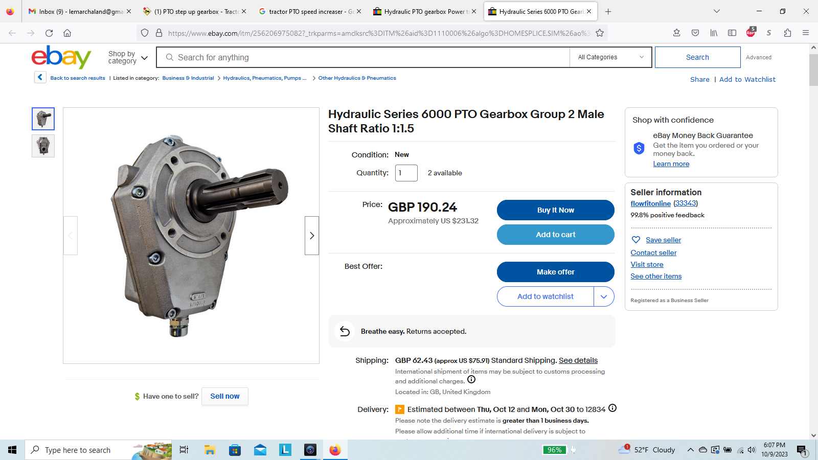

Here is a gearbox that would get you 810 rpm with a 540 rpm input.
This 1:1.5 gearbox should do this
2100 engine rpm = 540 pto rpm
1400 engine rpm = 540 pto rpm
I don't see a HP rating and it would take some fabrication to get the output shaft back to 1 3/8" 6 spline.
/ PTO step up gearbox #18
That one in particular is for a Group 2 Hydraulic pump and being that it's for hydraulic pumps and made out of aluminium, it has a lot let HP rating. Typically in the 13HP range. The other face of the multiplier has the correct 4 bolt mounting for the pump along with the female spline drive socket.
