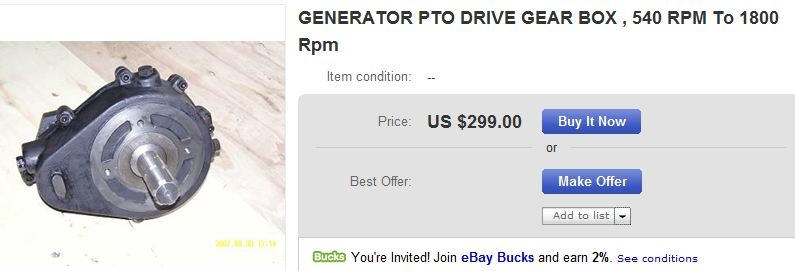

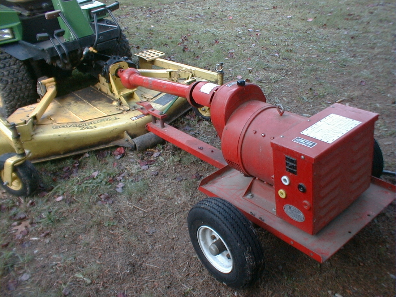

I bought this gearbox as a reducer to scale 2100 rpm down to 540 for running my PTO genny off my lawnmower. It goes both ways, so to speak...

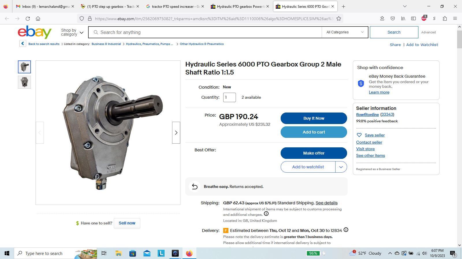

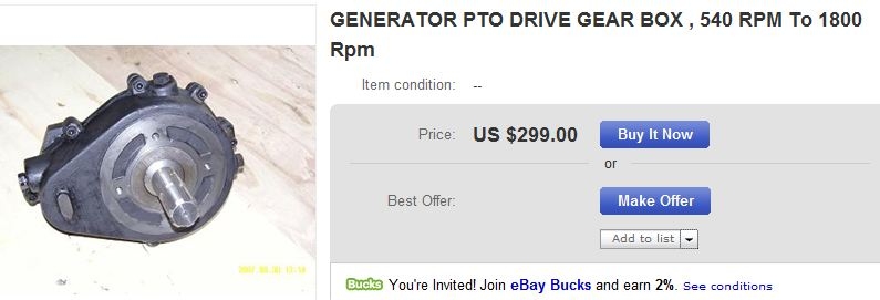

I run quite a few pto attachments that should run 540 RPM, but do not require much horsepower. My John Deere 5045e has to run 2100 engine RPM to run 540 at the PTO. Is there a step up gearbox available that would hook to the PTO and step up the speed so I could run in the 1500 RPM range and still have 540 pto RPM? Ratio should be about 1 to 1.4 or 1.5 if available. Any ideas.
Scroll down to the PTO speed increasers.
It would require PTO shaft modifications which might limit usefulness.
