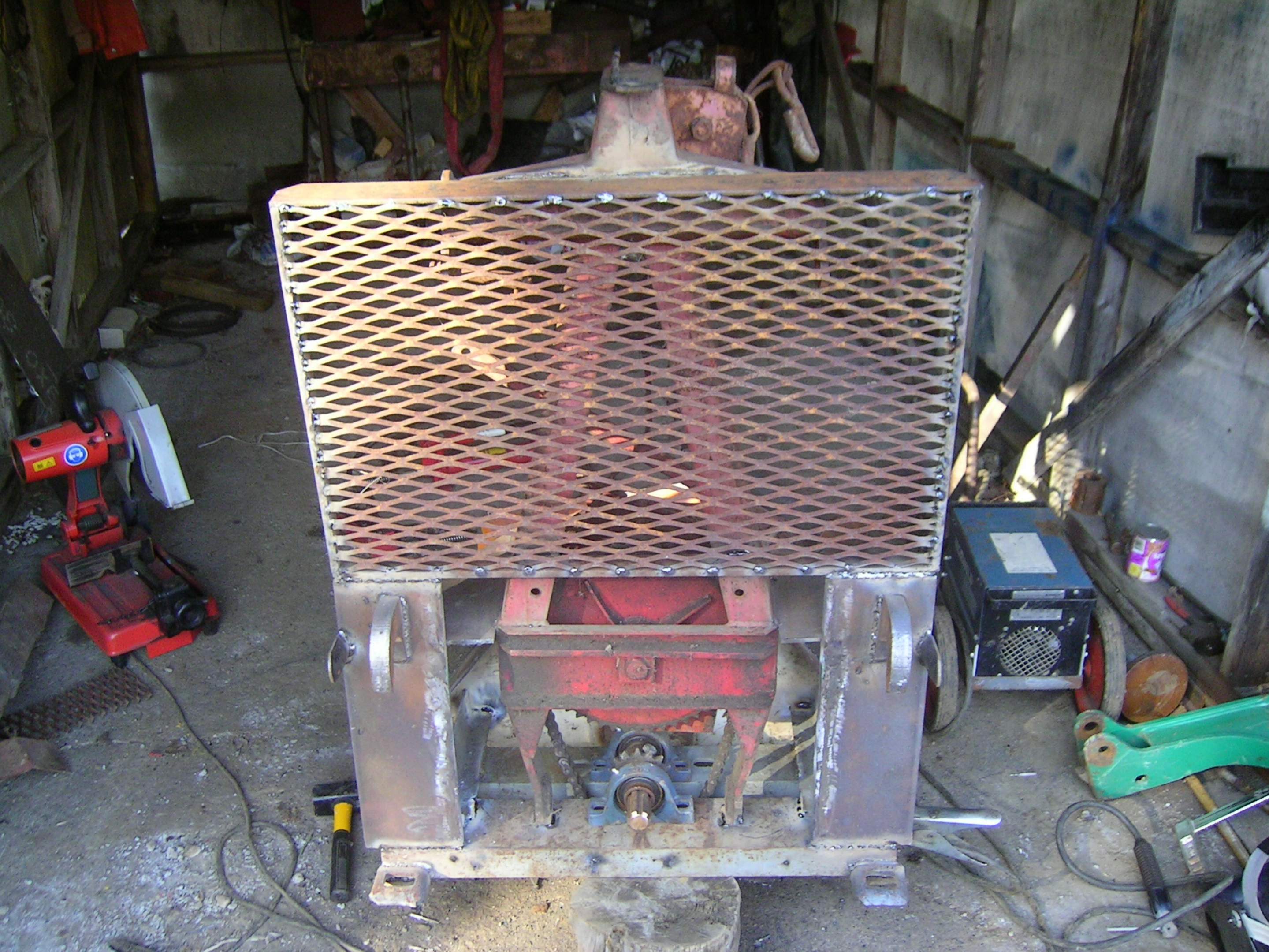

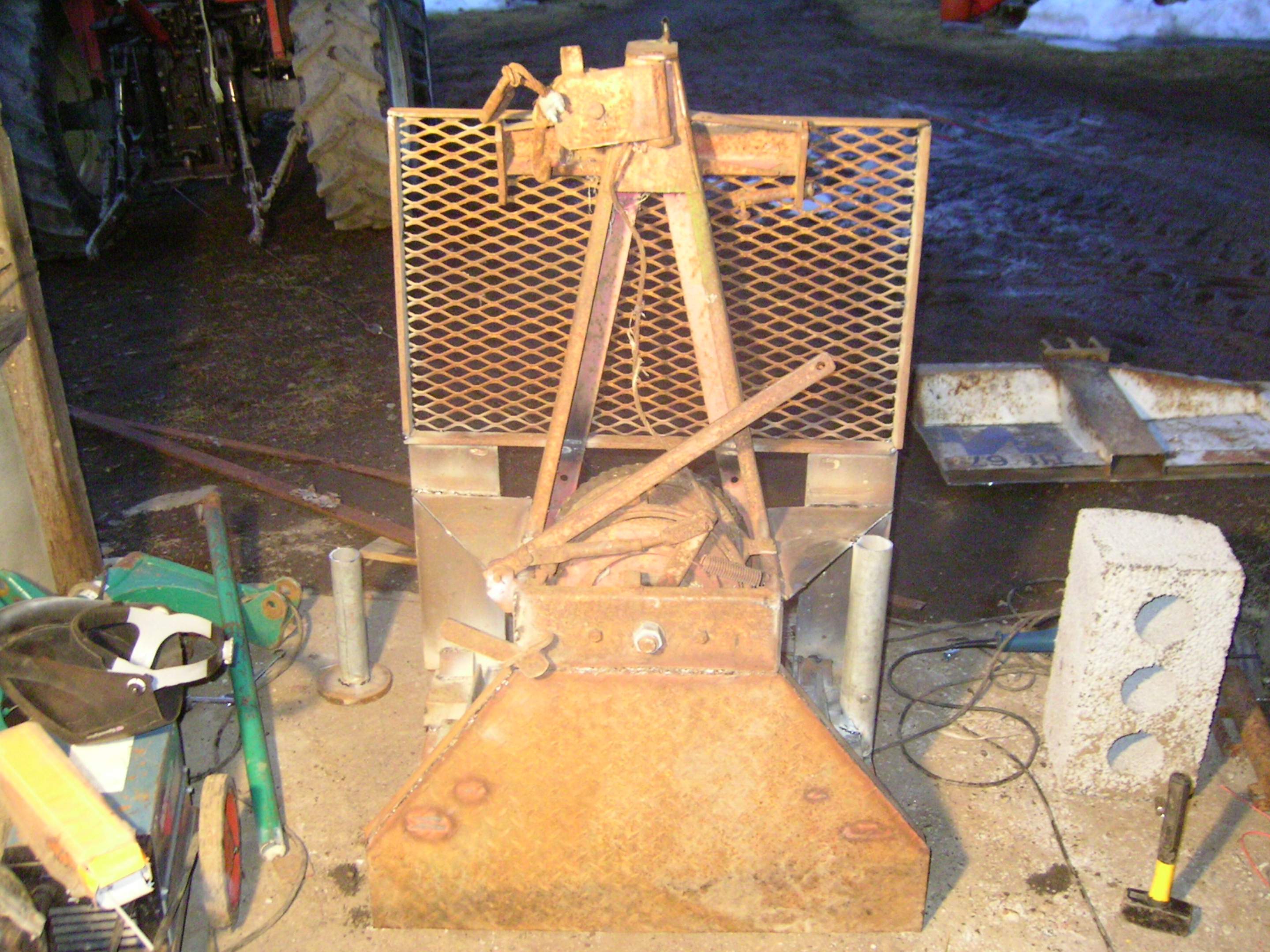

Here is one that I rebuilt from a fixed to a quick attachment. It is originally a Sandvik 3000 (3 ton) that I have welded expanded metal, 3 point mount and blade on. There's a brake so the wire can not free spol on the drum. It mostly consists of a spring-loaded flat iron that goes on the edge of the drum
