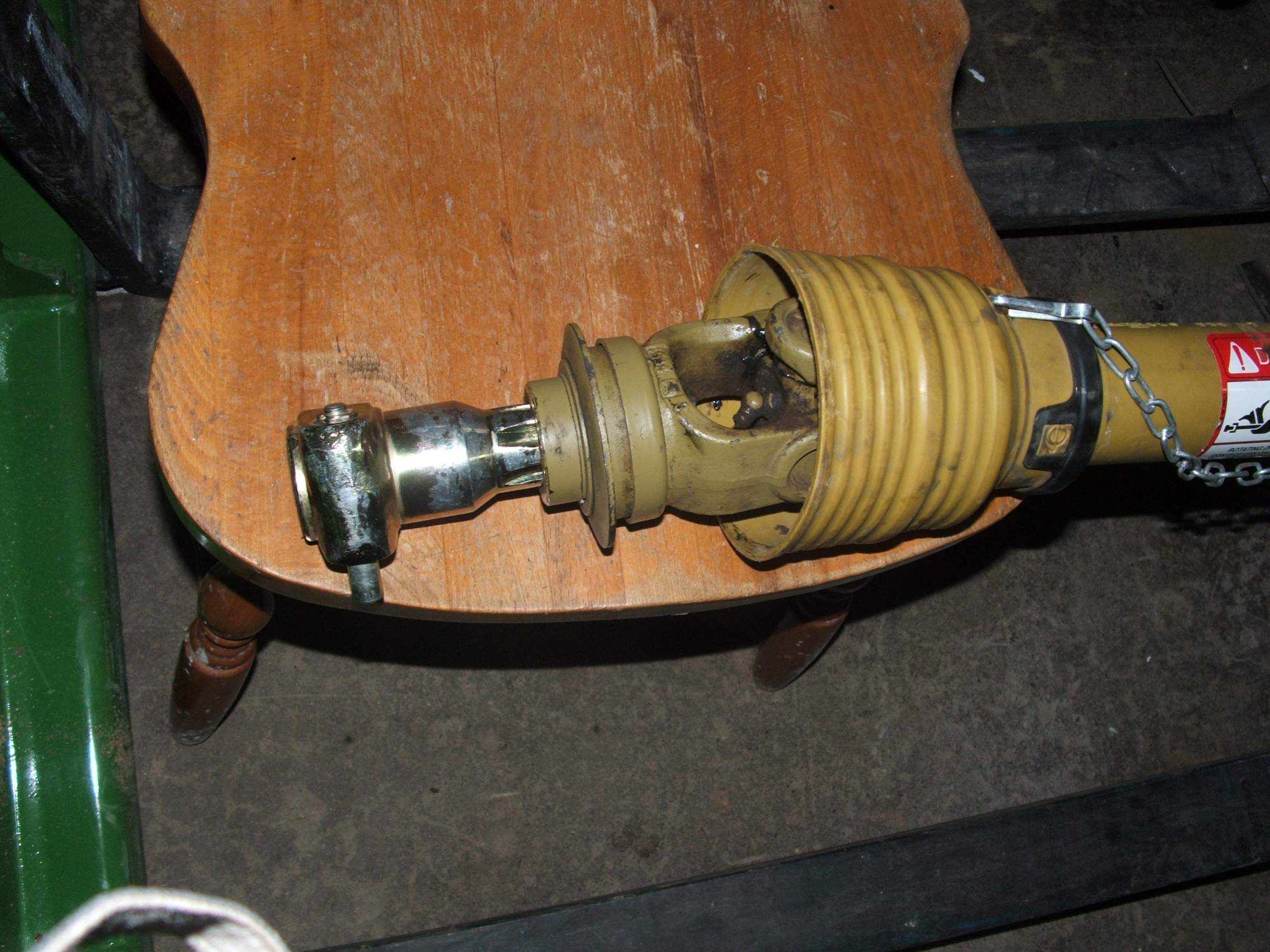

Pictures would help, but I think he has the plastic twist set-up like I have on my rotary cutter. I also have the pull metal ring on my tiller. I don't have a pics of the twist type but here's one of the pull ring with my extension push button style.
   / PTO yoke won't slide on #14
That's the kind of connector on my post hole digger. I figure they designed it that way so it will be less likely to grab a pants cuff.
