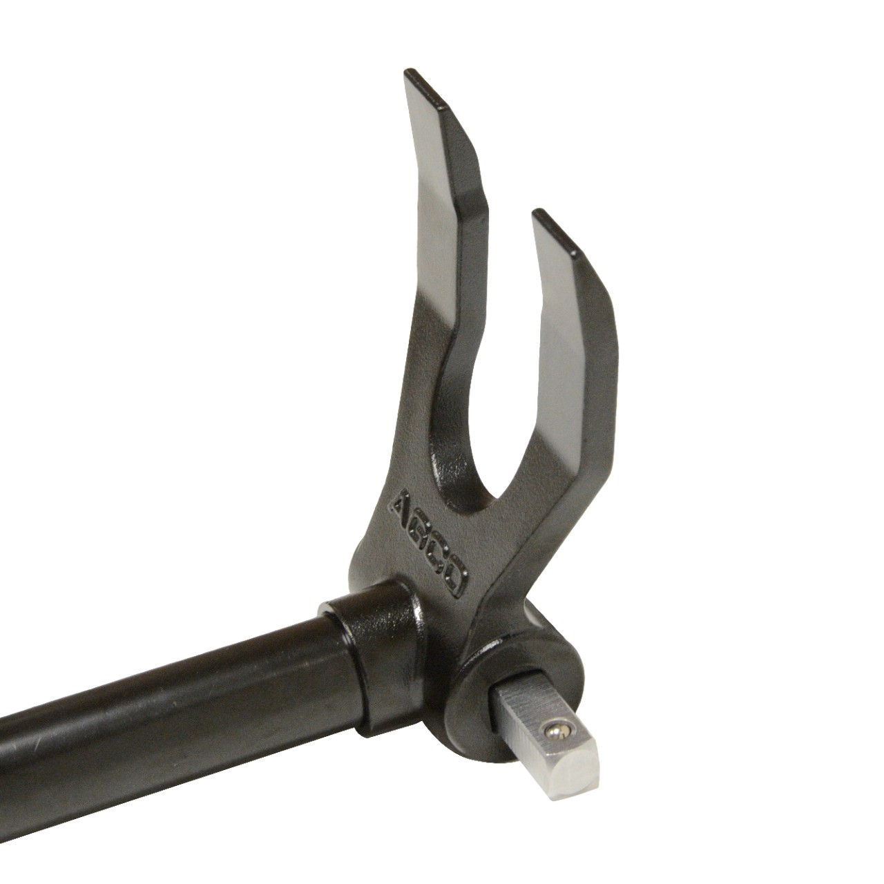

I've been thinking about making something like this to make it easier.
https://parts.agcocorp.com/gb/en/p/agco-parts-pto-removal-tool/acx4268620?text=ACX4268620

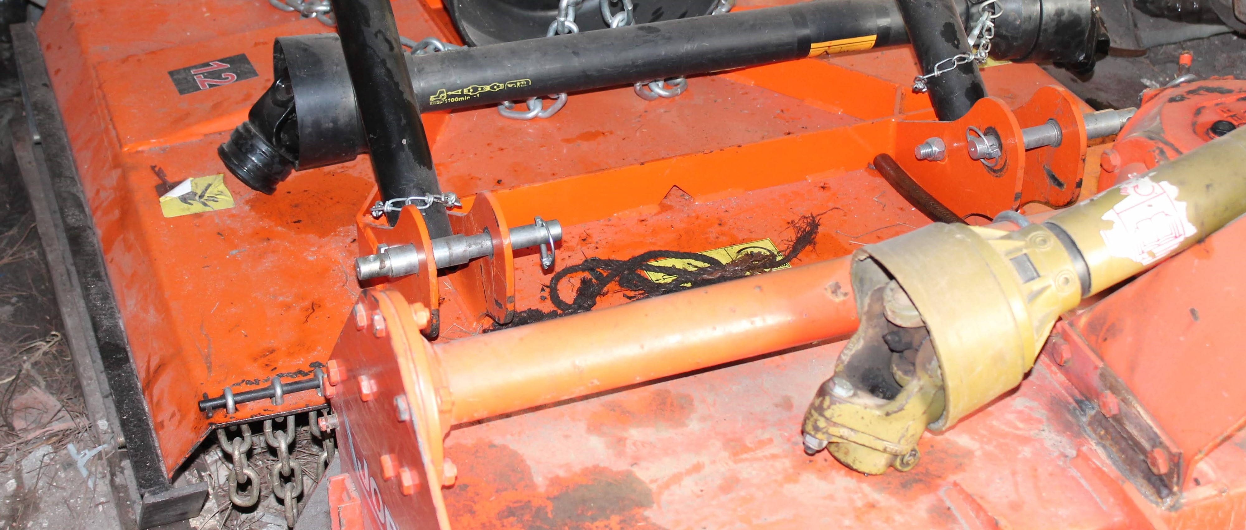

I can't say that I don't know how to deal with those lawyer induced guards... ;)
This is my new Woods 15.72 a couple months ago. I just cut that crap off. My tractor has a pivoting steel guard over the PTO shaft anyway, so no loss of safety by cutting that plastic off.
I did keep the shaft guards in place, and the cutter itself has pivoting steel guards over the U-joint areas.
If you look at the photo, you can clearly see that even after dealer prep, all 3 of those grease fittings were not even touched by a grease gun. I know why... They couldn't get to them! That's not an issue anymore.

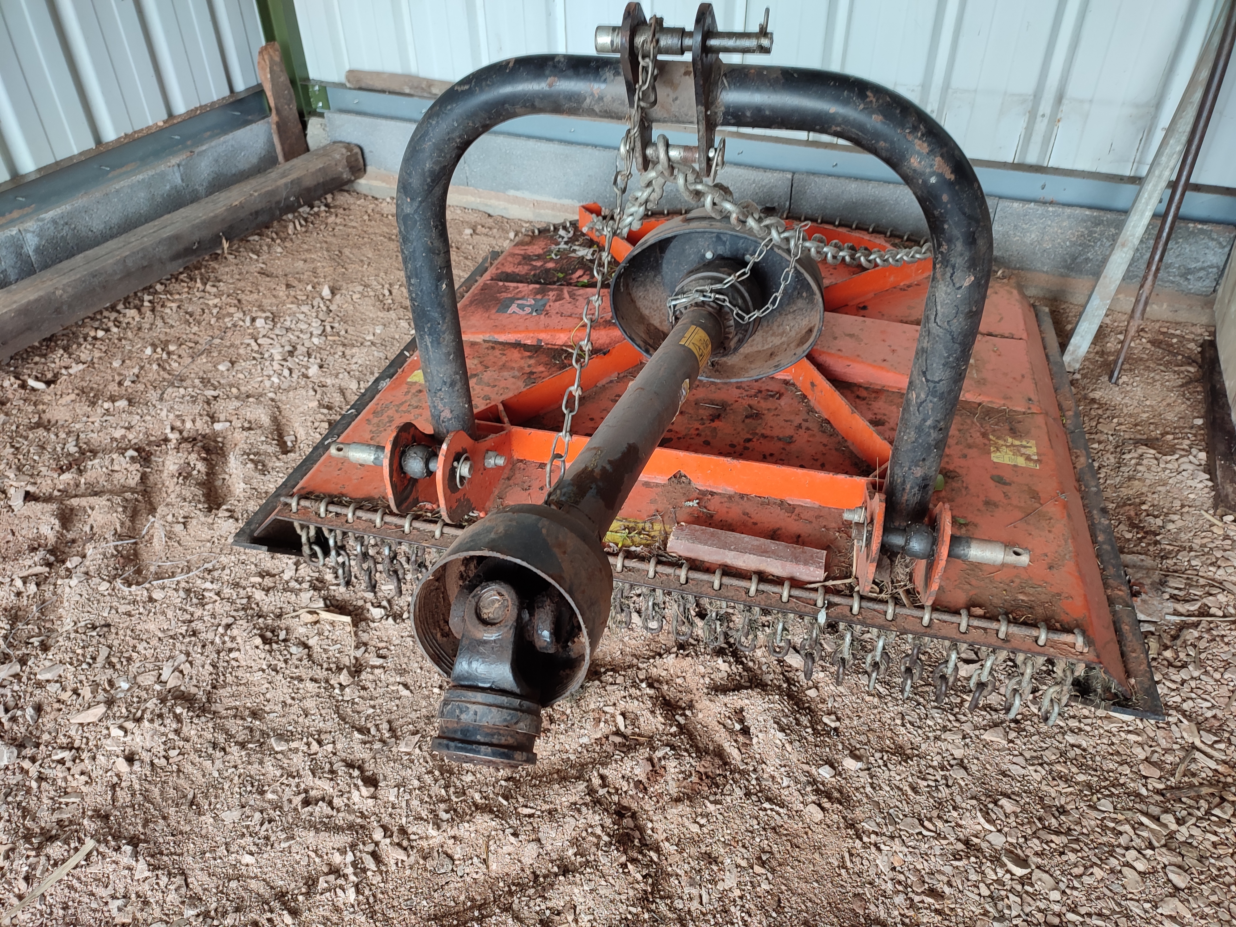

Are the PTO shaft guards really that intrusive in the US market?
I've never had any issues with the ones that came on my brush cutter and tiller, but comparing pictures, the ones I have do seem to stop shorter and seem to have a smaller diameter as well. Either one have not been cut.
Even the shield or guard on the brush cutter gearbox is wide and offers plenty of room to work on the PTO shaft. Even has removable panel on top that I use when swapping the shear bolt. Don't even have to pull the shaft out.
