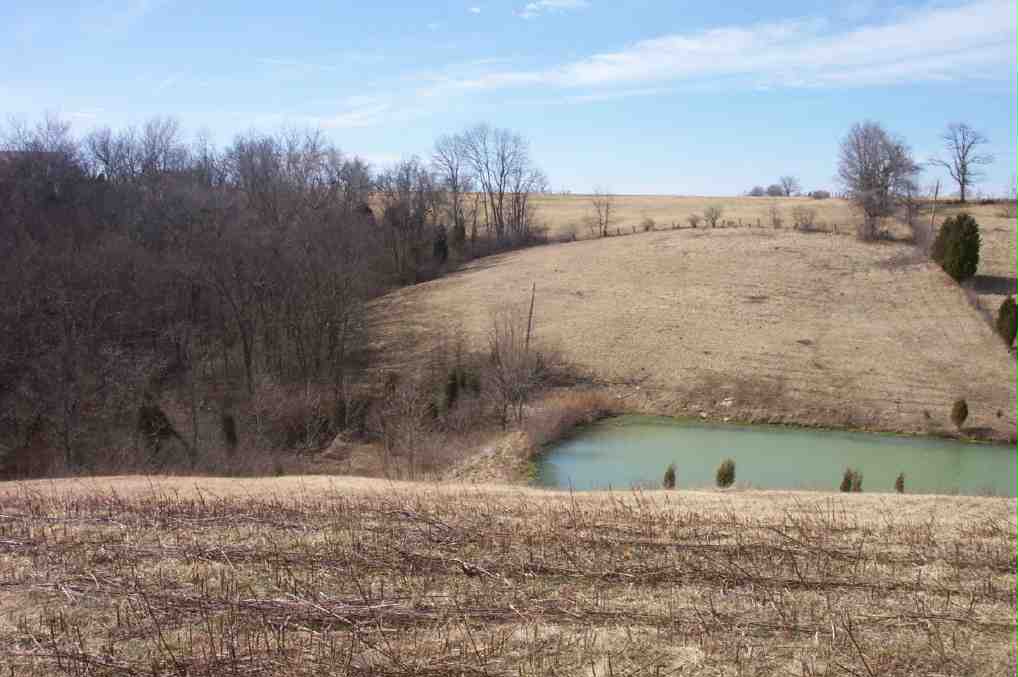

I have been lurking the net for months now, looking for recommendations and advice on tractors and have found this site to be awesome. Thanks to the administrators and folks who work behind the seen providing this service, as well as, those who take the time to answer the questions.
Pucker Factor Rating?
I have been trying to decide on exactly what type of tractor to buy in order to bush hog my property, safely. Being new at this, I am proceeding with caution. I have read many of the threads but still worry about the “pucker” factor. After viewing the attached picture, on a scale of 1 to 10 (with 10 being the worst case) how steep would you rate these hills and/or what tractor would you feel the safest in driving up & down this slope? I don’t know the actual slope angle but can say I’ve been stuck twice climbing the closest hill with a 2WD ATV.
I am thinking of going with the Kubota L3430 or the L3830, HST, AG tires weighted and extended. Two local dealers are extremely helpful with one even offering to bring the tractors to the farm to see how well they do on the hills. Some who have seen the farm say these hills are nothing, but to me they seem pretty steep. Guess some seat time will tell.

I think the larger one has a wider stance for more stability and you would be easily able to go to a 72" bush hog. Some one has been mowing it and going across which is harder to hold on hills then going up and down.
   / Pucker Factor Rating? #3
Ron,
You can take some of the guesswork out of this with a quick trip to the hardware store to purchase a $5 contractors protractor level. When measuring your slopes, use a piece of plywood, say a foot square, as a base for the level. After you have determined the steepest slopes and approximately where they are located you will be able to make some rational decisions about the tractor.
Most compacts with attached loaders or mowers and with the wheels set as wide as practical can handle general slopes of up to 15 degrees sideways when operated in 4WD. They can usually do a little more in 4WD going straight up or down.
Go for the widest stance tractor that is practical for you.
The field in the photo you show has obviously been mowed with some kind of tractor and mower. Maybe it was a full-sized agricultural tractor with the wheels set quite wide.
Let us know what kind of slopes you measure if you choose to take the recommendation.

Ron,
I am pretty comfortable going across 15 degree slopes, I do mow up to about 20 degrees. As far as going up and down, I do a lot of 30 degree slopes. Anything over those amounts my pucker is working pretty hard. I might add for safety, the angle of a tractor can change real fast if you hit a rock, stump, log and drop in to a hole. The areas that I am referring to, I have mowed dozens of times and know for sure what is there.

I do what most would call extreme mowing on the pipeline. Up and down hills that you can hardly walk on. the thing is, do not get sideways and have your tractor spread as side as it will go. Keep all attachments as low as you can, especially loaders. When mowing downhill be sure to have 4 wheel ingaged. If you don't have 4wd donot attempt to nose over a hill, you will have no brakes as the weight of the tractor will be on the frontend and it will get away from you. I generally mow downhill as sometimes the sticker bushes are well over 12 ft high and I am blind going down through them. I just take it easy, and feel my way down, backing out is not usually a problem as the bucket will push me back when I need a little help. I have a belly pan under the entire lingth of the tractor to protect plumbing and linkages and a winch in the loader, just in case. I am using a 5300 Jd at this time with a bush hog 6ft. I would recommend that what ever mower you buy that you reinforce the shroud if you have any tough going. Have fun

If I see the angle correctly in the picture I would give that a P factor of 8.5 - Looks like a good hill to sled on though. /forums/images/graemlins/cool.gif
   / Pucker Factor Rating? #7
Looks like the little pond will break any falls you might have! but ya good pucker factor !

Ron, I have hills all around my place and use a L3830HST. I mow in all directions but must be extra cautious on only one (besides around the pond). The tractor actually slips down the hill most of the time. I am always ready to turn the wheel in the event the tractor gets to light on the uphill side and have never had any of the wheels leave the ground. My older International 454 saddle tractor feels incredibly secure yet even it slides down the hill depending on grass conditions. I do not have my L3830 ballasted in the tires and don't feel the need. I should measure the slope on my hill to give you an accurate rating of what it is I'm working on, perhaps a picture tommorrow with my new digital camera is in order.

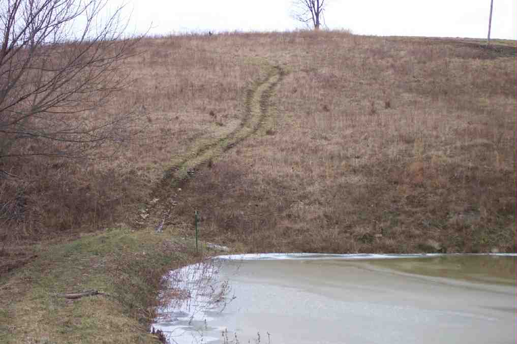

I’ve taken JackIL’s advice and took some measurements this morning and found the slopes to be an average of 20 degrees on both sides of the pond. (The temperature was 9 degrees with the wind chill factor so I didn’t stay very long.) The steepest I was able to measure was on the far side of the dam, close to the pond, which measured 30 degrees.
While walking the hills I noticed where some erosion had occurred where we ran some ATV’s over the summer. Including the ruts would quickly worsen my measurements as JerryG had warned. (See newly attached photo).
MossRoad - I have requested info from Power Trac and that might be my best option. I like the low center of gravity and width.
I guess I am looking for some reassurance that these hills can indeed be safely cut with a Compact Utility Tractor. It sounds as if the CUT tractor may be borderline. Maybe a larger utility tractor is needed or a special like the Power Trac is the way to go. I’m still undecided since I don’t want to wind up upside down in the pond.
