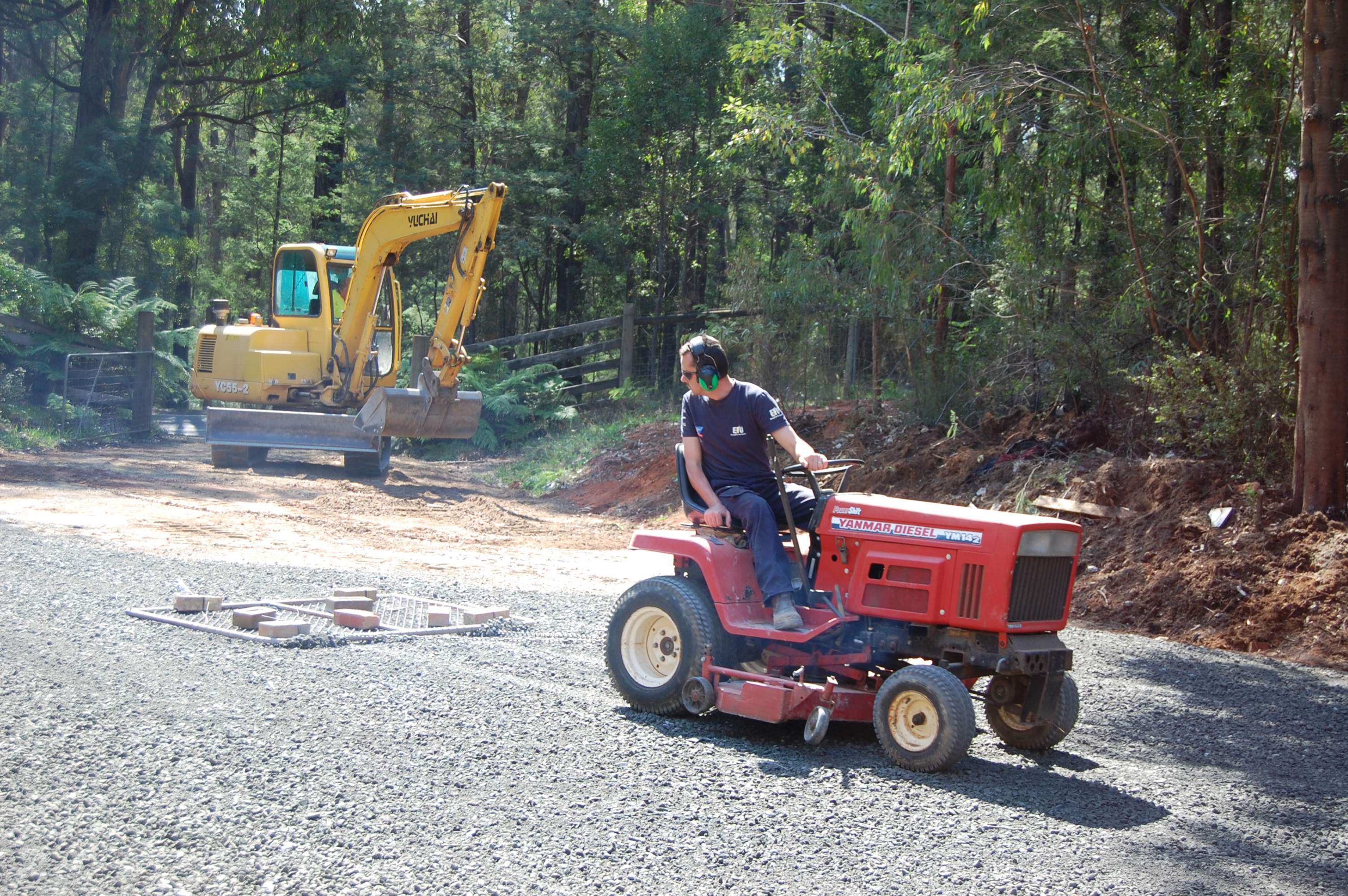

i drag this old cyclone wire gate behind the YM14 and it usually picks up the large rocks,sticks etc and leave them on the gate but the smaller stuff behind. it levels out well, breaks up horse dung and the likes.
