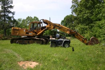

Here's a few pictures. I'm using Microsof Picture Manager to play with the size. Hopefully this posts fine....
This is the Liebherr Trackhoe. Not pretty, but it works....

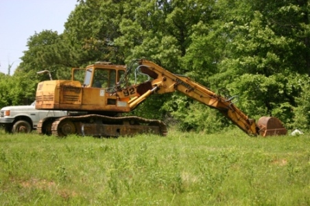

Another of the trackhoe for perspective. The 4 wheeler is a Honda 500 Rubicon.
