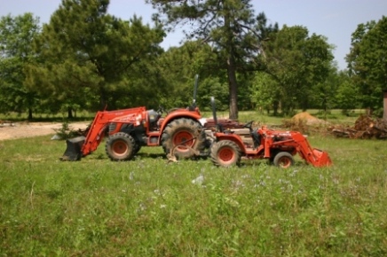

The tractors. Maybe they won't be used much. :)

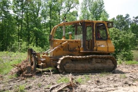

The dozer...

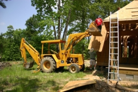

The backhoe. It's being used as a carry all/scaffolding to build a house at the moment.

The dozer you have, by the way, appears to be a Komatsu D-41.
The question of weight or power that's limiting you, it is more the weight issue. A 6 yd unit is a pretty good sized piece of iron for a 55hp tractor, but that hp might work it if it had more weight and traction to it. You would have a case right now of "the tail wagging the dog" if you tried to do to much with the set-up you were describing as the scraper would dictate to the tractor and not the other way around.
However, the D-41 would be perfect for this 6 yard scraper if you've got the hydraulic set-up for it.
Most tank building/cleaning around here is done with a dozer anyway, so maybe those evenings after work would be better spent plugging away with the Komatsu rather than trying a whole new rig which is unlikely to work.

You're good with the Dozer identification. /forums/images/graemlins/laugh.gif I found out that the dozer is a D-41A. Not sure how A is different than non A?? It also has the rear hydraulics, so it would seem to be a perfect fit.
Knowing what I know now, we could buy the used 6 yard scraper and it could be pulled with the dozer. Of course, I would hook it up behind my tractor to see what it would do..... Gotta push those limits sometimes....
