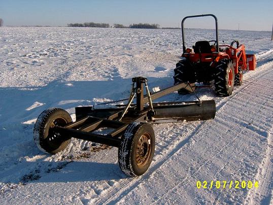

Finally got the grader done. Still needs to be painted and I have to pour the concrete block (800 - 1000 lbs) to put on the back. I think I'll wait for warmer weather.

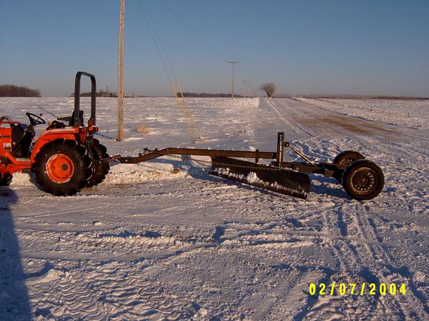

Another view.

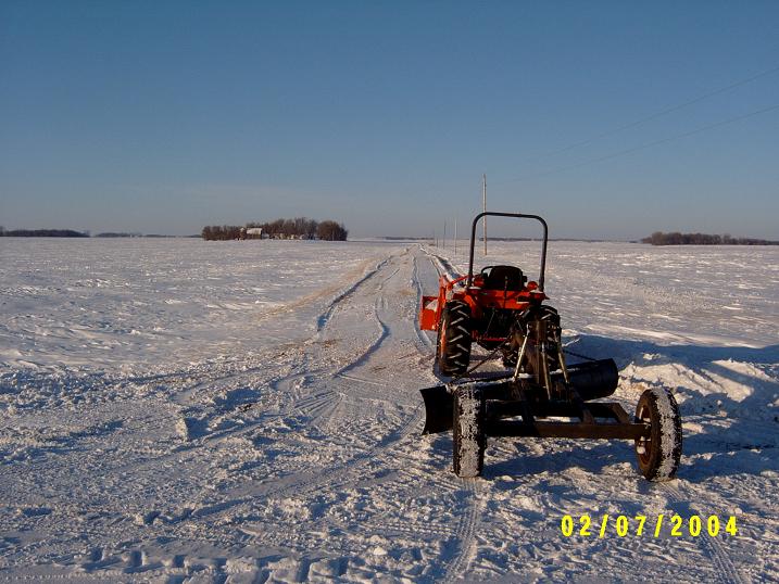

And another.

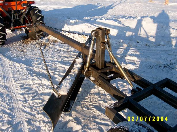

Last one. This shows how I use top links for fine adjustment. I use the three point to raise and lower it.

Bob, the project looks great! Did I miss this one while it was in progress, or is this the first time you have mentioned it here. I'd love to see some of the pictures of the project as it was being built.

I had posted a while back asking everyone for ideas. I didn't take any pictures while it was in progress. Always meant to, but always forgot the camera. You know how that goes.

Nice job, looks like it will work very well! I really like the simplicity of the grader. Now I need to get busy on mine.

Great looking machine! Do you have a pivot pin so the blade can be adjusted up/down with the side adjusters? I couldn't see it in the pics.
And if you can post a pic of how you attached the blade to the structure please?
Thanks!
