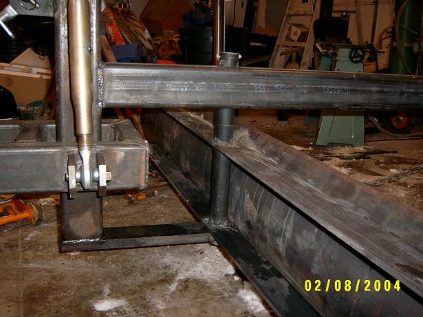

We asked for more pics and clarification.......we got it!!!
Great job Bob /forums/images/graemlins/grin.gif

Bob,
Great project!
There's no substitute for a long wheelbase when it comes to leveling and grading. I am going to buy a back blade, and have been trying to figure a way to increase the effective wheelbase. Following the whoop-de-doo's up and down don't accomplish much!

Hey Bob....Just curious if you are around the Zumbrota...Pine Island area. I have family there and your property looks alot like theirs.
I really like that blade. It looks well built.

   / Pull-Type Road Grader #26
</font><font color="blue" class="small">( Finally got the grader done. Still needs to be painted and I have to pour the concrete block (800 - 1000 lbs) to put on the back. I think I'll wait for warmer weather. )</font> <font color="red"> What are the wheels from? </font>
