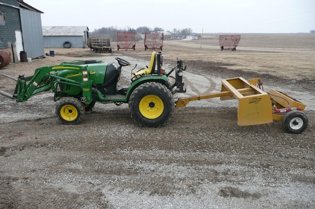

I agree, 20 hp is not enough. You need a tractor that is somewhat heavy to have decent traction. 20 horsepower might be enough, but that size tractor will not be heavy enough, that scraper will pull hard!!! I have a 6' box scraper pictured below and I can stop my 2520 at will if I want to.
