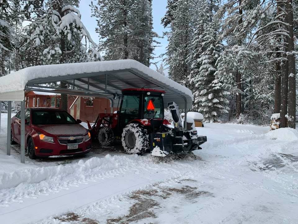

Inverted blower for areas that don't have to deal with drifting, is very efficient and fast as displayed by airbiscuits video. I've got a 35.9PTO hp TYM T474 with a 68'' MK Martin Meteor, and I LOVE this setup.
